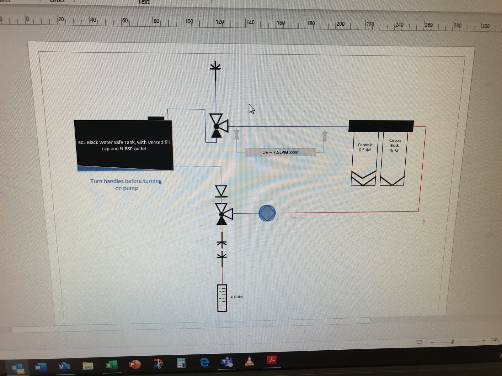

We are looking at installing a 65 liter tank that will run to a sink and also a separate tap of some sort at the rear of the truck. The system will be a double circuit allowing for(i) new water to be cleaned before getting to the tank and (ii) water from the tank to go through the same filter system again before reaching the tap for consumption. The choice of circuit is all controlled by simple manual ball valves.
So the basics of the circuit will be in this order - the water inflow to a ceramic /sediment filter, then to the activated charcoal, then to the pump, then the UV and from there into the tank. So the water stored in the tank is already clean and pure. Then with a switch of the ball valves the flow would now be from tank back through all the filters, pump and UV to the tap.

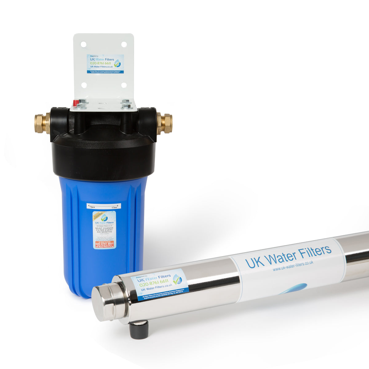

I have a twin filter system currently (5um and 0.5um, will be swapping 0.5 for 0.2) and i am about to add a UV in preparation, hopefully, for borders reopening next year to allow travel. I have a tank and 12v pump which allows for abstraction and dispensing.
I spoke to a few guys at the overland show and quite a few were running UV without issue.
