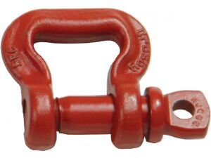

Took these pics up at Loch Lomond a couple of years back. If you look close you will see the bow shackles being used 'both ways round. OK, this is not a snatch recovery and the weight is spread over 4 shackles but is there a right way and a wrong way round? Don't know what the boat weighed but a sight heavier then a LC no doubt. Couldn't get close enough to see what the shackles were rated at but they were about 8 inches long.
Yes, but they are straps both ends so it doesn't matter. If one end was a hook, I would not put it on the pin. Two straps and you're laughing. I wonder about getting Damar to make me a simple and very short strap that will take a hook nicely in one end but go onto a shackle at the other - an stitched eye and a plain eye in other words. With my new attachment though on the end of my rope, I have done away with the hook altogether. Still handy to have though.

I have to agree with a point already made, that the first option if at all possible is to fix recovery points to both chassis rails, and use a bridle. If there is a change of being bogged down in mud, then get the bridle on first. I really do not like (or trust) bumper mounted recovery points for kinetic.
I'm not convinced that my winch hook would cause damage to a 20mm+ Bow shackle pin whilst in use as the inside face of my winch hook is flat and without measuring it I would guess almost an inch across. I'd be surprised if it were to bend a shackle pin over that length! I think that your more likely to damage the strop when under load if both eyes were crammed into the pin end of a shackle and not the bow. If doing a single line pull to a tree strop I would 9/10 connect my winch hook directly to the strop eyes without a shackle, so this problem would not arise. If doing a double line pull I'd have a snatch block attached to the tree strop via a shackle, but I'd still favor putting the strop ends into the bow of the shackle and the shackle pin through the snatch block :think:
As said already by others and I can concur that in all my years off roading thus far I've also never seen or even heard of a shackle failure or for that matter damage caused to one due to the way its been rigged. I've had them go really, really tight following a recovery and needing a good bit of grunt to get undone even after backing them off a turn or two when rigging them up, but no real damage ever.
In these photos here you can see we have a winch hook rigged a couple of ways, but the one with the winch hook on the Bow shackle pin the hook pretty much fills the gap.
Here's another example of how I've rigged a snatch block to a strop with a bow shackle and a safety strop with a clevis chain to take up the slack as we winched.
It's just what was required at the time to get the job done and if we had damaged any of the kit in the process then it would have been repaired or binned and replaced. It's not as though any of the kit we are talking about is hugely expensive.
Here's another photo of how I rigged a small change of direction using a tree strop, Bow shackle and a snatch block. Again with the strop ends in the Bow of the shackle as I feel this gives the strop the best chance of doing the job without damage.
This is of course just what I feel works best for me and when it doesn't I guess I'll look at other options, but until that time I'm still happy to connect my winch hook to a Bow shackle pin.
All this said of course I may well look at making up one or two of these for connecting my snatch blocks to a shackle pin in the future, but if I don't I'm still happy for now to connect them up straight to the pin :icon-smile:
I scrapped a shackle last weekend Steve. That's what the point of the post was. It was a smaller shackle yes, but one still big enough for the job. There may be ways and then they may simply be better ways. That's what I am saying. But seldom do I see much evidence of thinking when I see people setting lines.

Right, I am only going to say this. I am a LANTRA winch trained and a Lorry mounted crane trained. I could tell you have I do it, but there is no right way to use the shekels, both lots of training show you it in both ways. But a D shekel should be only used 1 to 1. Also the hook goes one way for pulling and the other way for lifting.
And I used to be a crane driver Paul. But this isn't about there being a right and wrong way in relation to SAFETY which is what lifting and slinging courses are about this is to do with the practicalities of looking after tackle when it matters. I could put a hitch in a rope over a load that you'd have to cut open with a knife. It would be very safe in terms of securing the load but you'd get through a new rope every time. My point here was that if you spread the load along the pin by putting the strap at that end leaving the bow free for the hook or whatever, there is less damage and possible distortion to the pin. Less jiggling on the threads etc etc. So right and wrong way no, but better way? I think so. The bow in the shackle means that the hook should centre itself. Whereas if you put the hook on the pin, it slides back and forth and usually ends up in one corner where it can start to bend the shackle outwards. Remember that we don't do the pins up tight. I've never had a problem but I have always done it this way around. The thread was prompted by someone else rigging my line and it damaging a shackle to the point I couldn't get the b*st*rd apart. It's in the bin now.
