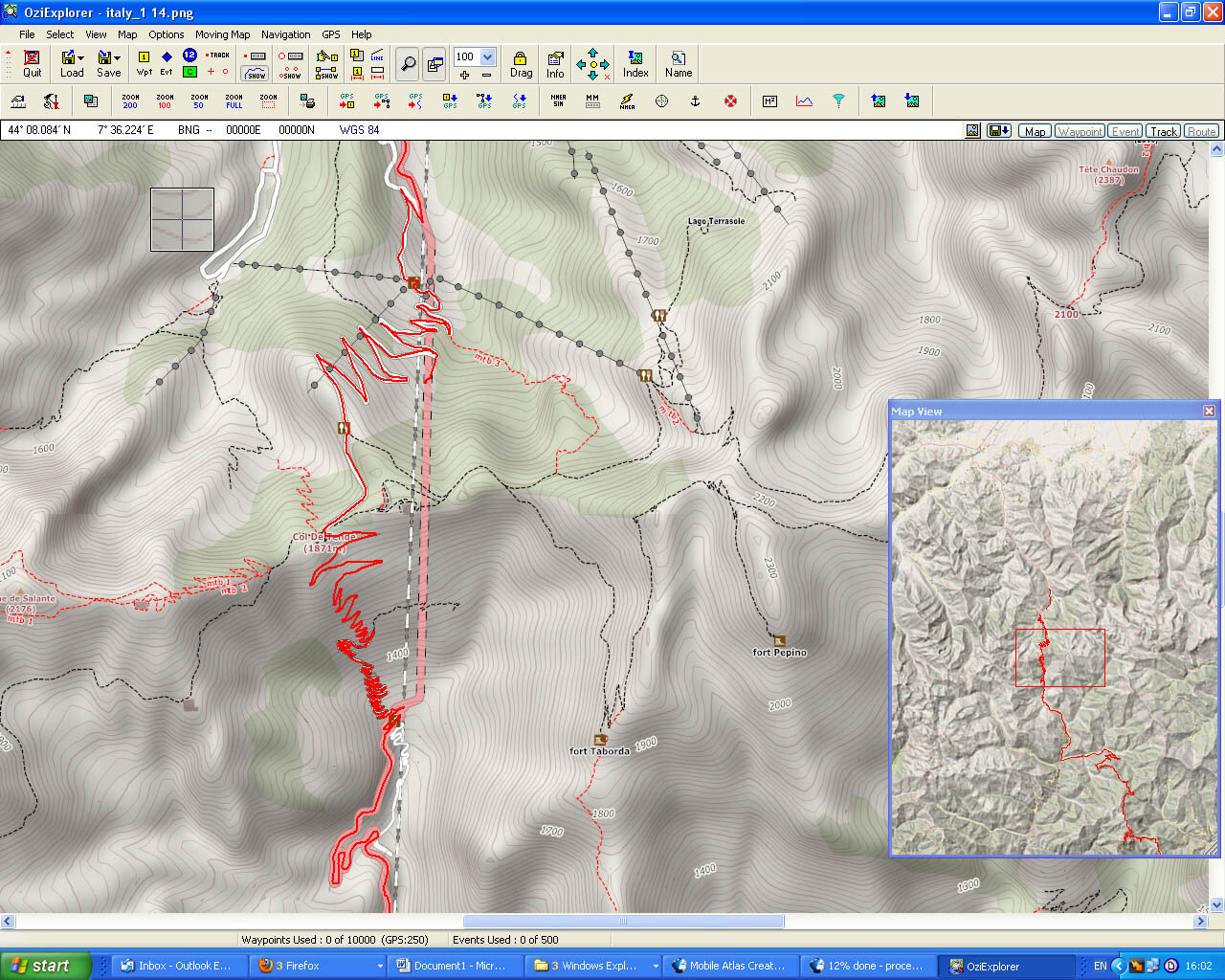

i am downloading a huge chunk of this map, at zoom level 14
OpenStreetMap 4umaps.eu (Europe)
you can select a large area on map on a "zoomed out" view, but ask it to download higher res tiles.
it has many export formats incl. ozi
I cannot seem to attach a screenshot at moment, but this map format i chose has countours, roads, and tracks incl. GR footpaths.
i matches part of my alps tracklog perfectly in oziexplorer.
so finally i can compile some decent digital maps for Italy, i was lacking these last summer. i had maps without contours and the maps i did have with contours were 1950's vintage...

Always amazes me how detailed the OSM data is. Handy program :icon-cool:
i looked at it last year, but i am sure i couldn't find maps like the one i found today.
