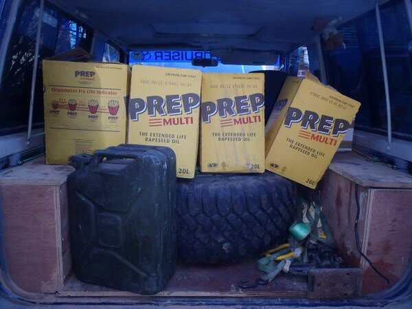

in the summer then you could run 100%. but at this time of the year id say 50/50 would be ok. but id start with a mix of say 60% diesel to 40% and see how you go. id also only put say 10litres in to start with and see how it goes. that way if it starts running poorly on it you can just fill the tank up with diesel.
ive been caught out a few times lately, mainly because i put a load of 90% veg oil in and because of the cold weather the truck got slower and slower until it was really lacking power. made it to work just, then stuck 20 litres of diesel in and she was fine again afterwards.
but dont be tempted to say stick a lot of veg in the tank and then a load of diesel. you really need to put them both in a can and give it a good shake to mix it thoroughly.
it can be hassle, but it does save money, especially if you do a lot of miles.
tesco and asda are currently the cheapest places, its coming out at 90p per litre.
if your lucky you might find a pallet load at bookers, which is almost past its sell by date, and if your even luckier one of the drums has split and leaked all over the other drums on the pallet.
my mate bought a pallet load, worked out at 75p per litre. :clap:
should keep me going for a few weeks. :thumbup:
oh and welcome to the club. :)

no sticking 5 litres in and running around is not a good idea at this time of year.
ive experimented by getting 2 bottles and half filling them both with veg and then topping up with diesel.
the one bottle i shook vigorously. the other bottle i gave a gentle swish, in an attempt to recreate the effect the diesel and veg might have if there both just poured into the tank separately.
i then kept an eye on the bottles over the next week and what i found was that in the bottle that had been vigorously shaken, the contents were still mixed together with no signs of separation. but in the other bottle the the veg and derv had clearly separated. :)
so i think its important to put them both in a can and give them a good shake before pouring it in the tank. :thumbup:
this is only while were having cold weather though, in the summer i run 100%veg so just pour it straight in the tank.
you will find that for the first few thousand miles running on veg that the filter will need replacing more often than normal. you will also notice that it will be quite black inside. this is because the veg oil seems to clean all the crap out of the lines that has built up over the years.
i found after changing them a few times, after that they are fine. :thumbup:
