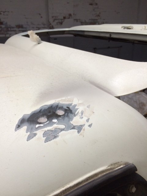

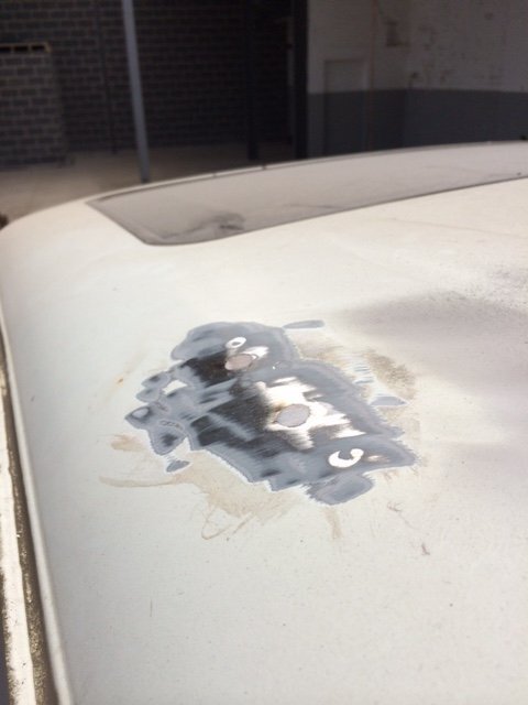

The roof liner on the later 80's is a solid sheet of hardboard and is easy to take down. The rack has 6 fixing points that are then easy to access.
i had mulled over welding up the holes but my welding skills leave a lot to be desired and I thought I would cause more damage. I ground off the paint in the areas of the holes and slightly dinted the edges around.
Inside I glued some metal plates over the holes using Soudal Fix All. I came across this mastic last year and it is an excellent product.
Once this was cured I bridged the holes using fibre-glass repair paste (Jam to anyone in the auto-refinishing trade!)

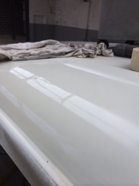

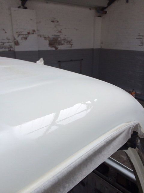

After filling, priming, wet flatting and priming again the roof looked smooth enough for final paint

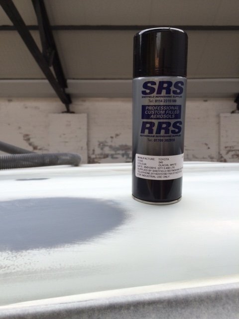

The local refinishing supplier SRS supplies sprays colour matched to chassis numbers for about £11.00 each. In cellulose so easy to flat out repairs.
Whilst not perfect, the finished job looks decent enough. I would say equivalent to British Leland factory finish from early 1980's, think Austin All-agro (apologies to any forum members who worked on BL production line in early 1980's)
