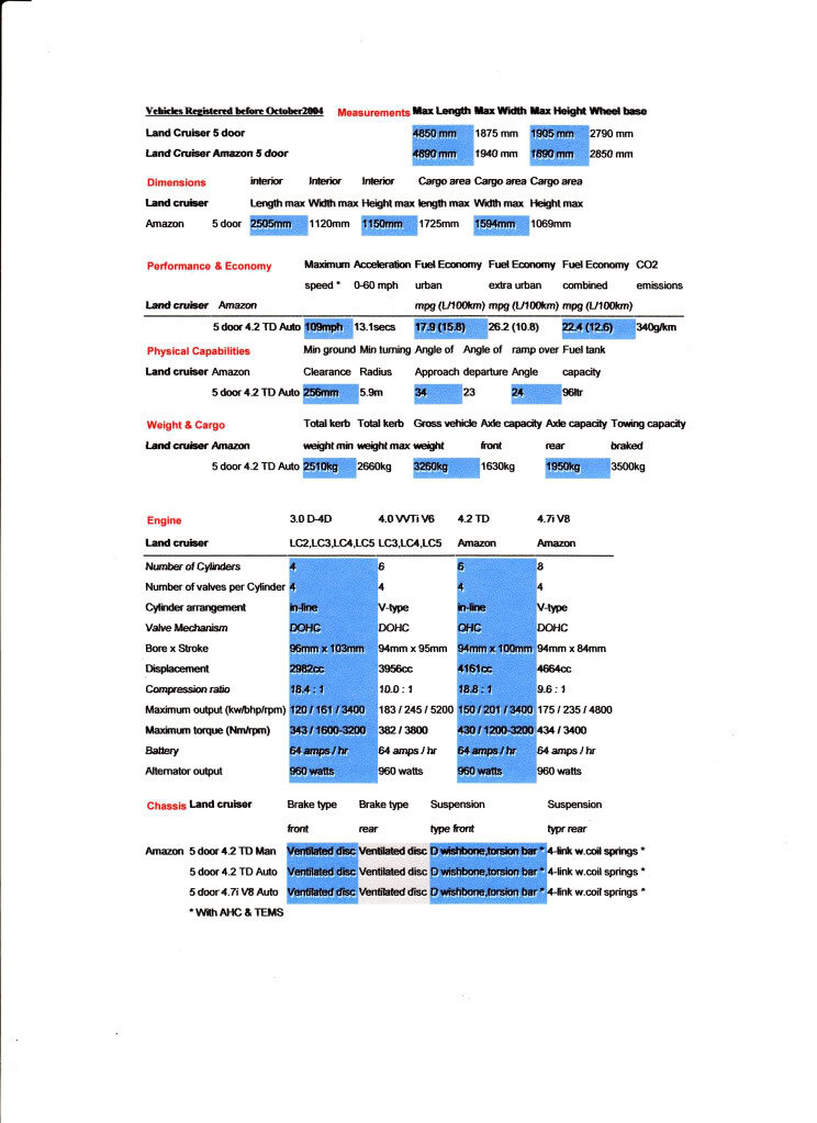

I can't look at my VIN plate a the moment as the Cruiser is still with Julian V, but I found a file saved on my computer, I don't know where it came from originally, I don't think I can put it on here as an attachment so I've printed and scanned it as a picture;
I hope that helps, maybe someone may recognise it?

Interersting . . But does the 3.0L D-4D motor really have a double overhead camshaft (DOHC) ???
I suspect its actually a single OHC, like the 1KZ-TE.
(Now to be proved wrong :) ).
Bob.

Sounds like the first of the 100 series with independant front and 201 bhp 4.2 TD.
Very similar to the 80 but the electronic fuel injection gave them about 15 bhp more.

I think the Amazon in your table is a 100 series Chas.
