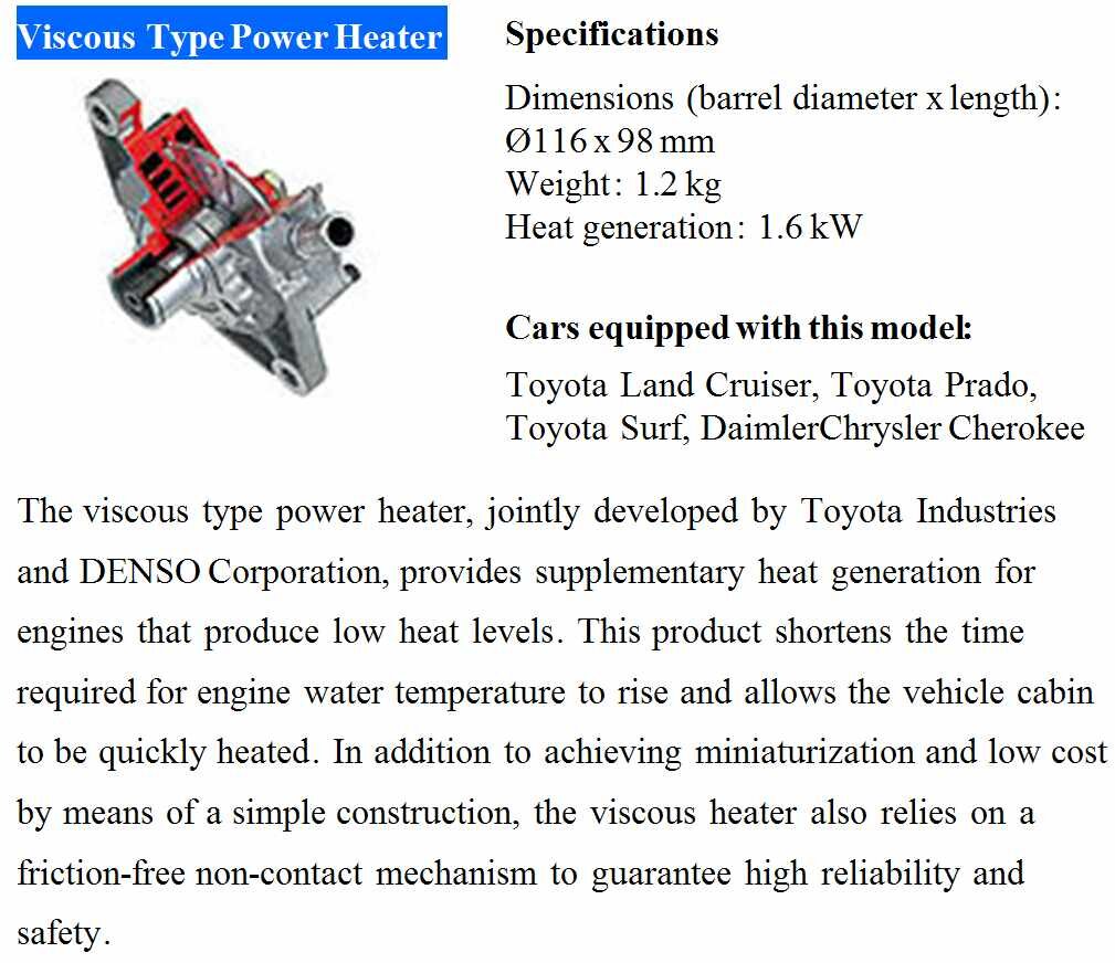

What's the rusty looking pulley in this photo attached to?
It looks to be a pump of some kind with a magnetic clutch fitted to it and looking at the pipe run I would say it something to do with the cabin heating, but I can't get the thing to run no matter what settings I have the heaters on and wonder if it shagged hense the rusty look of it. The heaters all appear to work well, so I'm a little perplexed as to the pumps purpose?!
Any advice or pointers would be much appreciated
