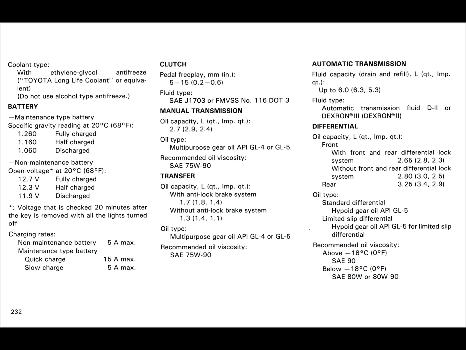

I ended up buying that red 80 I linked in the other thread and I want to go to the auto factors and get new engine and diff oils for it and change them all.
Just wondered what oil a 1994 4.2 12V with triple diff locks takes? I’m guessing 75-90 but don’t want to put the wrong stuff in!.
Also would he really handy to know how much oil they take, would be really grateful to anyone who could let me know.
This is from the owners manual of a 24v model but I would imagine they're virtually the same.
You'll want 10L of engine oil for an oil and filter change.
Thanks a lot for posting this, it was really helpful, looks like I’ve already got the right stuff for the transfer box, just need to get the stuff for the diffs on Monday.
Although the manuals say slightly different specs for the transfer box and the axles, Toyota now say 75w90 GL4/5 for both - according to Roughtrax website.
