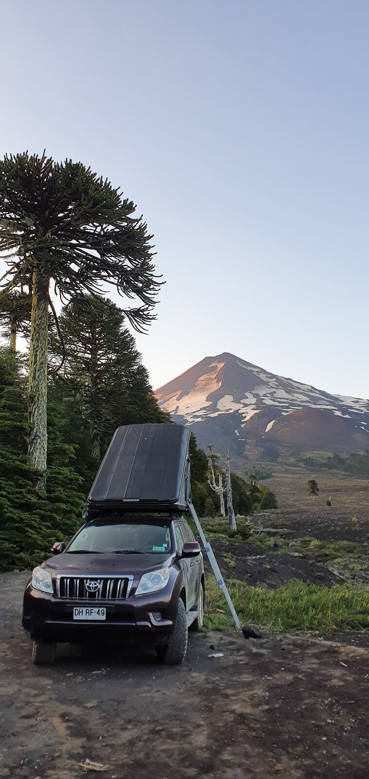

Hey folks,
When the pandemic hit we were isolated from our Prado in Argentina due to an unforeseen border closure. It seems like we will not be able to move it again until December this year, by which time it stood for over 1.5 years. The Prado is in a safe spot, but there is no one and no way we consider sending our keys to someone down there.
Question is:
What would you check/change/service before moving it longer distances?
The Prado is 2012, 150tkm and was left with a full gas tank. It is parked in Tierre del Fuego.
Thanks for all your inputs!
Mike and Linda
