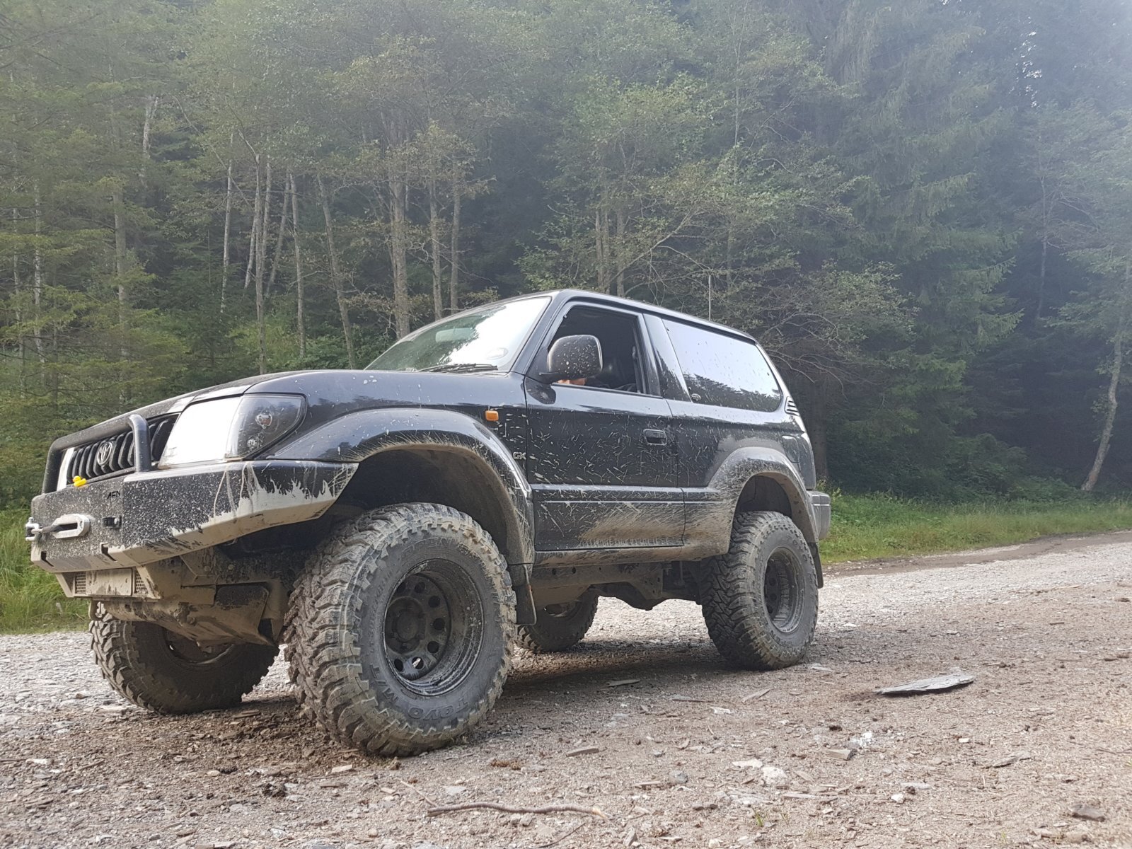

Right i'm ignoring the wheels (what are they from a 120 or Hilux ?) and just looking at the bodywork I'm erring towards a 16x10 wheel with a 285/75 tyre which is a combo i can't show you .
My truck has about a 4" lift and i'm running 16x10 ET-32 with 305/70 tyres and the mrs has , with a 2" suspension lift 16x8 ET-38 with 285/75 tyres .
Do you have a lift ?
I will get you some pics tomorrow .
Hi mate. do you have any pics of your mrs's car? I've got a 90 series with 3" lift and I'm looking to change the stock 16x7 (265/70R16) to 16x8 dressed in 285/75/R16. just wanted to get an idea of what a -32 offset looked like
Aye Nick's the photographer i never personally got into the habit of selfies or sending pics of my winkie to old ladies :lol:
Nothing fancy ms0832 its just a 2 + 2 inch suspension and body lift , inner arches were trimmed a little long ago but i'm not sure it would be necessary had my learning not evolved with the truck .
