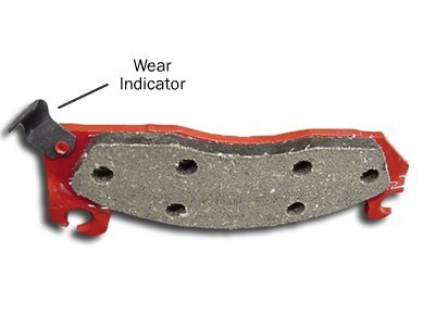

Steve im talking about these wear indicators (not LC pads BTW):
Also the 80 doesn't have any fancy electronic wear indicators, but my sisters basic 1989 BMW 318 E30 has :?
I have not found any instructions that came with the pads, they are Toyota pads BTW.
The only reason I am asking is in case they damage the discs if fitted incorrectly. Chris your theory sounds reasonable, now i just cant remember which way reound i fitted mine :roll: Ill check the FSM to see if that will help.

According to the FSM they should be mounted so the wear indicators are at the bottom on the 80 series, meaning that the wear indicators dig into the disc under braking when going forwards. I can only assume that if fitted the other way round (ie get pulled apart) that there should not be any problems with them damaging the discs.
One thing that surprised me is that the Pads are handed - on the rear of the OEM pads there is an imprinted "L" and "R"...
I couldn't work out why - so I just replaced mine as they were fitted before (i.e. handed and with the wear indicator on the bottom).
