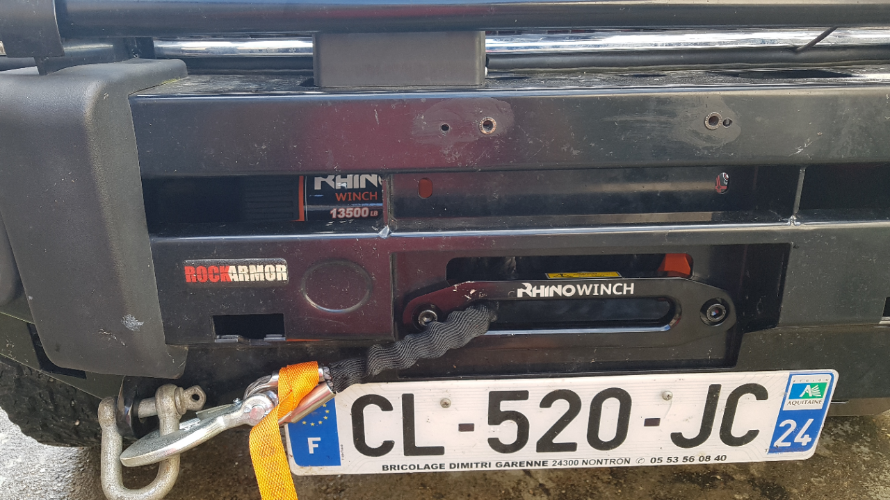

At last - bought a Rhino 13500 lb, plasma, 2 remotes and a cabled control
hides away nicely :)
