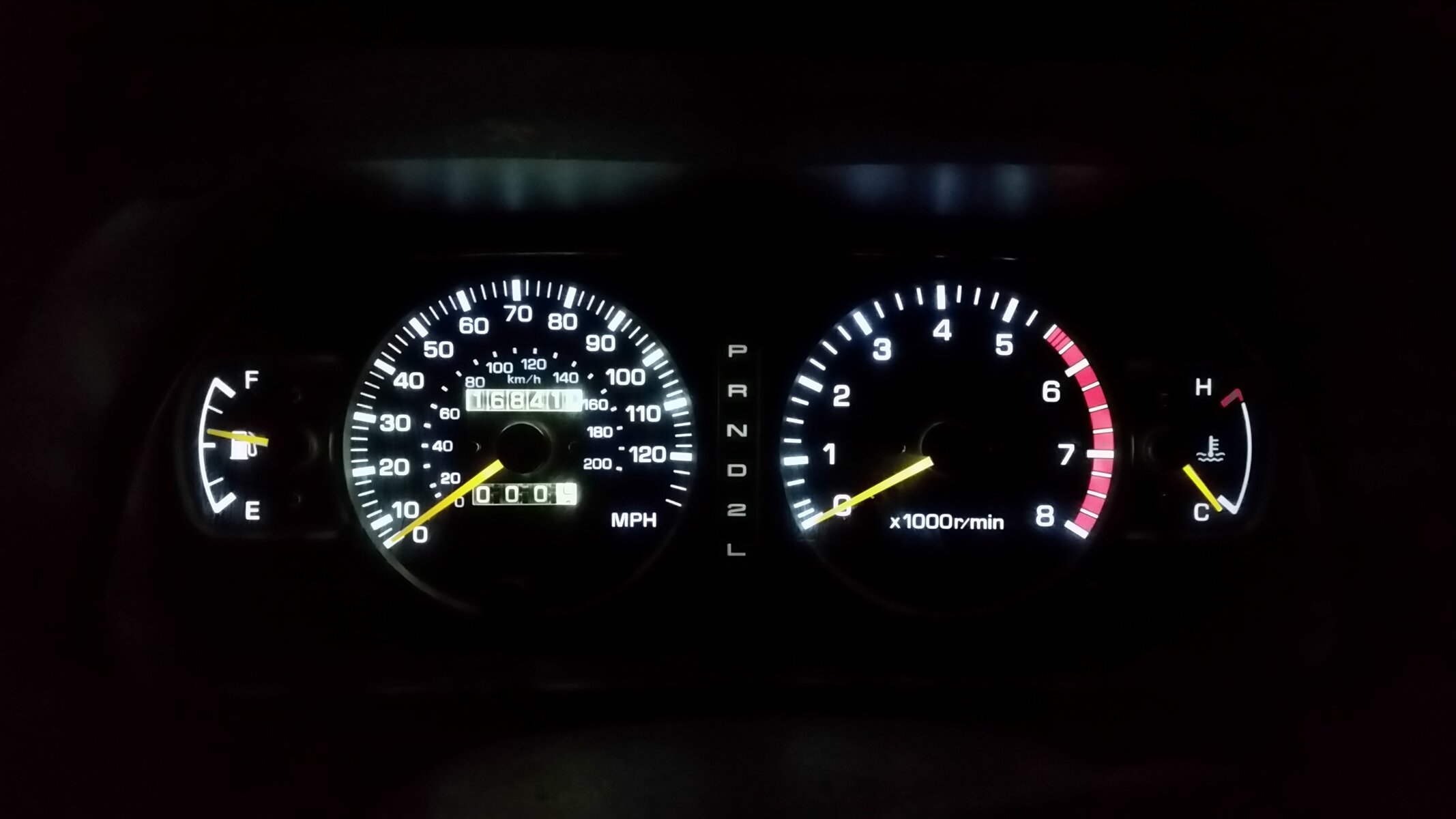

Gave it a good run out today and all is good with the old girl. It's nice to have it home again as been at work for the last week while sorted it out.
