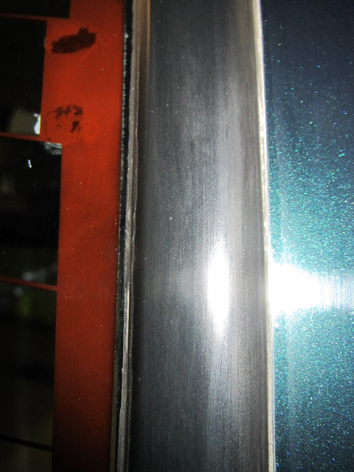

The above shows where the gutter seal I used has crept over time with the heat of the sun. But gives a good idea where I applied it.
I think your better off spending the time it would take to clean off the old gasket, by doing half a days overtime and spending the money on a new gasket. Iirc i used meths to clean off resedue sealant, it might be different in the colder weather but the arbomast continued to ooz out for a couple of weeks. I masked around the body work with masking tape just to take the bulk of the excess off. Imo better to much than not enough on this occasion.
