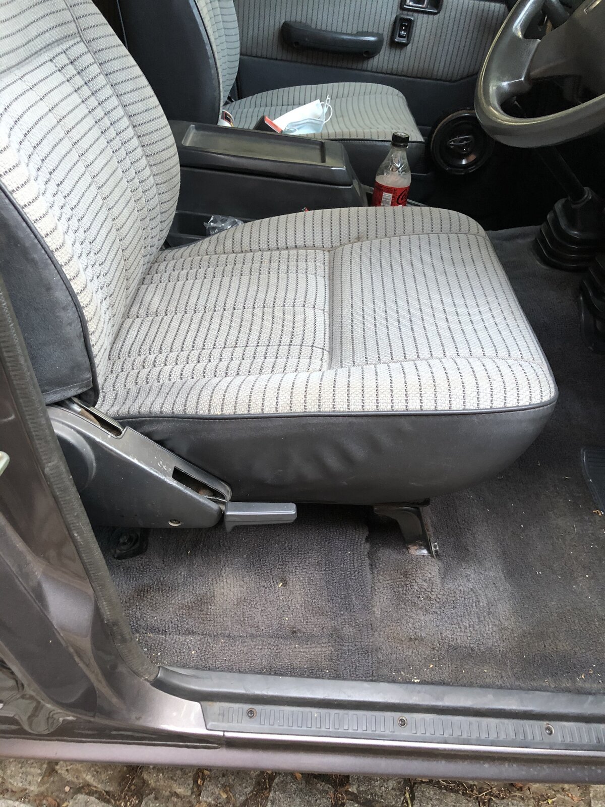

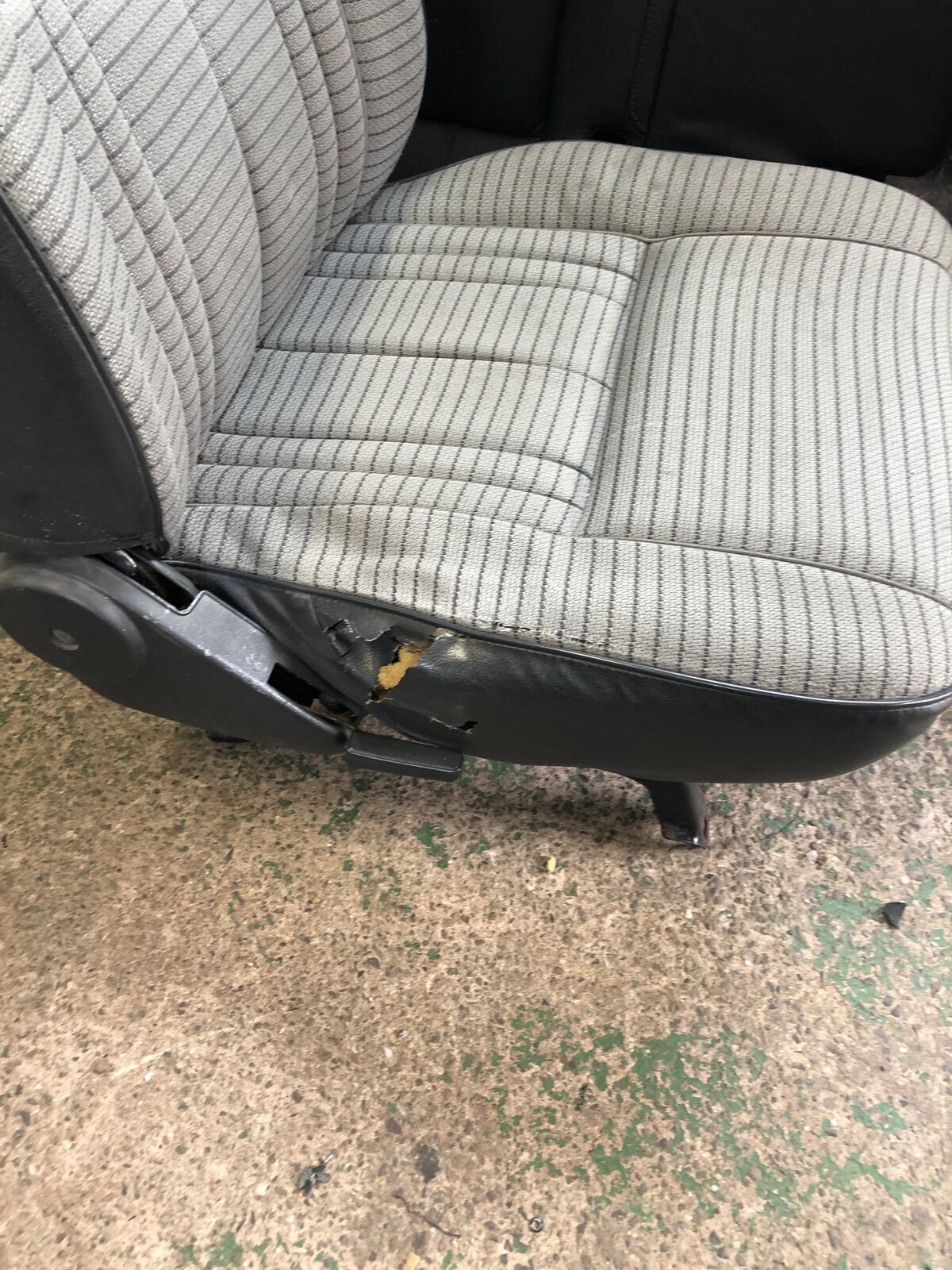

Reupholstered drivers seat , managed to get a mint passenger seat as the drivers side was shot swapped over the foam and the fabric and fells quiet different lol
