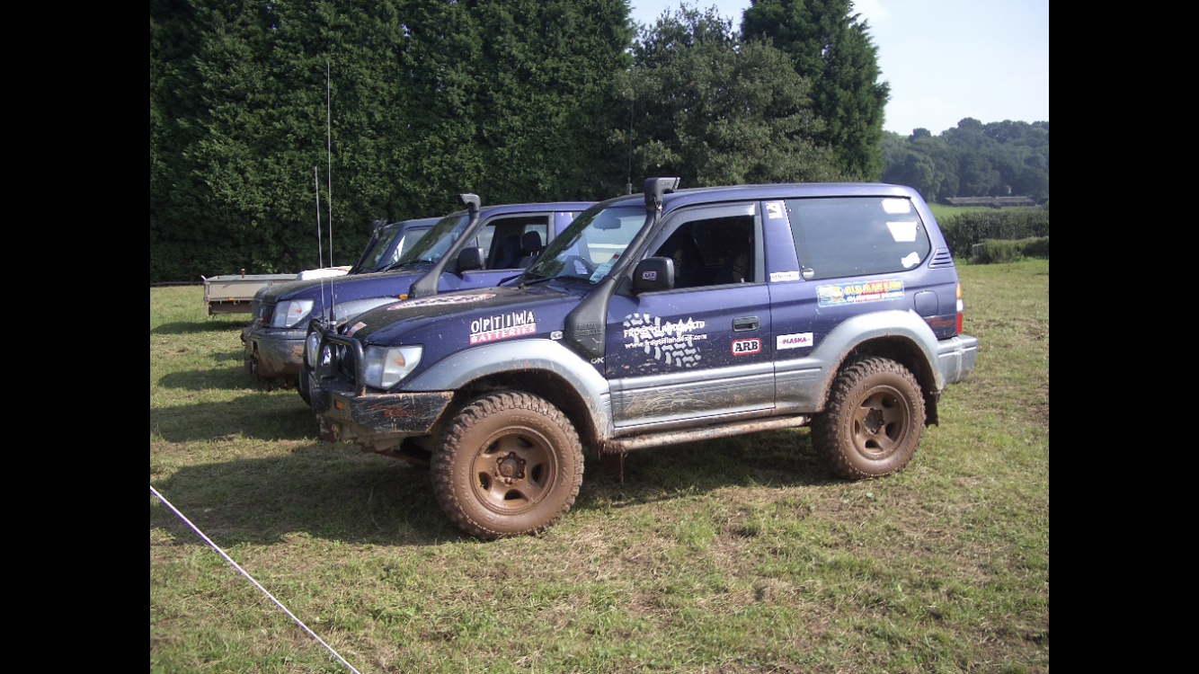

Thanks, the photo below is more or less the effect I wanted. Looks good...
That's Simon Rose's truck and mine behind it at Lincomb Farm. Just make sure you get the correct wheel nuts. There are two types of 80 wheel. Flanged nuts and cone nuts.
