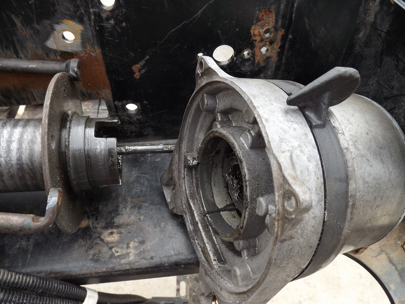

After more searching than i feel should have been necessary i settled on M10 X 1.25 metric fine 8.8 zinc bolts and M10 X 1.25 metric fine all metal manifold flange tri lock nuts , both from Spalding Fasteners on ebay ,for bolting the winch in which should i hope offer some strength and prevent loosening by vibration .
This is all new to me so either it will save someone some time searching or somebody will reply saying don't use them ?
To add the flange nuts use a 14mm spanner so don't need trimming with a grinder .
