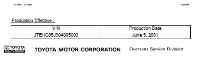

It is about the "fiber washer" relating to the torque converter in the auto box, of the 100 series.
When did the problem get fixed by Toyota?

If any one can put a time period that this problem was alive for, until Toyota fixed it, I would be most pleased.
Gra.
