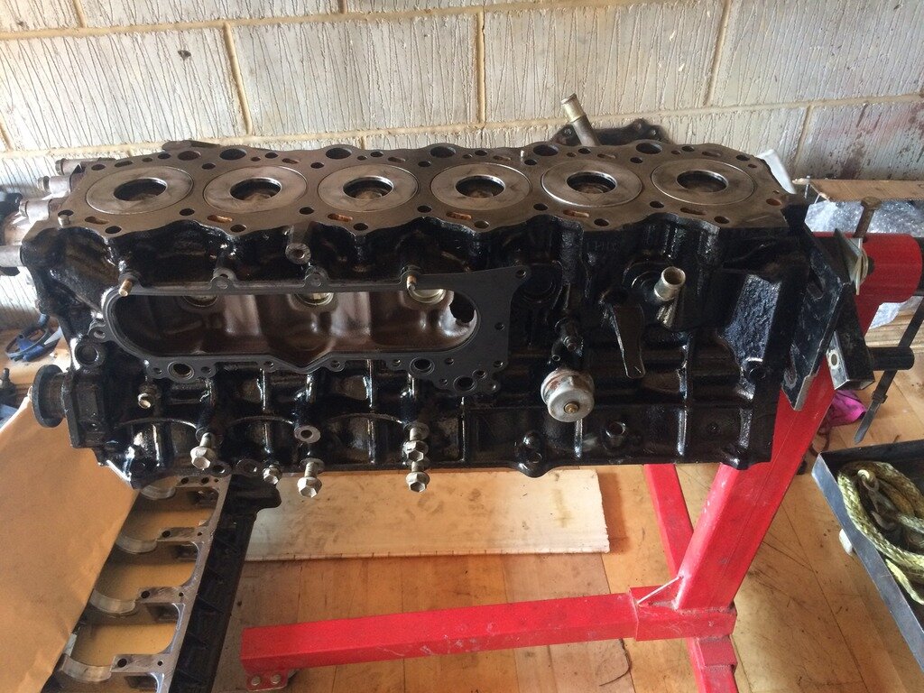

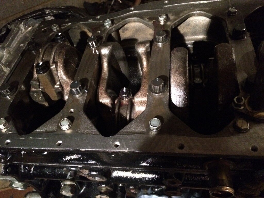

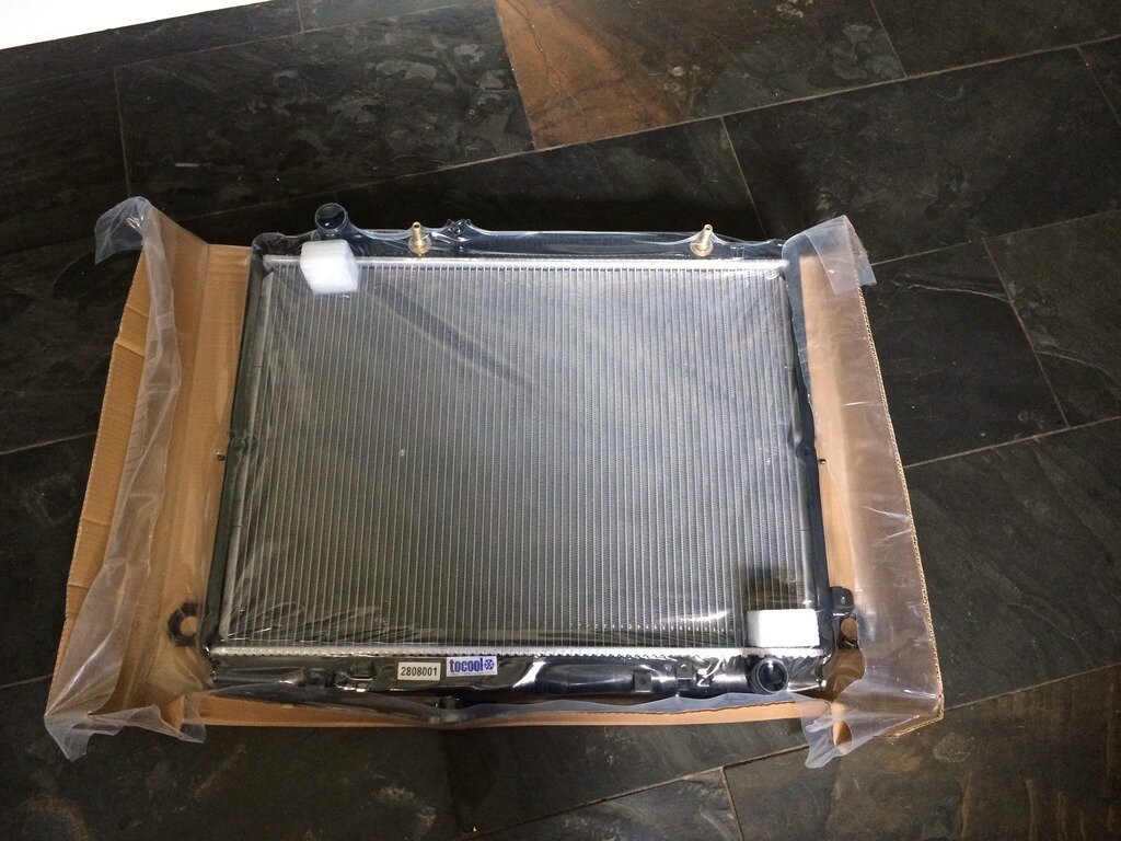

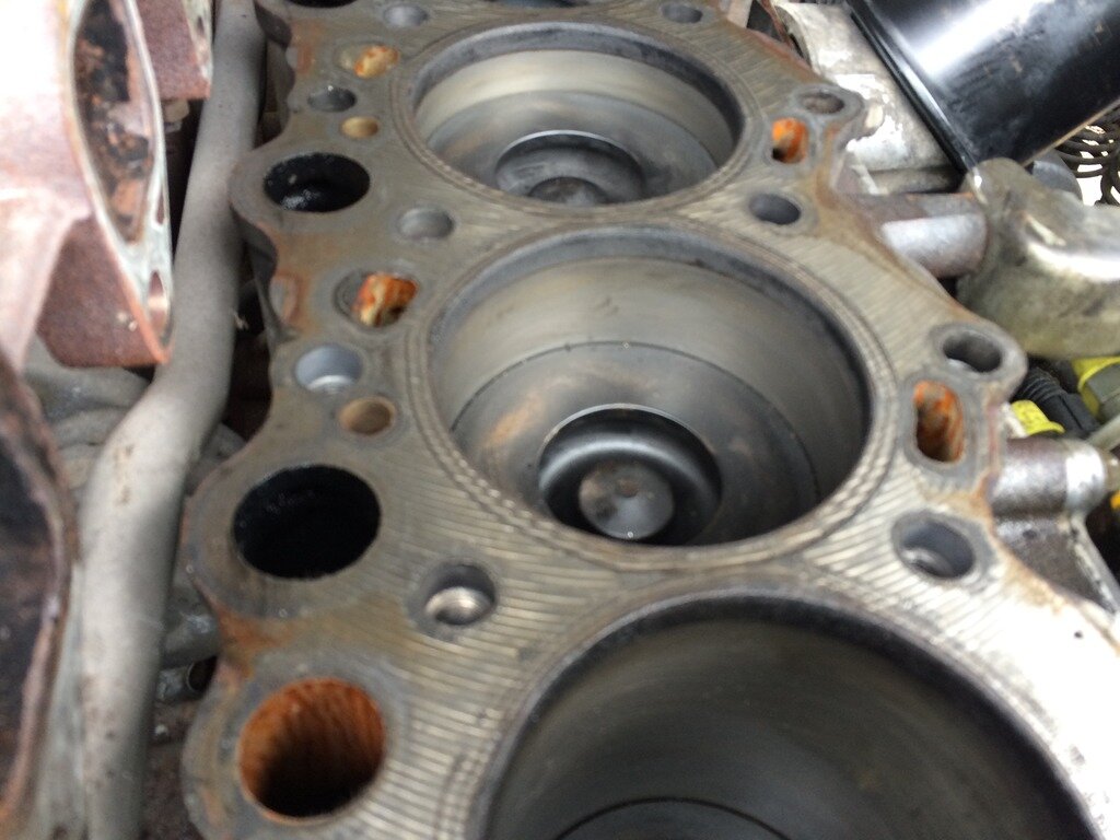

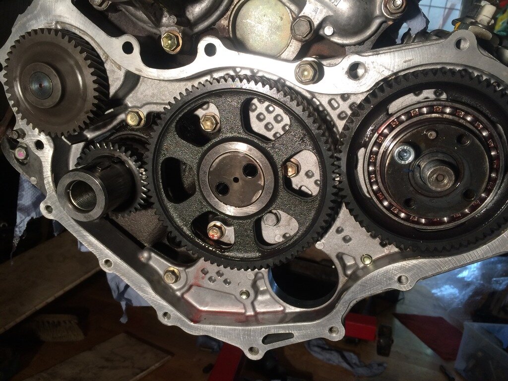

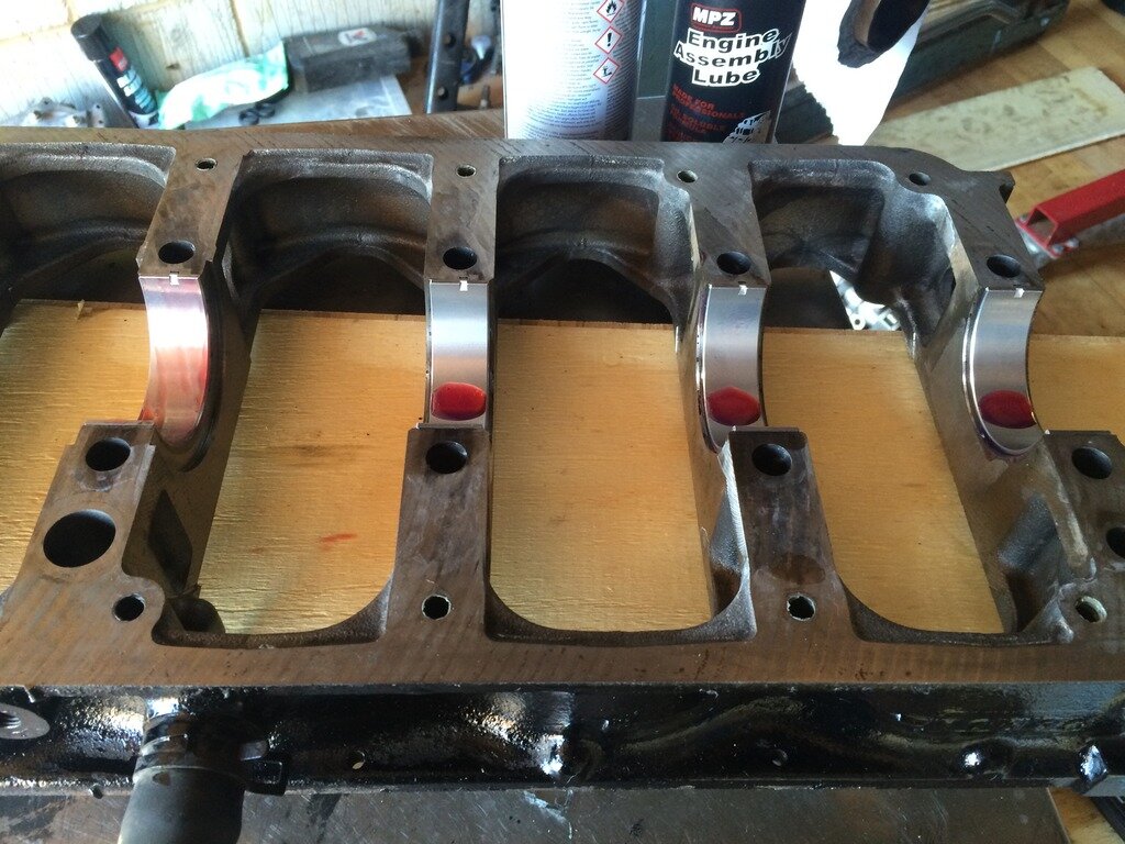

It'd be nice if I had something approaching a clean room (air filtration, positive air pressure at the doors, sticky pads for feet, completely sealed walls / ceiling). I've just done what I can to minimise debris :)
