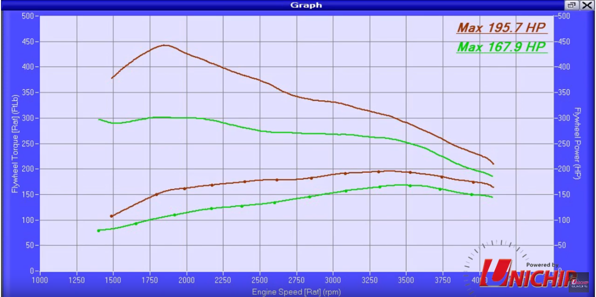

Hi guys - little late to the party but our tuning kit will offer somewhere in the region of +40% increase to torque, or around +140 LB-FT of torque. Our total horsepower / torque outputs for the Land Cruiser Series are 22% lower, as the kit was modelled on Cruiser with chunky off-road tyres, increasing the resistance on the rolling road and naturally decreasing perceived power. I wouldn't pay attention to "total" power outputs - pay attention to the percentage gains instead; they're most important.
Graph: The 1HD-FTE engine produces 380 LB-FT torque from birth. 22% off 380 is around 300 LB-FT of torque (as shown in by the green line). Hope this clears up some misinformation around the Unichip. With our tuning Kit, you'll be looking at 440 LB-FT of torque, or 597 Nm.
OP: @GrahamR - You've misinterpreted Steinbauer's performance figures & have quoted 500 LB-FT of torque - the 500 figure quoted by them is actually in Nm and not LB-FT! Not picking holes - i'm just an advocate of properly quoted figures. Loving the colour coded spreadsheet though. :wink:

I bought a 2005 100 series that had a Tunit fitted, i have just replaced the Tunit with a Unichip and what a difference. The difference that the Unichip has made is almost unbelievable and it still has a higher power setting to go.
I would defiantly recommend the Unichip.
