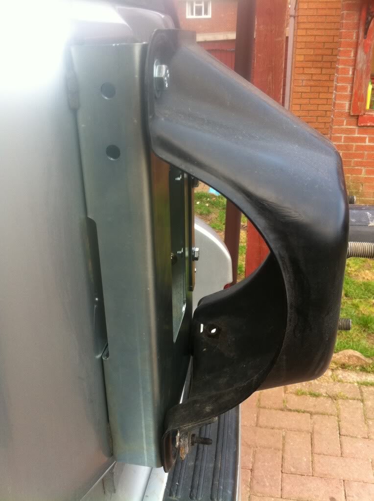

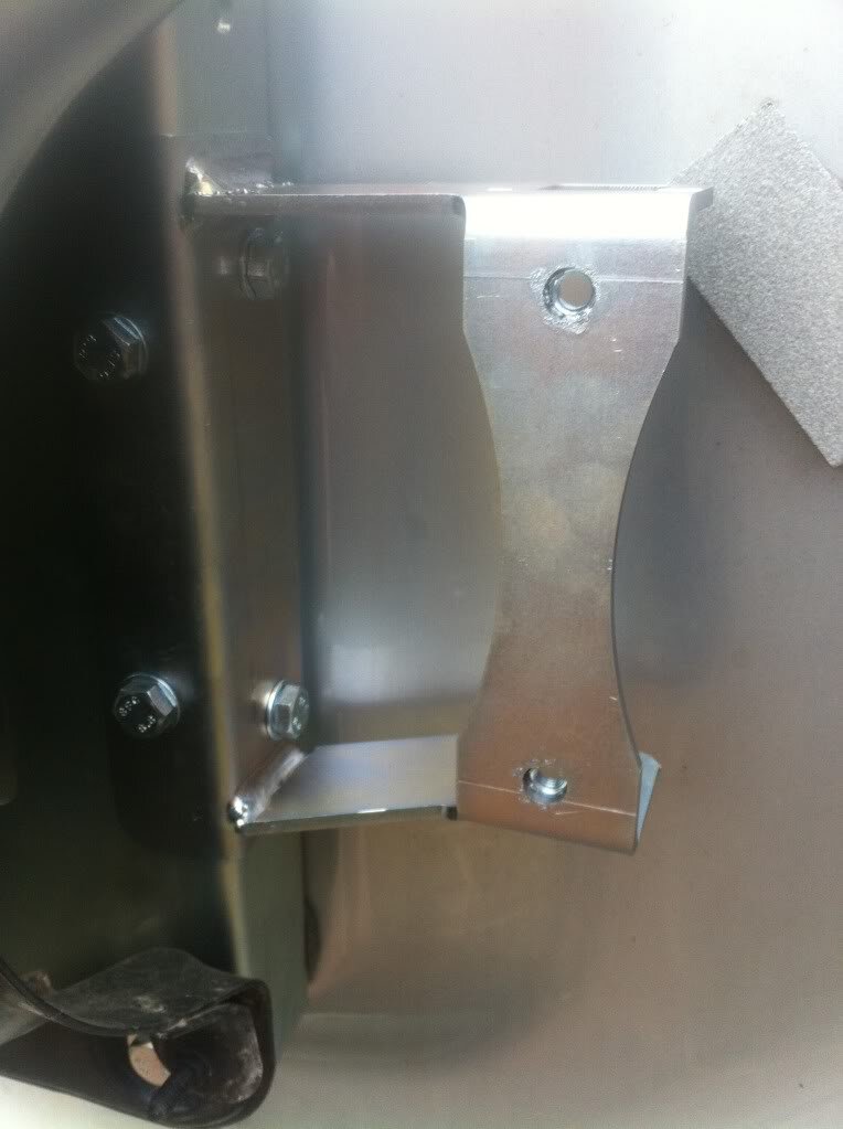

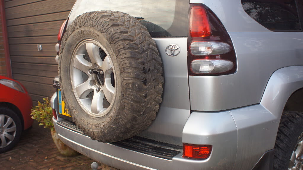

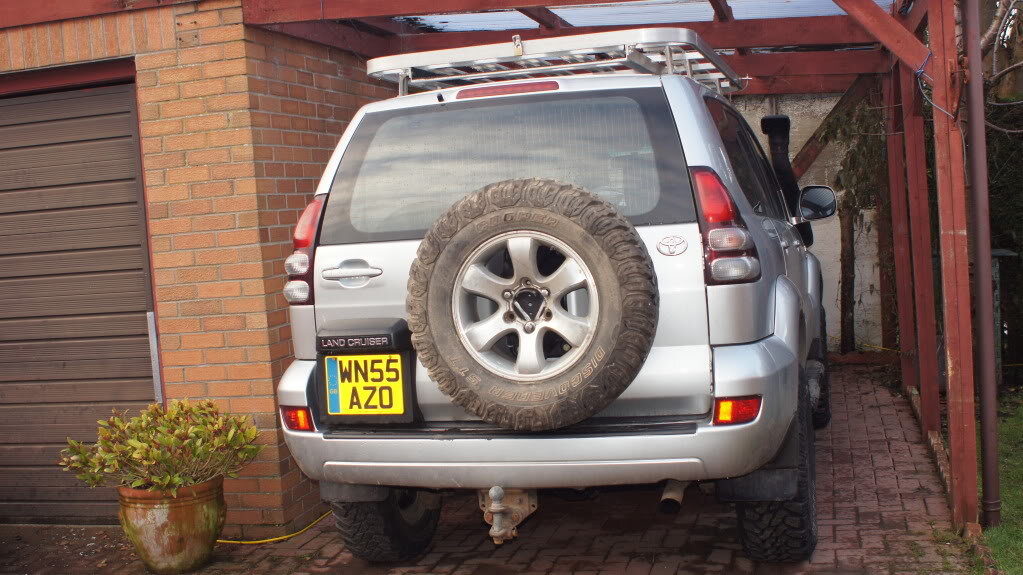

Rear door with the spare wheel carrier successfully fitted to my LC5 - some pics to follow when it's not raining or dark - maybe about May 2011, I guess :lol:
Busy man. You'll be getting some snow at the w/e to try it out, unless you've had a bit already. :thumbup: We're due some too. :clap:

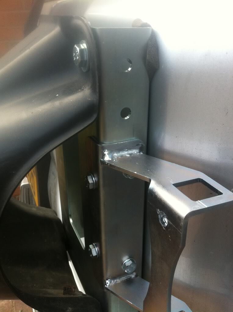

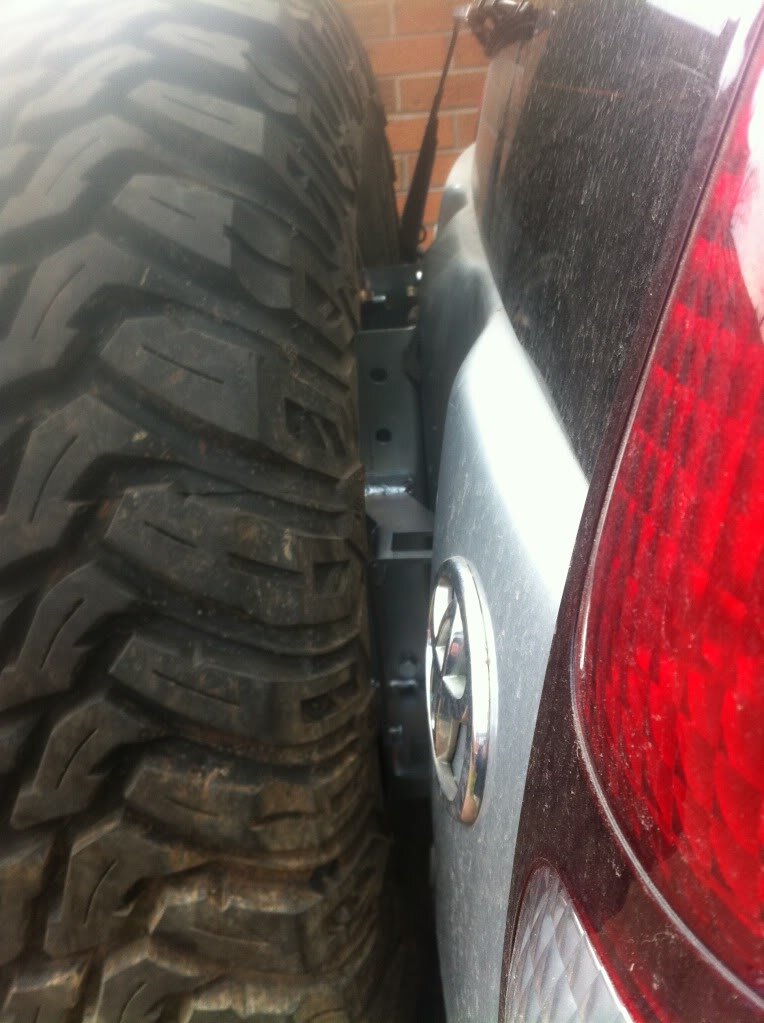

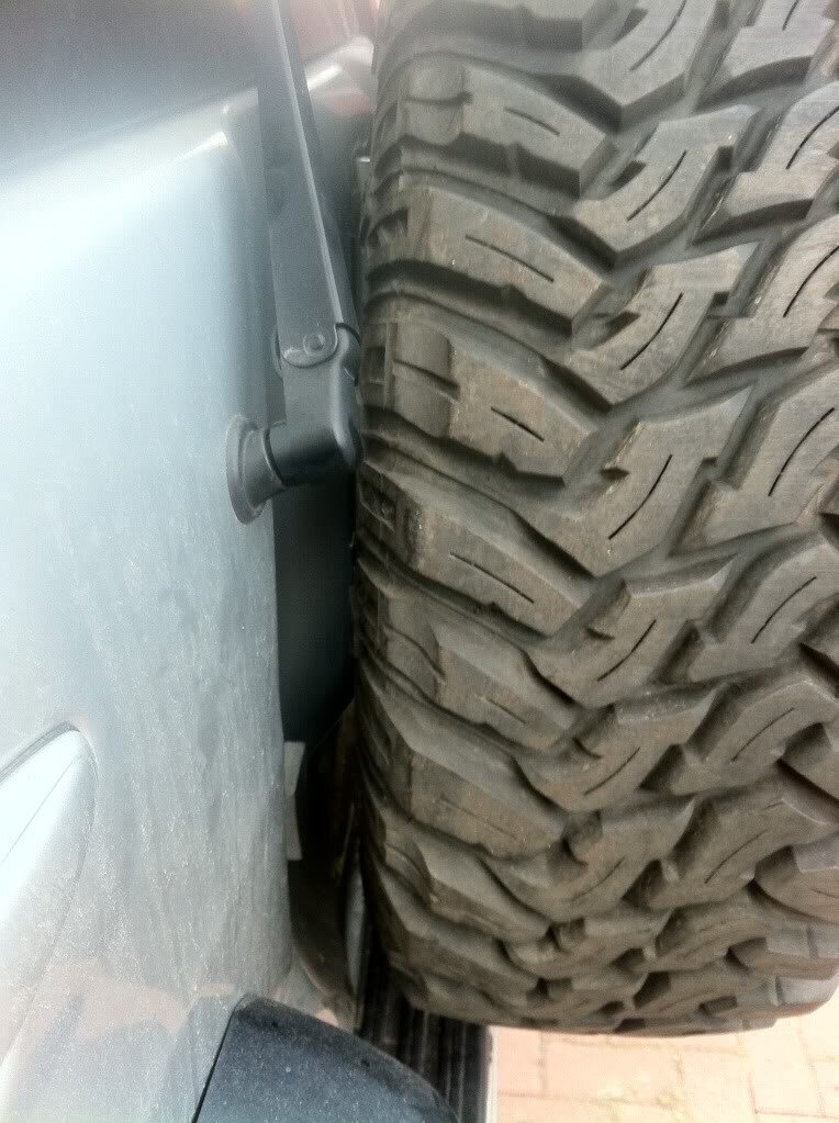

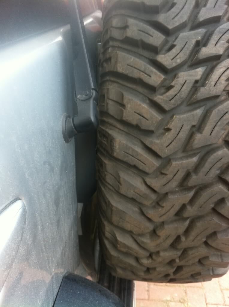

Put in a Kaymar spacer to ensure the wheel doesn't catch - can now go to a 285/70x17 successfully.
Couple of piccies:
more pics:
The spacer:
The extension on the right is for future use - mounts and extendable worklight and an antenna...
Tyre back on - there is a decent gap now:

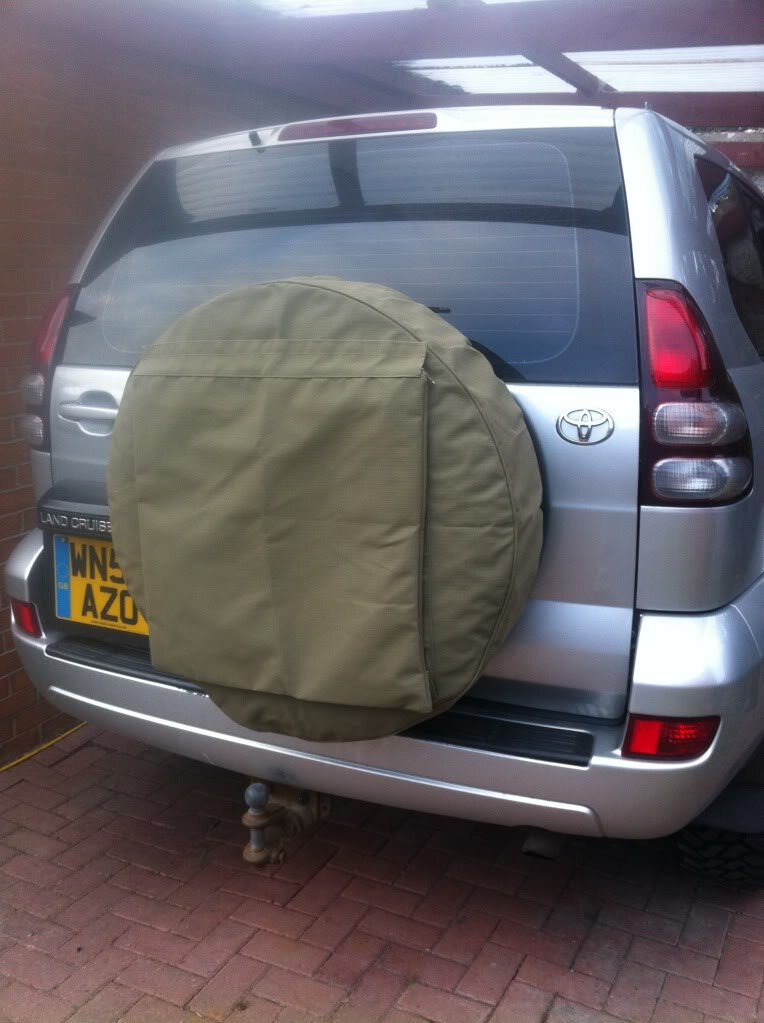

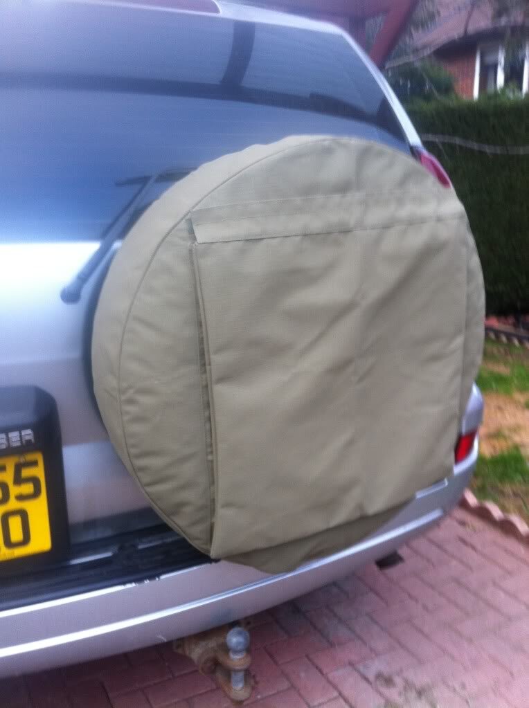

And with the wheel cover on - ready to GO!!!
Had the 'new' rear door glass tinted to match the rest, so now I have to stick on another club sticker and flag, and wheel be ready for June!!
