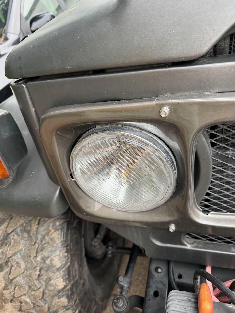

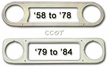

As far as i'm aware the square front grille was used from 79 - 84, however my 1977 has a square grille.
On closer inspection it appears the grille on the car is incorrect and should be the round lozenge shaped one.
Before buying I was just wondering if anyone can confirm this from the photos, and if so is there different sizes / models that fit?
Thanks for any help (my first post btw)

The years shown in the CCOT attachment are correct and you do have the wrong bezel.
Your later bezel doesn't have the same shaping as your valance.
I have attached a photo of my truck so you can see how the correct bezel lines up with valance shape for a pre '79. To me it looks like smaller headlights have been fitted too.
The correct bezel should be mounted with the thicker cross bar to the top thus hiding the bonnet release. This bezel does not sit hard up against the valance panel and the 4 screws have spacers/risers on them.
Hope that helps.
