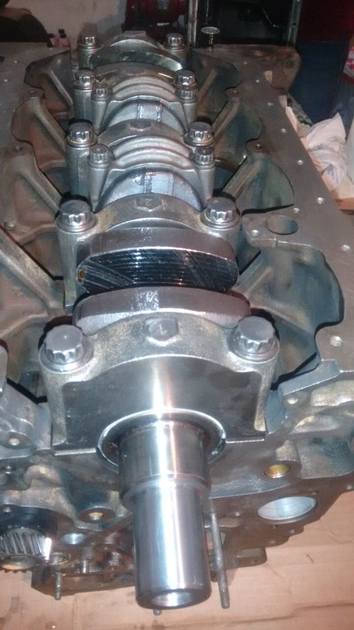

So we pulled it all out... turns out there was more damage there, damage on 2 pistons and rings also 2 cylinders, and bearings. I was told the last guy to replace the pistons had put them in wrong......
So I had it all redone. Head and block also the crankshaft was worn so I put a new one. 2 cylinders were changed all water jackets replaced and this is were we are now. Will begin to reassemble tomorrow....

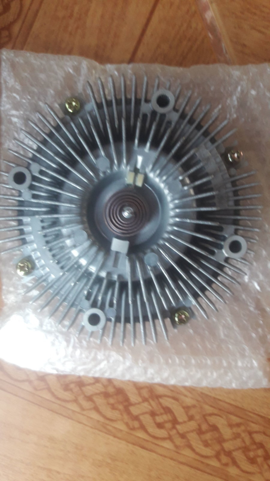

Thanks SC, first the thermostat has been removed. I was advised by a few persons that taking it out completely would be better for this climate. (Hot,humid)Mechanic did say the fan needs to be replaced, said it was spinning to freely.

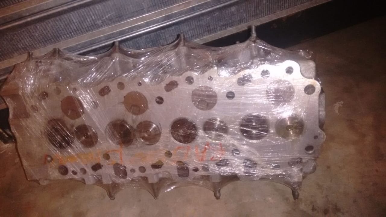

Hey guys, pulled off the head again and this is how it looks now.....

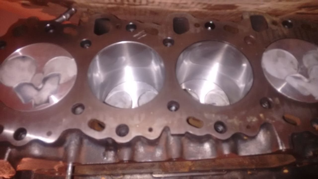

and here is the block..

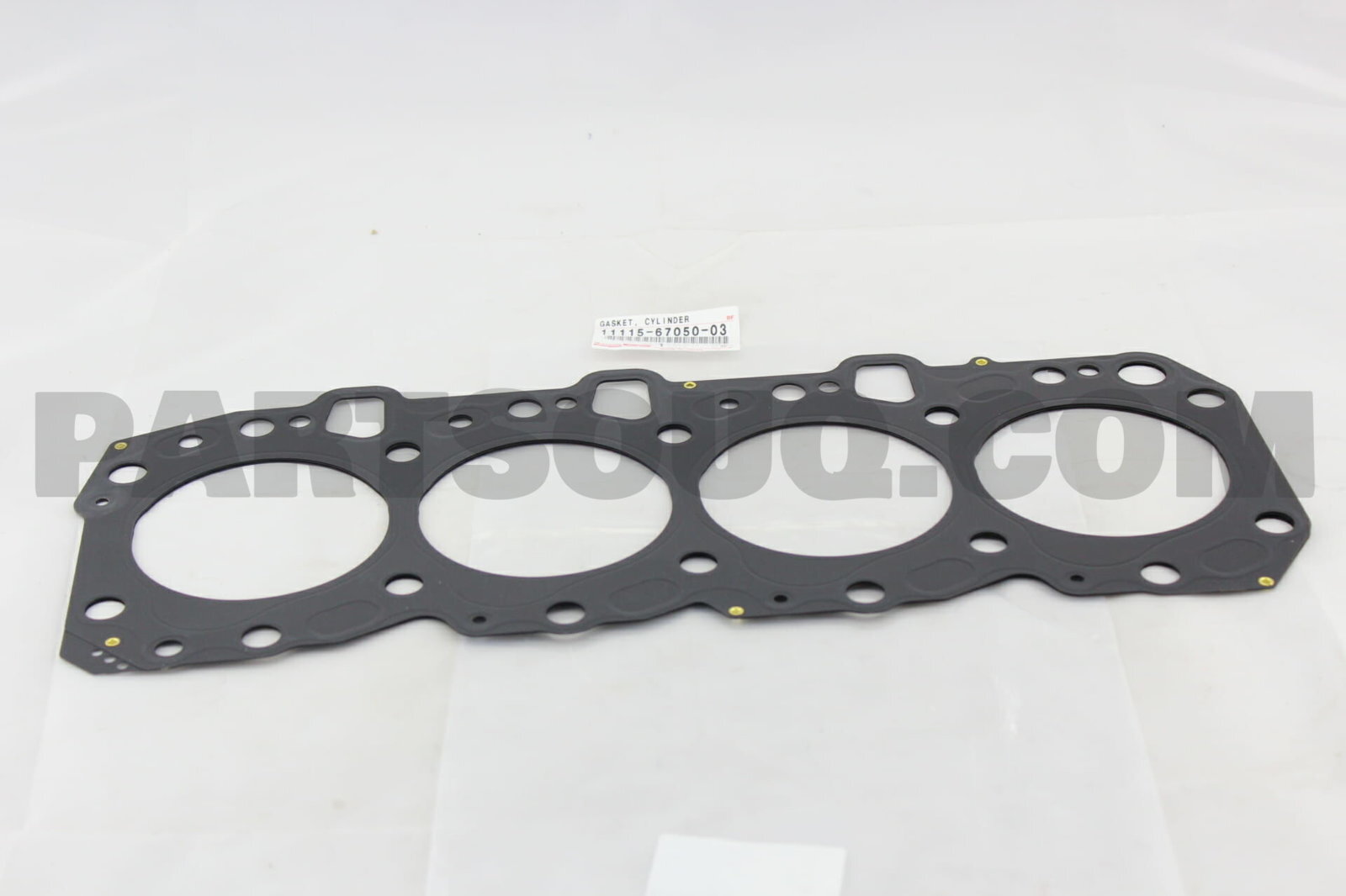

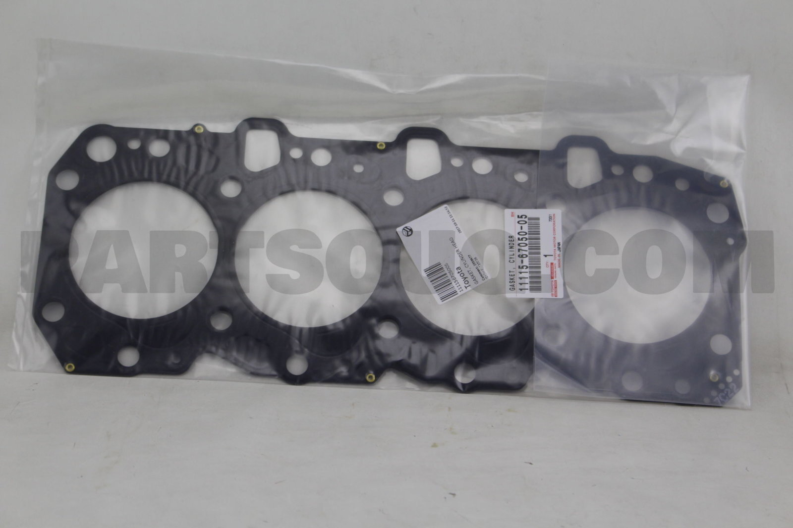

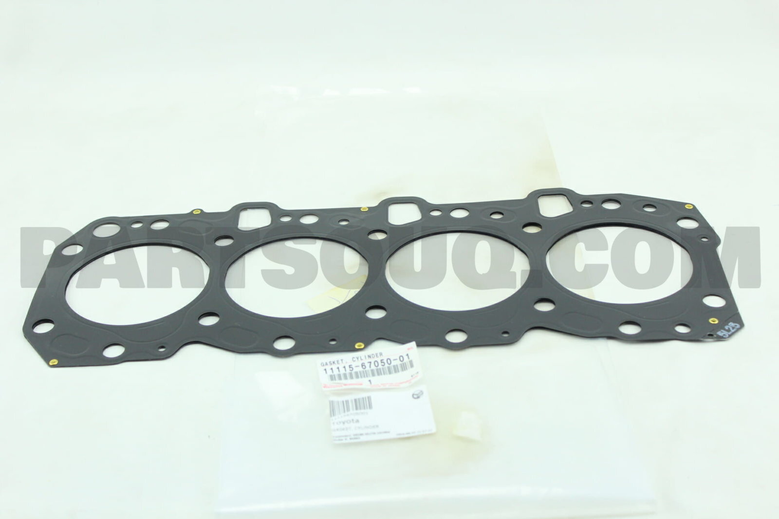

also when looking for the original head gasket I find 3 that is for my engine.. kd-kzj95w-gkpst.. they look the same but part numbers are different. Your assistance asap will be greatly appreciated. headgasket2.jpg headgasket3.jpg View attachment 152734 headgasket1.jpg
Here goes to the second round. Machine shop replaced mine with this one. A pressure test showed the head was cracked in two places... Claimed they found a crack on it which they might of missed. (They gave me a guarantee on the job they did before). Will begin installing in the am. Also putting a new fan/fan clutch. And new hose for the intercooler. View attachment 152778 I'm hoping to find this crankshaft sensor as well.
I can get it online, but the waiting time.....
Any tips or tricks would be greatly appreciated as I pretty much have access to all of the engine at this stage. Thanks IMG-20181231-WA0004.jpeg IMG-20181231-WA0006.jpeg 20181231_214450.jpg IMG-20181214-WA0001.jpeg
