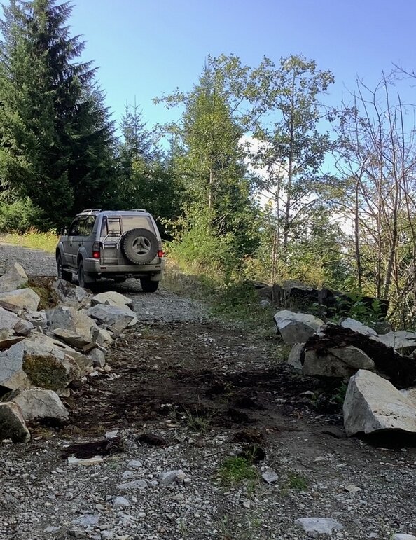

Attached is a photo of my Prado at work. With only a centimetre to spare at each tire, the big trucks would still be pushing rocks.

That truck looks very much at home there HEB. I am a firm believer that the 90 series design has aged very well
I do think the American built full-size trucks are generally too big to be really useful in tight environments, but then there aren't that many of those on the prairies or the suburban streets I suppose. A guy in the town nearest me has a Ford F350 dually that he imported (complete with twin chrome stacks) and the thing looks ridiculous on Irish rural roads.. same footprint as a Scania tractor unit.
