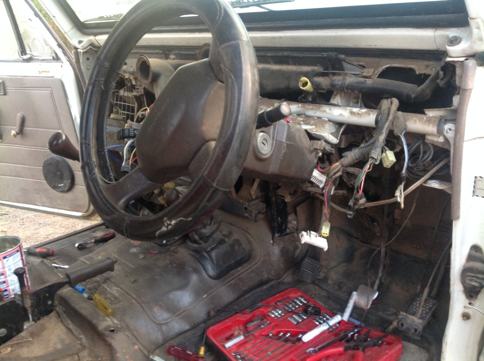

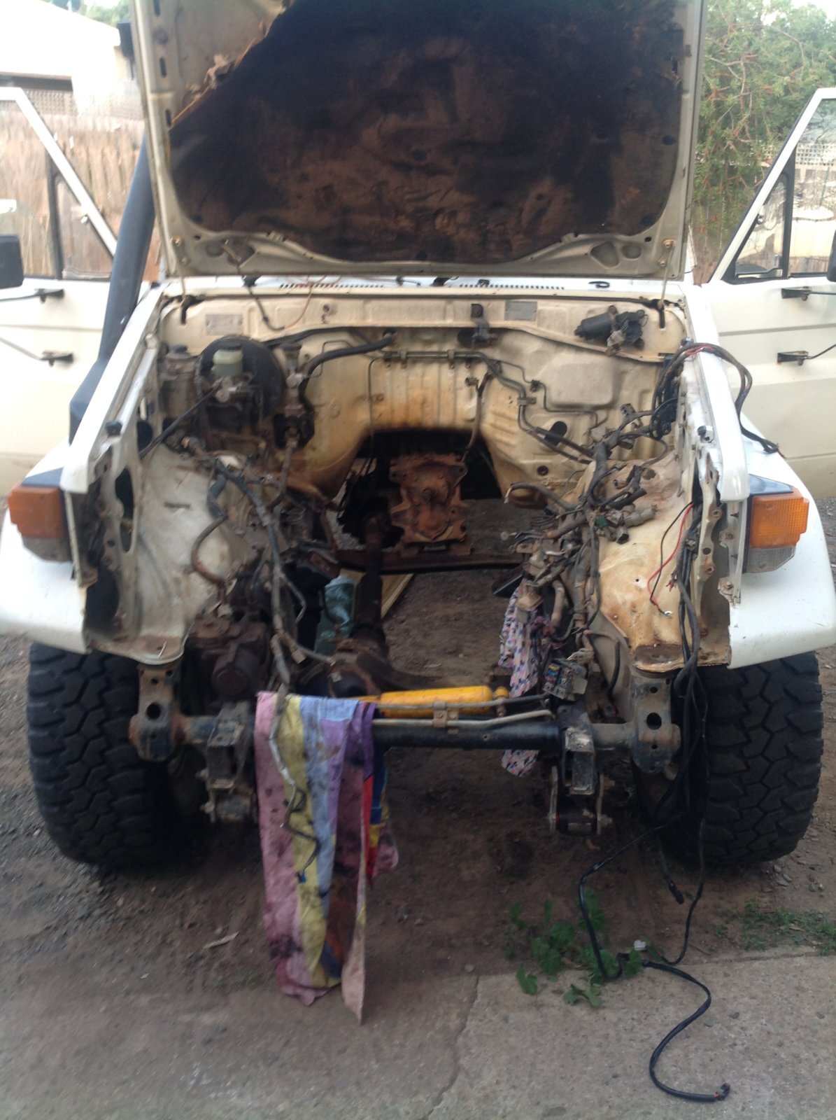

My 92 75 series is getting a heart transplant 1hz with 690.000 kms is coming out and an 03 1hd fte out of a 100 series is going in..
IMG_2921.JPG IMG_2922.JPG IMG_2924.JPG IMG_2925.JPG IMG_2933.JPG IMG_2935.JPG IMG_2936.JPG
Looking good, that is going to transform your truck.
Are you converting the FTE to a manual pump or rewiring and fitting the ecu's?

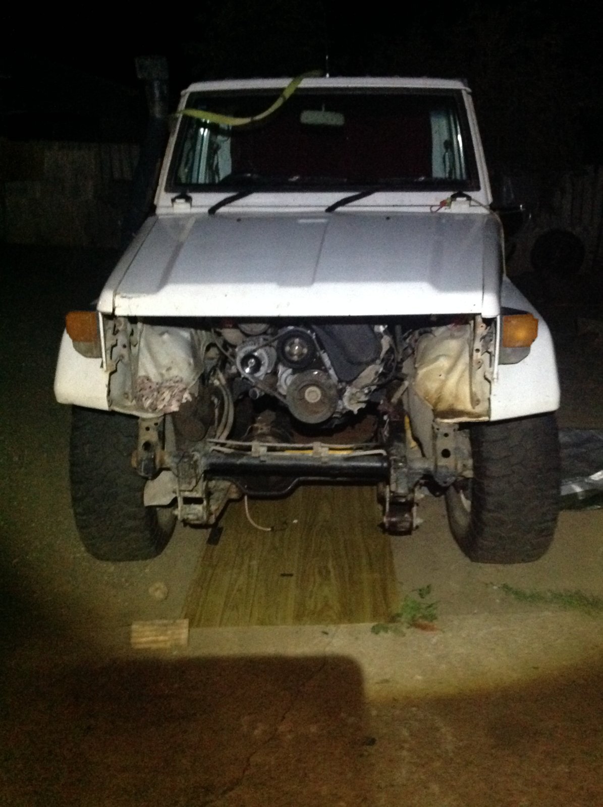

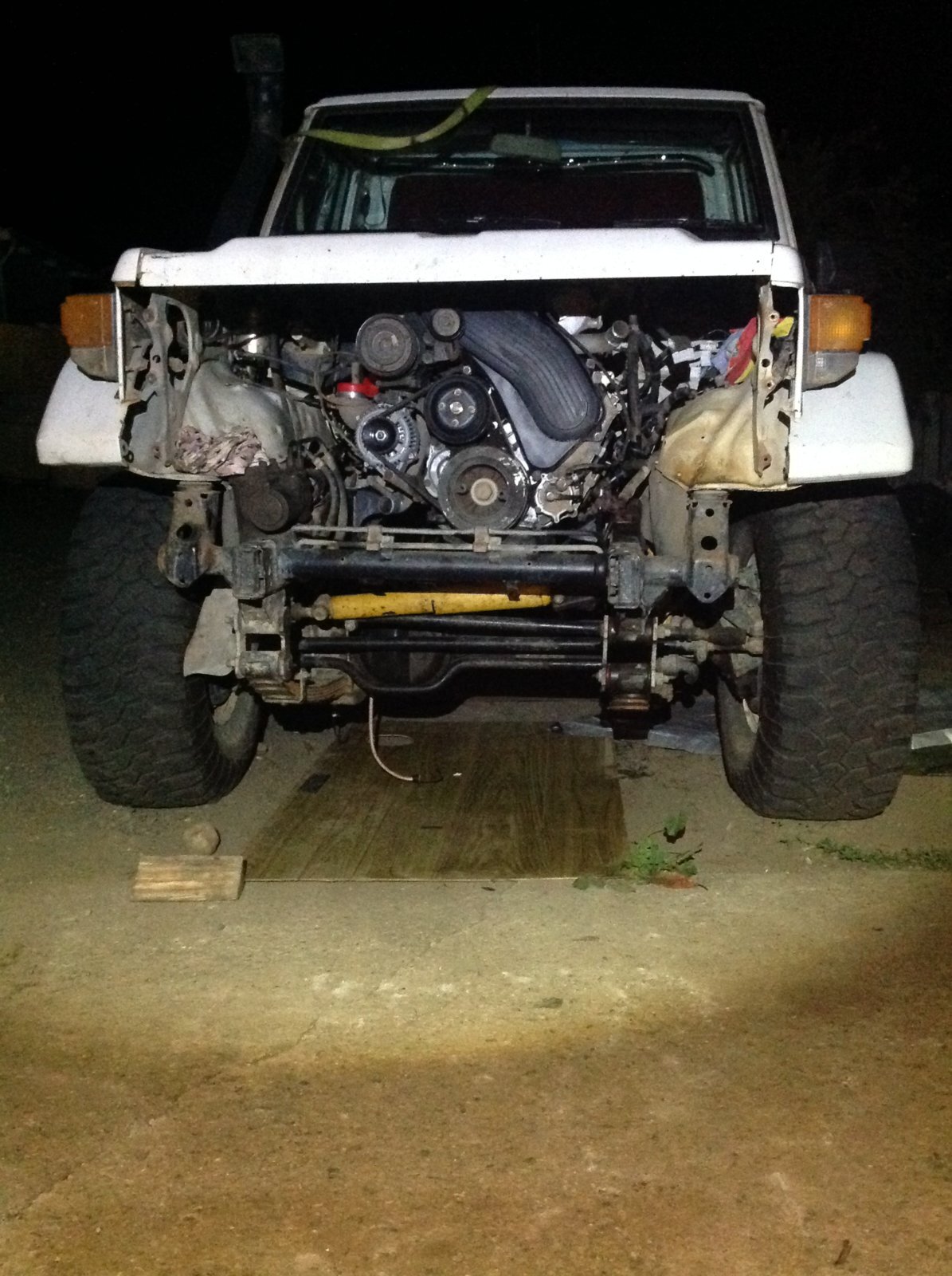

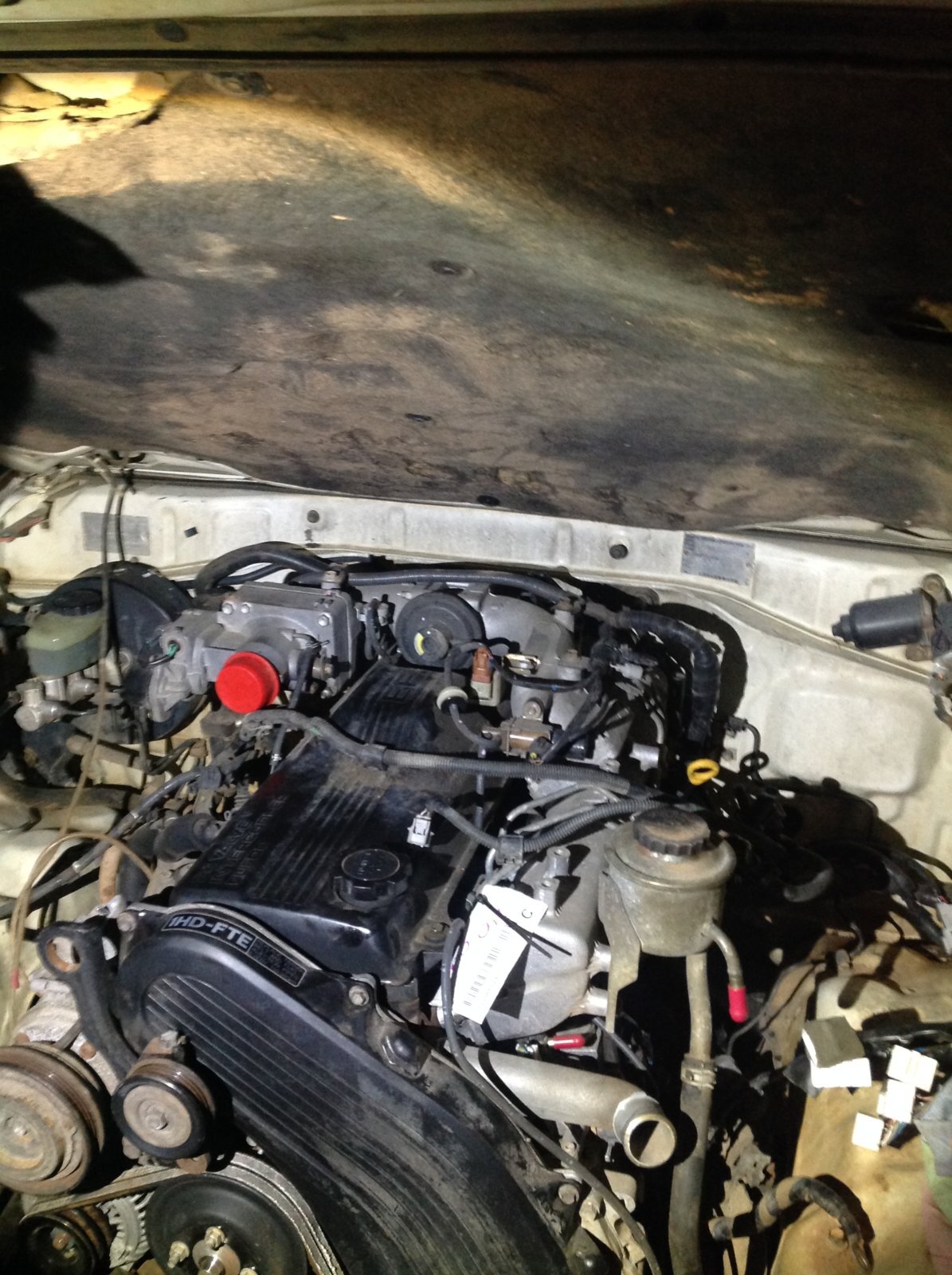

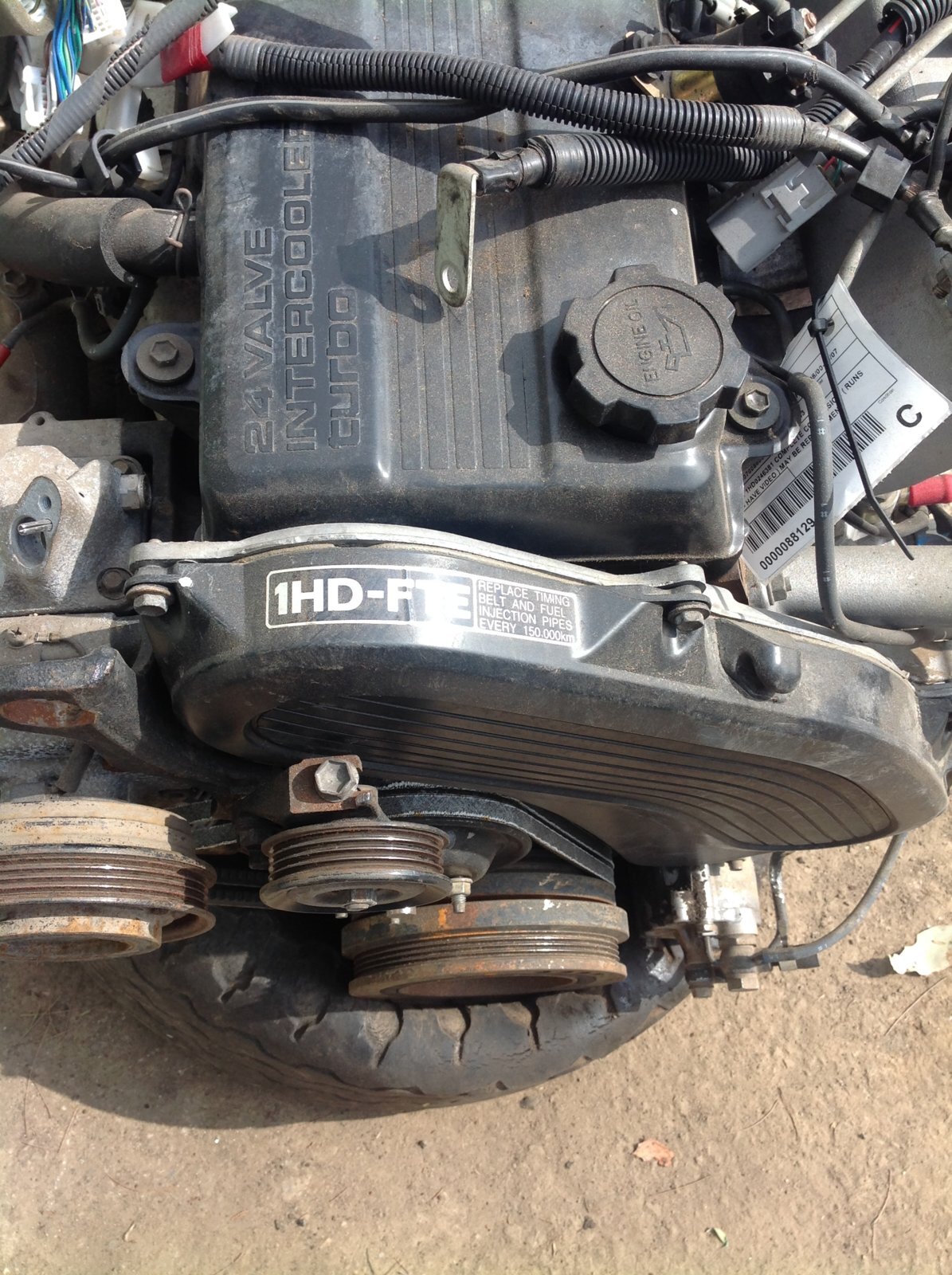

Engines now down and all bolted up. Had to swap flywheel through to bell housing from 1hz as still running my box for now will upgrade that later just want to get the conversion done first. Had to take mounts off 1hz also for it to bolt up correct..
Now for the wiring. Wish me luck lol .
