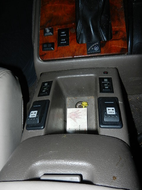

They do look very nice but a little pricey, if you are looking for places to fit switches a good place is on the transmission tunnel where there are, one each side, a couple of plastic thingys to put coins in, pull them out and with a little trimming Carling switches fit perfectly.
