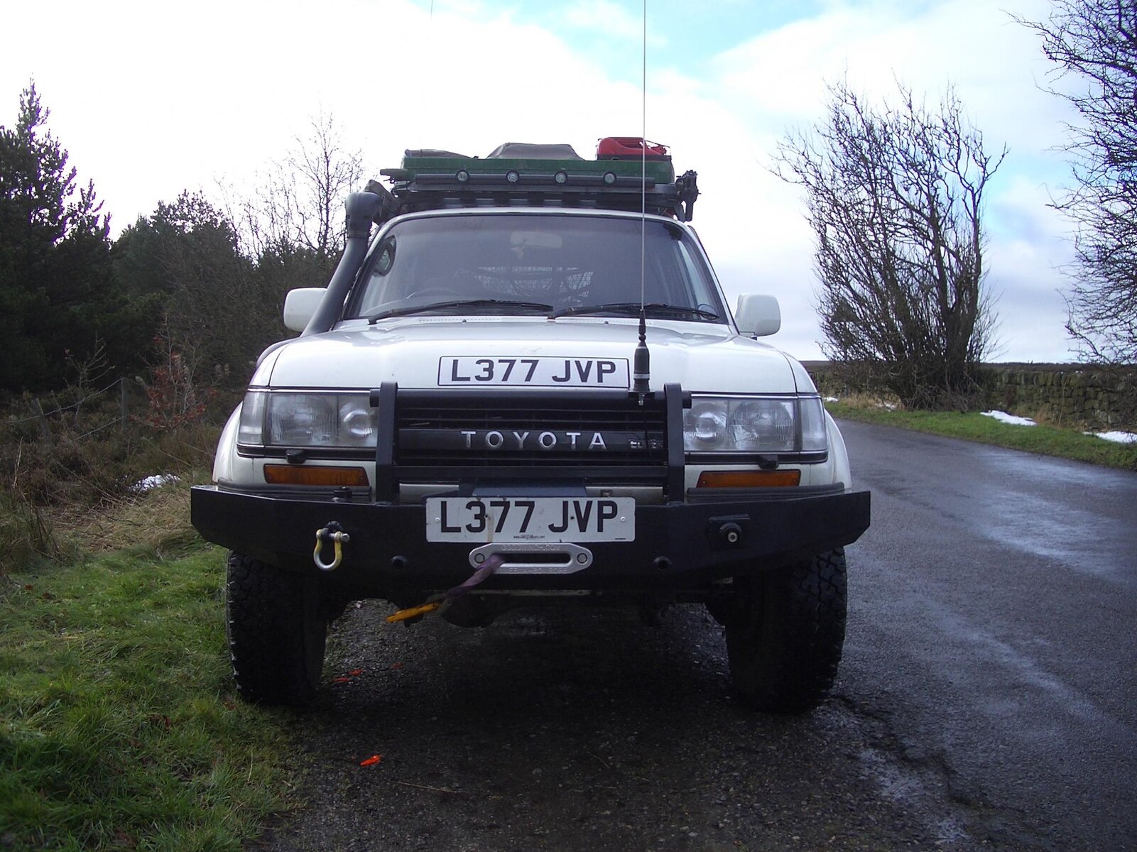

even tho the original was a kinda template it wasn't much quicker as still had to keep making sure would bolt up and angles were right etc etc.
The trick is to built a frame that the original part fits to , then you can tack weld bits of the thing your making to the frame so each part is held in place while you fiddle fix swap and change . The original bolt holes position then always remain fixed .
