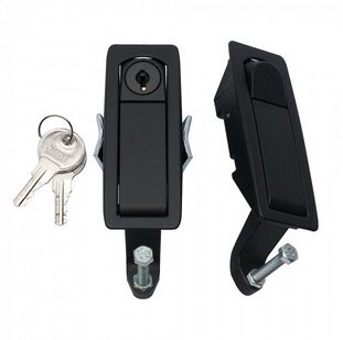

Southco are the people for locks. Not seen the other's that Stu suggests. But I collect these links as they always come in handy.
These flush latches are the sort of thing but they need to be a bit beefier, the adjusting bolt is key to making them easy to set up I think.

Steadles are the importer of these catches and supply most over companies in the country.
Couldn't find straddles but Southco looks interesting. There are a few options for latches. One being Bowden cable operated as well as electrically from inside with the option of an integrated light switch. This would allow for a blank hatch door with the advantage of no leaking through the latch and keeping the door plain looking so less chance of attempted entry. Would this (subject to cost) be deemed too complex for over landing? http://www.southco.com/en-us/r4-em-8
