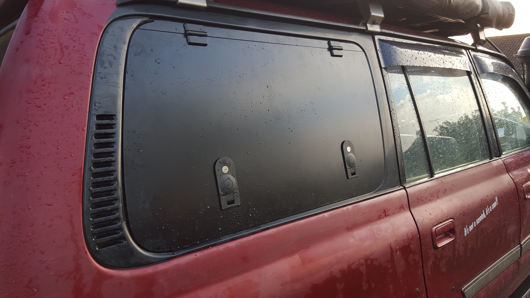

Update time again Gullwing fans. [emoji4]
Chas took a trundle down to see me today and I got his doors all up together and looking nice. Took out his sliding rear windows with very little drama. At this point it all started to go pear shaped. The rubbers he had from Simon Holton were for sliding Windows (suffix 60050 not 60030), then it decided to start raining on us just as I took out my rear window to do a trial fit with my rubbers. Then I find the frame and fixed hinge section has been welded together about 2 or 3mm too low so the whole door sits too low and fouls the lower bodywork under the window.
So, we have learned the following:-
If you've ordered rubbers from Simon Holton, check they are 60030 NOT 60050.
Something (else) went wrong in the fabrication of the frames.
I'm glad I haven't sent any out yet.
I have a cunning plan!!
Sorry (again) folks, I cannot send them out wrong. Now I know they aren't right, I will make them right which may involve dropping a piece of 3mm square rod into the lower part of the rubber to lift the frame up before fitting the rubber to the frame which should be easily doable.
We will win…if it kills me!! [emoji4]
Proof that I was there, this is what my 80 looks like with gullwings and borrowed window rubbers from SG's 80 and what mine will look like soon. :pray:
It may look like a good fit but he's a perfectionist is our Rich.
Looking good, some of the best gullwings I've seen
I've said it before ....dem's mighty fine. OK it's been a rocky road, but they look that absolute Mutts. How much would a non opening set cost? :lol:
Thanks guys. They are getting close and disappointed (understatement of the week for all I'm sure) though I am, I do have a plan, just very limited on time at the moment.
Sorry guys I'd rather you curse me for them being delayed than for not fitting as that's a nightmare for all.
As this is the first sliding window 80 that's had them fitted to, it was a good exercise to see what fitted (or was likely to fit ) and what would be different.
There are subtle differences in the plastic vent moulding, between the window version and the non window. In reality there will be very slight variations in panel gap at a couple of points due to the plastic having different dimensions. We are only talking 2 or 3mm here on a couple of areas otherwise the fit will be as per my non-sliding windowed 80.
