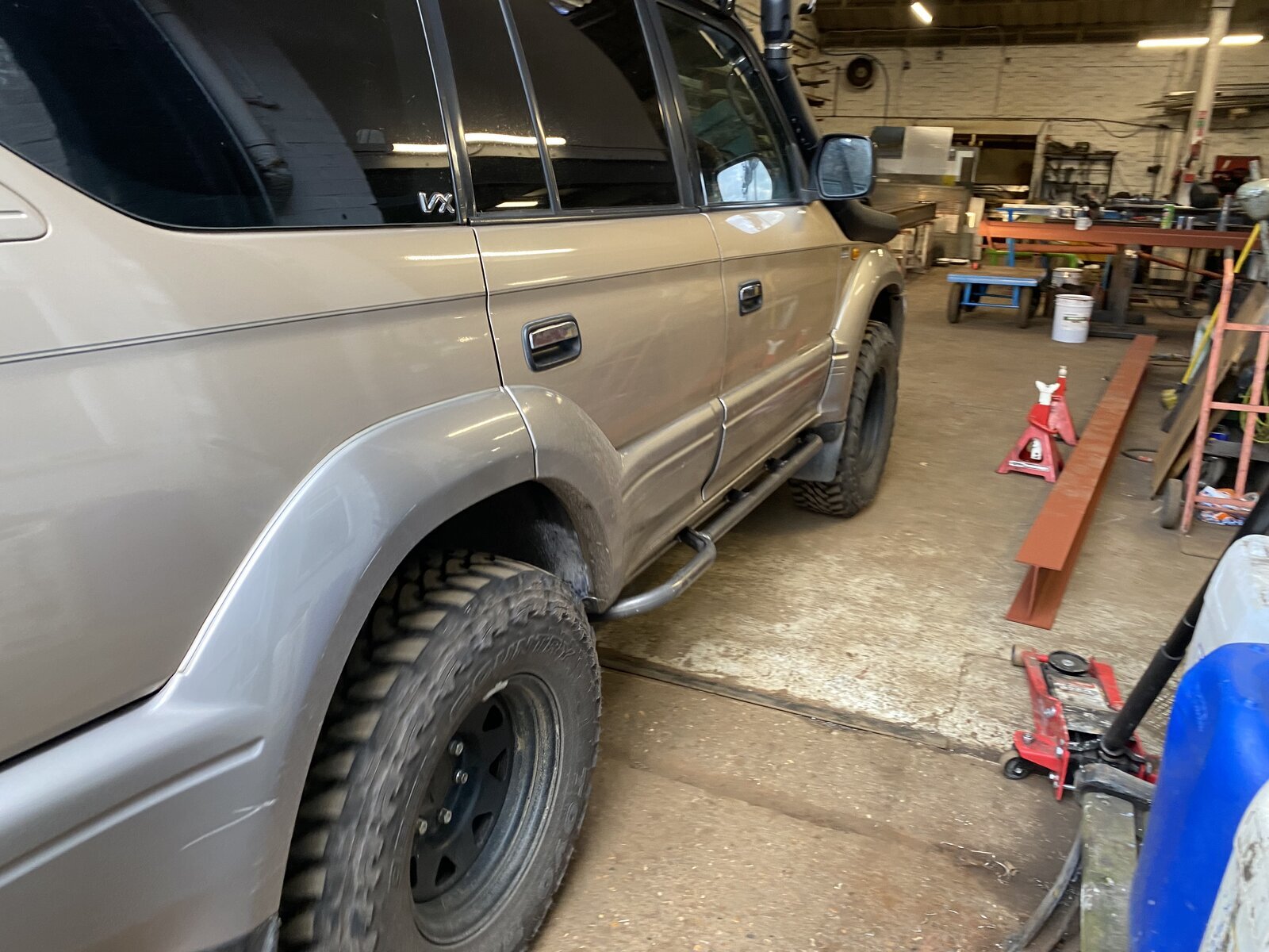

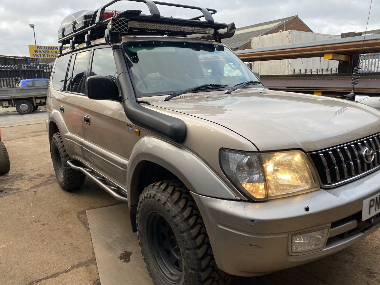

Thought I’d post a quick update on the 90 series sliders. Did the test fit today and all looks good. Going to make a minor tweak to the plates to allow about 10mm adjustment on the height of the sliders.
I should have these wrapped and off to the powder coaters pretty soon.

How do they bolt on, is it to the original side step brackets?

Hey @MisterCruiser,
They bolt onto the chassis rails using existing holes and a captive style nut. I’ve had them on and tested them but found they flexed a bit more than we wanted them to when lifting the vehicle with a jack on the sliders.
You can’t really use the same style of fixing as the 80 and 100 series unless you’re running a body lift so im doing my best to make these fit a stock vehicle. As such I’ve got another idea for a cradle that will hook over the chassis rail and the clamp through a couple of existing holes on the chassis rail. This should hopefully be beefy enough to allow the full weight of the vehicle to bear on the sliders without it flexing into the sill.
I’ll have this done in Jan at some point and hopefully have the test fitting done by the end of the month.
