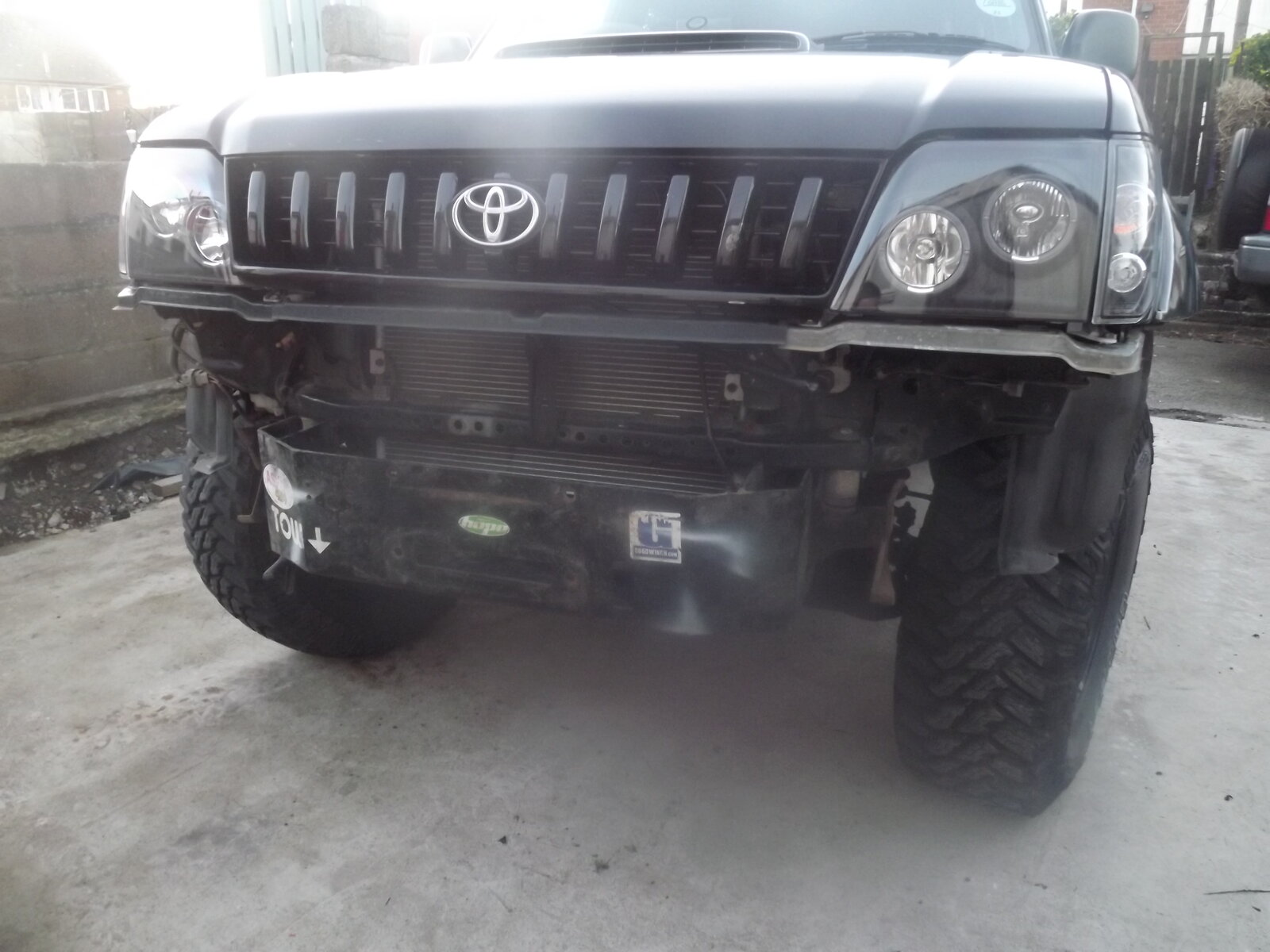

Not much room for a winch in the 90 series and unlike the 80 the headlights more or less meet the bumper they and the grill are supported by a not very strong bolt on bridge , the bumper slots between the two .
Altering things so it bolts on should not be difficult it's the little things like how it will meet the arches , will the winch mount need moved as well and so on and so forth .

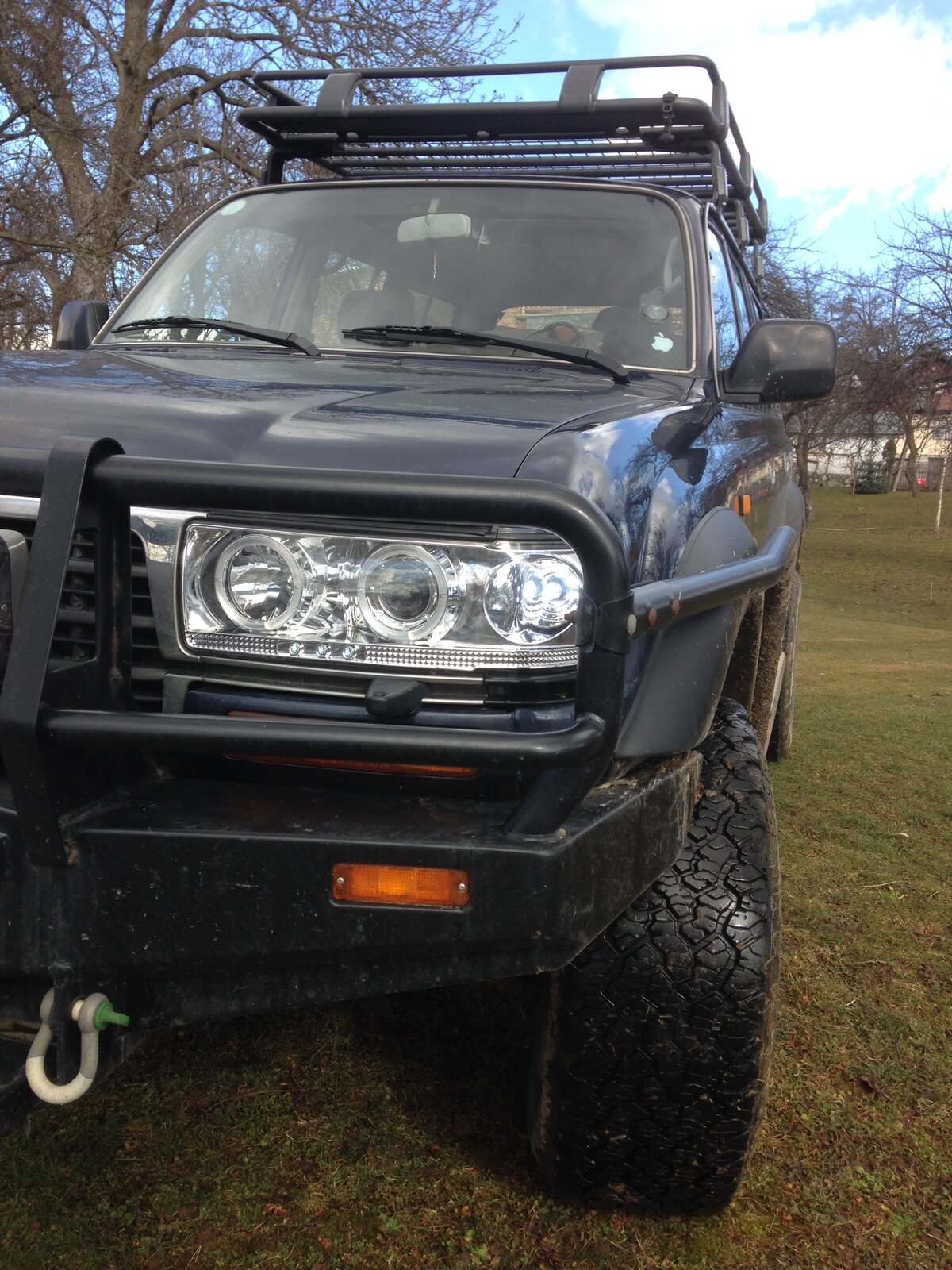

I wouldn't quite go that far.
The dimensions are at the widest point. On my 80 the width at the headlamps must be less than the widest point, but the truck has quite a square profile on plan view.
Whereas, I think the 90 tapers in more to the headlamps. I may be wrong, but I wouldn't want you to spend good money on an 80 bar to find that it looks like some apocalyptic Mad Max machine like some of the Utes down under.
That's why 90 bars are narrower IMO, to suit the truck better, not necessarily because the 90 is narrower at its widest point.
JMO
If I may add, I also think the profile will be different. The 90s headlamps are angled, whereas the 80s are almost flat. An 80 profile bar is likely to be much flatter than a 90 series. I think you should take great care here, before you waste your money on something that's going to look quite odd. Also, many 80 bars have a horizontal rail below the headlamp.
It's likely that this will strike a line right across your 90 headlamps. I think Shayne made a reference to this back up the thread. See...
The 90 headlamps are deeper and the bullbar is likely to cast a big shadow.
