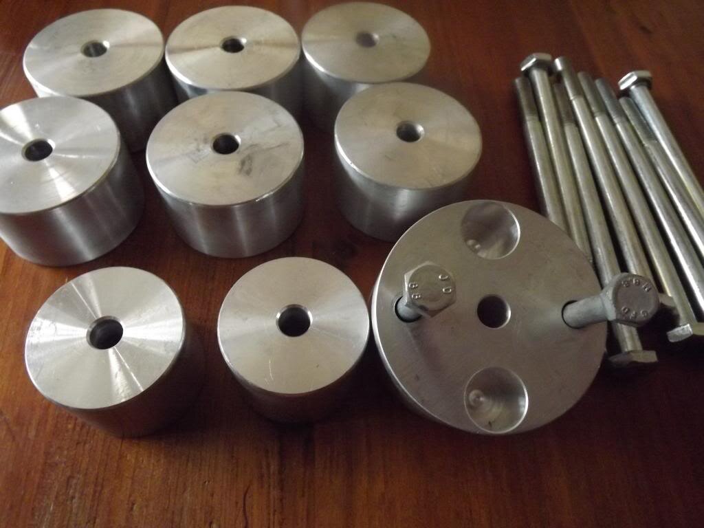

Body lift is fitted and i have mixed feelings about it , i'm thinking tyres need to be bigger and my once extremely light steering is now much stiffer . I've heard this can cause problems but i can still steer with a finger and thumb gripping the wheel so i'm just gonna hope ,without much sincerity , it frees up a bit with time . Front bumper will need some tweaking to fit properly as will the back . Gear and diff stick are fine as i only went up 40mm and so is the rad though the fan guard will need some brackets made up before it can be refitted .

Believe it or not Andy the lift only added about an inch but visually the change is dramatic .
Mind you following the instructions kindly recorded by Chris i noticed my truck differed to lil blue as his body was sat directly on the chassis (if i recall correctly) and kinda glued with some sort insulator perhaps to dampen vibration or sound . Mine was was sat on rubber pads and required no "unsticking" so to speak , only the bolts held it in place .
Perhaps this is why i managed to fit 285/75 coopers right from the start without any lift at all ?
Yes mine was gummed together with foam but it wasn't actually sitting on the chassis as such. I would have another look at the steering Shayne. I know what you mean about it being tighter. That is essentially binding. I'd slacken all the grub screws off on the slide joints etc and give it some lock to lock stuff to try and settle it. If it slackens off I'd suggest that that was wear somewhere. It shouldn't be like that. Mine was and I got it back to original. I think the Milner spacer is perhaps a little too thick. Also you do have to watch the spigots on the rag joint aren't binding inside the spacer, but that's probably included in the fitting guide. It was written a long time ago.
Chris
Yeah cheers Chris i been thinking about it and as its tightly bolted together it stands to reason that it can only free up by wearing out other components . Do you think it would help to slacken everything and do a few figure of 8's in a carpark somewhere ? . I can't help thinking the longer bolts plus the larger hole in body spacers might very easily allow the body to sit a good few mil off centre so when you turn the steering it is effectively trying to compress the steering spacer if you get what i mean .
What i meant about the rubber pads on chassis is i effectively had around a 10mm lift already on the truck from new straight out of the factory . The new 40mm spacers make these pads redundant so i ended up with a 30mm lift from a 40mm spacer .
Is it possible Milners have failed to consider the redundant chassis/body damper while producing the lift kit ?
As i said earlier the 40mm lift actually gave me a 30mm lift so surely the steering spacer should in fact be 30mm . I can't hope to file that off !
Shayne, I actually think the binding is in the length of the column. There are tow? slip joints from memory and originally I didn't have a spacer. I jacked it up and the steering was really tight. I undid the joint by the exhaust and PING it really went. This is when I got a spacer sorted. I bought two different lengths and used the shorter one. The other I gave to Milner who made copies but I did tell them to make it shorter. I don't know if they ever did that. So the chances are that the column is now a bit too long. Every vehicle is subtly different you know. As the slip joint gets set at the factory and rusts in place, there is a good chance that it won't take up all the play in the system. I moved mine, cleaned it, greased it etc until it was really free. Really, if you had time and patience, I'd say clean all that then measure the max and min gap at the rag joint pull pulling and pushing the steering rod in an out. Then take the middle point of that and machine the spacer to the right thickness. A 40 mm lift doesn't equate to a 40mm shortfall in the rod. It's a diagonal isn't . Think of a square. 40mm square isn't 40mm corner to corner. Too short is a problem but so is too long.
By the way, the truck looks phenomenal.
Cheers Chris ,
I realize all trucks are different but all have a space created by the factory damping whichever method is used , and all steering columns are equal in length so i would assume the spacers being 10mm to big is reasonably accurate , the age of the trucks and inherent wear would prob make a 32mm steering spacer ideal don't you think ?
I guess the quickest way forward for me is to jack it up again , remove the steering spacer , tighten the body spacers , measure the gap and get the steering spacer machined down to size .
You don't need to jack it up to get the spacer out. You can just undo that lot and remove it. Slacken the joints in the rod and then measure up the min and max gap. But first just make sure that the slip joints are fully moving or you could be wasting your time.
But I know that lots of people have fitted this kit and some have had problems and some haven't. It won't be much out I am sure, but the slight differences from one vehicle to the next could be sufficient to create a problem for some.
Not sure how a 40 mm spacer block can only give 30mm lift thought. That's against the laws of physics. The body HAS to be 40mm more off the chassis now. The measurement at the arch to the tyre isn't necessarily reflective of this because of all sorts of other things.
Sorted and much ado about nothing i'm embarrassed to say . You were right Chris with the slip joint , i loosened off the lock nut when i unbolted everything to fit the steering spacer but i didn't actually check it was free assuming power steering would easily shift it . This time with the spacer out i gave it a tap with a hammer and oiled it so it offered no resistance to sliding at all . Sat the steering spacer in place then tightened all the body spacers again . Then tightened the steering spacer bolts - drove the truck around the block , then tightened the the sliding joint lock nut .
Still i agree with your opinion the spacer is too big , the slider cannot go up any further so maybe you should suggest again to Milners they trim 5mm off .
