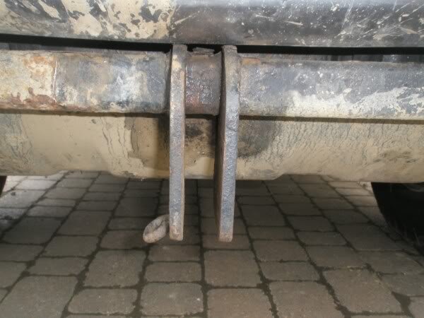

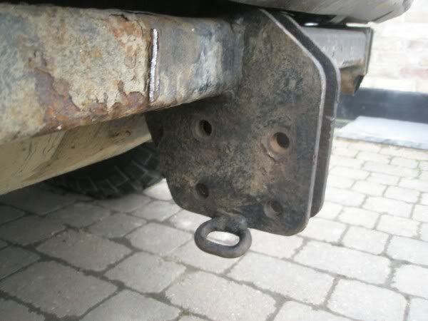

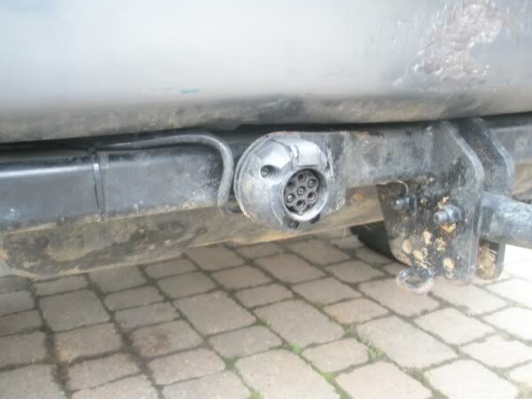

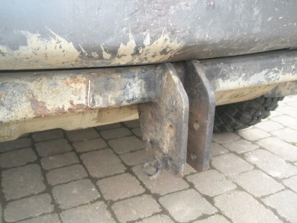

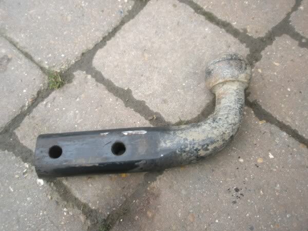

Well, when I first bought Fiery I had an asperational list of mods that I would like to carry out :mrgreen: I'm sure you know the kind of thing :D In this list was 'Buy & fit an ARB receiver hitch towbar' or @ least make something that resembles one. After much searching, a number of phone calls & much time stood @ the back of Fiery slowly drinking a cup of tea contemplating this modification & its costs not only in terms of wonger but time aswell :!: I'd prety much descided just to trim the bottoms off of the two towball swan neck mounting flanges flush with the base of the swan neck bar (a mod suggested by a very wise man I met once @ the junction of the A12 & M25) and then just use a shackle to small to pull over the 50mm towball to attach strops directly to the towbar for any recovery work. But I then went on to think that if I could just get my hands on a bit of steel the size mentioned for fair monies. It would be nice to make a bespoke shackle attachment bar that I could bolt up in place of the 50mm towball swan neck for when I'm out playing :mrgreen:
Had another measure of the swan neck towball that I've now removed from Fiery & it's 29.7x44x200mm :) So a piece of solid bar 30x50x200mm would be great if anyone could help me out :thumbup: :D

I'd ditch the whole rear member on that for play time. In other words like a very wise man from near Kidderminster, have a standard one and a modified one. Reason I say that is that the bit that is left acts as a plough. All towbars do really and on a SWB when climbing, the angles involved so often mean that you get hung up on it. Even with a receiver you get caught.
I hear what you're saying Chris :) To be fair though I tow my little ol' P6e trailer more often than I go off roading :| So I'm going to do the best I can with what I have :D I don't really need to make the 'D' shackle attachment as I do have a good sized shackle that fits around the swan neck below the towball & once the pin is fitted is going nowhere :) :thumbup: But it would be nice to have a bespoke shackle attachment if anyone finds a suitable bit of steel :D ;)

Yes & yes I'm affraid :) Infact so is the 50mm dimension :) The dimensions of the OME towball swan neck are 29.7 x 44 x 200mm :) Please don't go to any great lengths to precure a bit for me, this was more just if someone had a bit to hand that they wouldn't mind selling on or if anyone new of a supplier that I could contact :) But thanks for having a look in advance :thumbup:

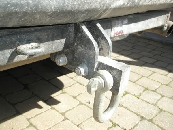

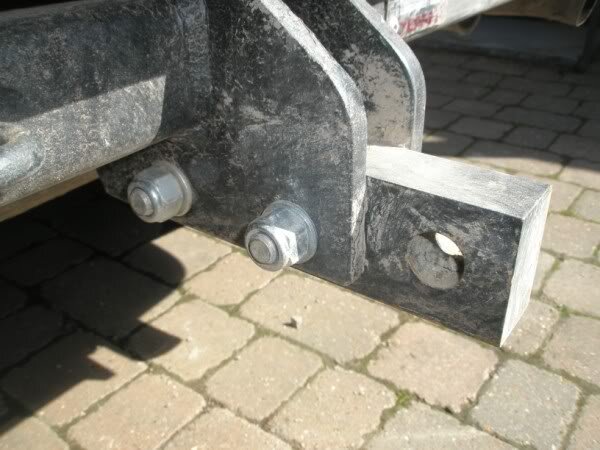

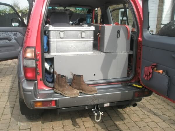

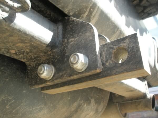

I got that bit of steel I was after & so moded my tow bar :D
Before
And after
