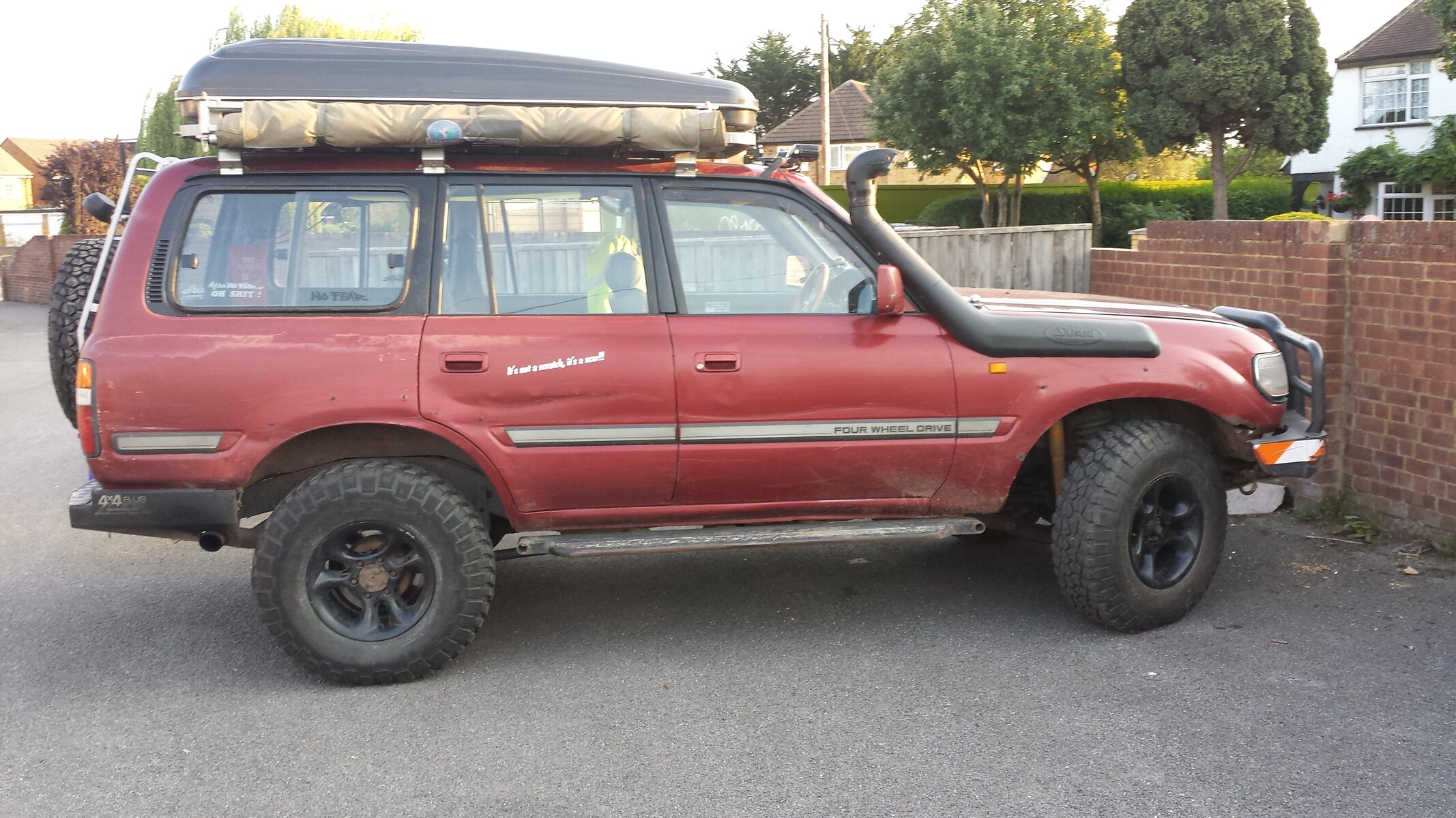

I'll have a set soon, I have some new rims I will be getting some Cooper STT Pro's for and my existing wheels and BFG tyres will be available, I think the tyres are 265/85/16. I haven't thought of a price yet but PM me with an offer if you're interested.
These are the wheels and tyres.

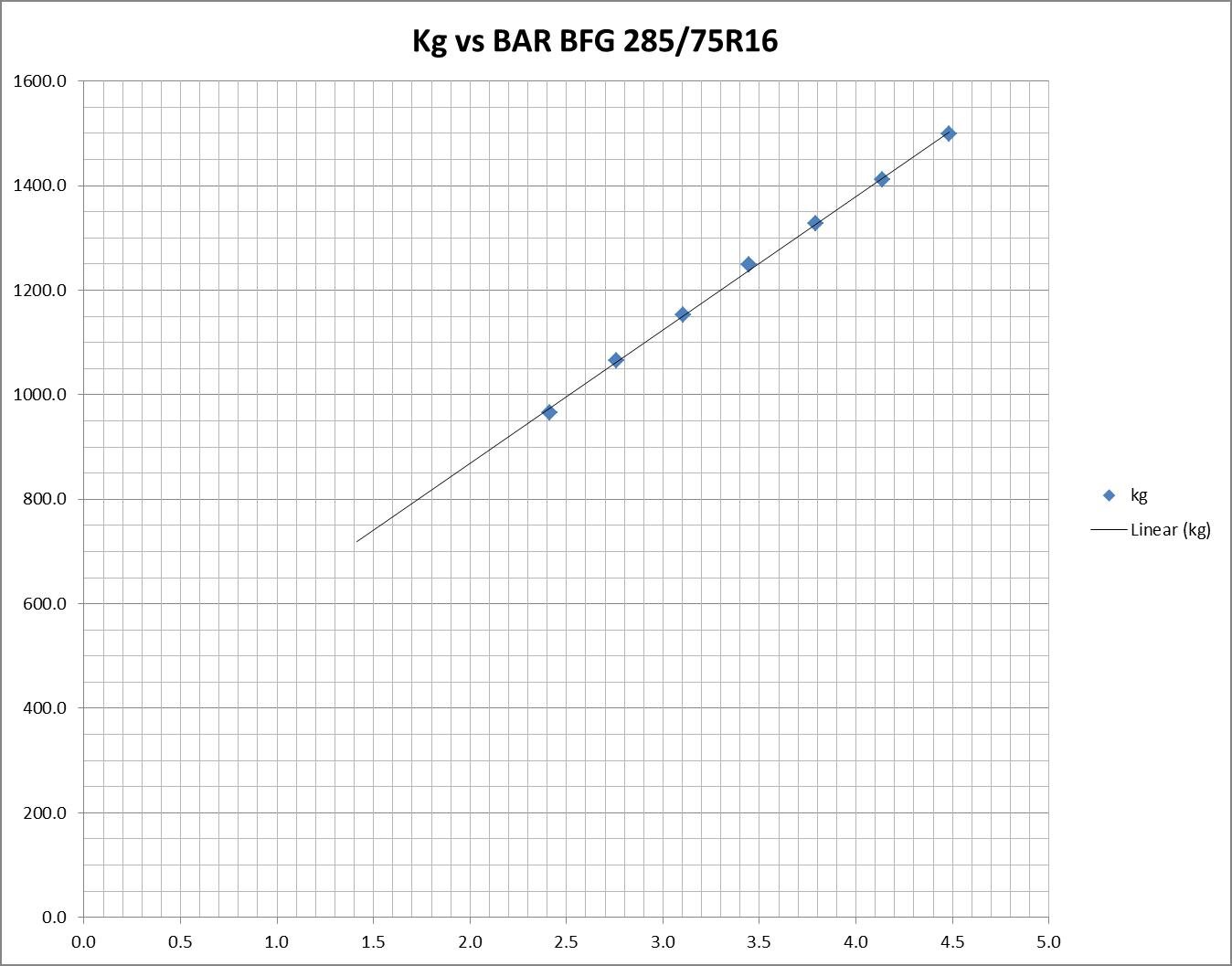

T1pper - I came across the data in the chart below - I can't find the original source so you take it at your own risk - but I think it was a professional table. As you can see for higher pressure ranges it has a linear range of kg vs BAR. Note that other tyre sizes/manufacturers will have different data. For my expedition loaded truck this chart suggests 2.4 BAR on the rear and about 1.8 or 1.9 BAR on the front. I have been running my fronts at 2.4 BAR and they feel a bit over pressured and seem to spin a bit so I'm going to put these back close to the OEM pressures + a bit - 2.0 BAR. I can't see that the linear relationship extends down in any case on the graph as the line has to get to zero somehow. At the rear of the truck with 2.5 BAR the tyre looks properly inflated. Of course for low-drag extensive motorway driving it is normal practice to put a bit more air in any way....although not actually recommended by Toyota.....and neither does it recognise that heavier rear loads warrant a bit more air.
Running around with 2.8 BAR in the fronts does look like it would be overkill - even with a bull bar and winch the net impact over the front axle is less
The weights are per tyre - half of the axle weight
