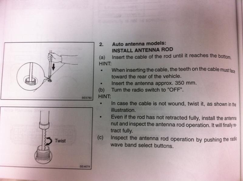

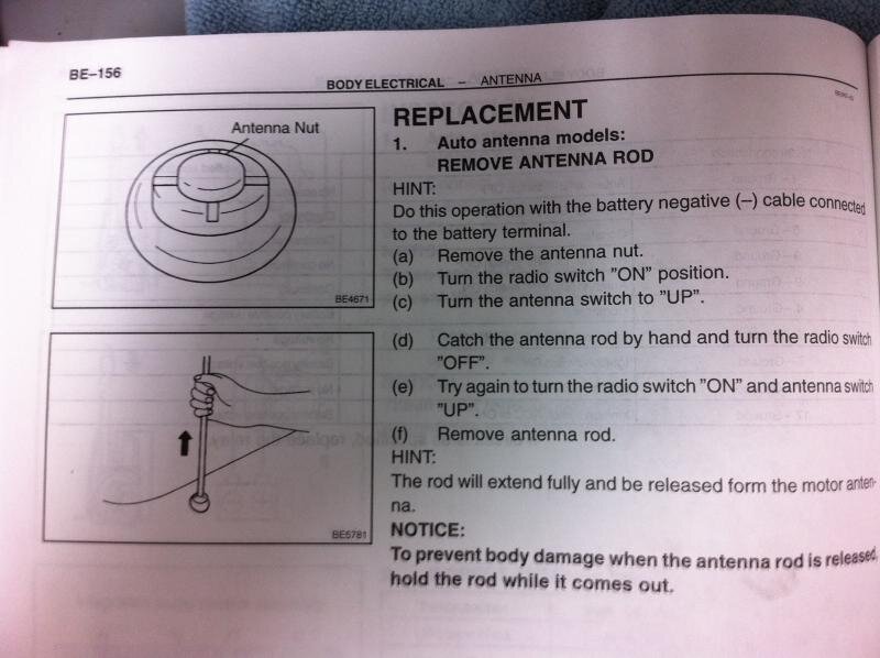

My LC antenna mast has been snaped off since I purchased the car, I still hear the motor running as I turn the ignition on and off however the remaining stump of the mast remains stationary.
I have not yet priced a complete Toyota assembly but I fear it will be "prohibitively expensive", I have seen that the mast itself is sold seperatly from the rest of the antenna assembly.
Is it easy to swap & any advice before attempting it.
Somebody on ebay is selling the replacement item with I think the correct part number he has sold about 85 anyone on hear fitted one?
