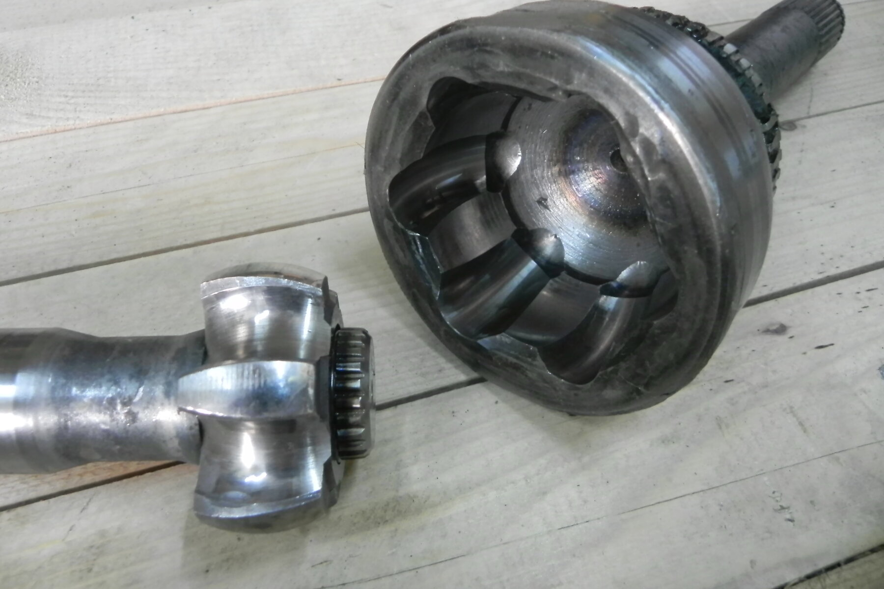

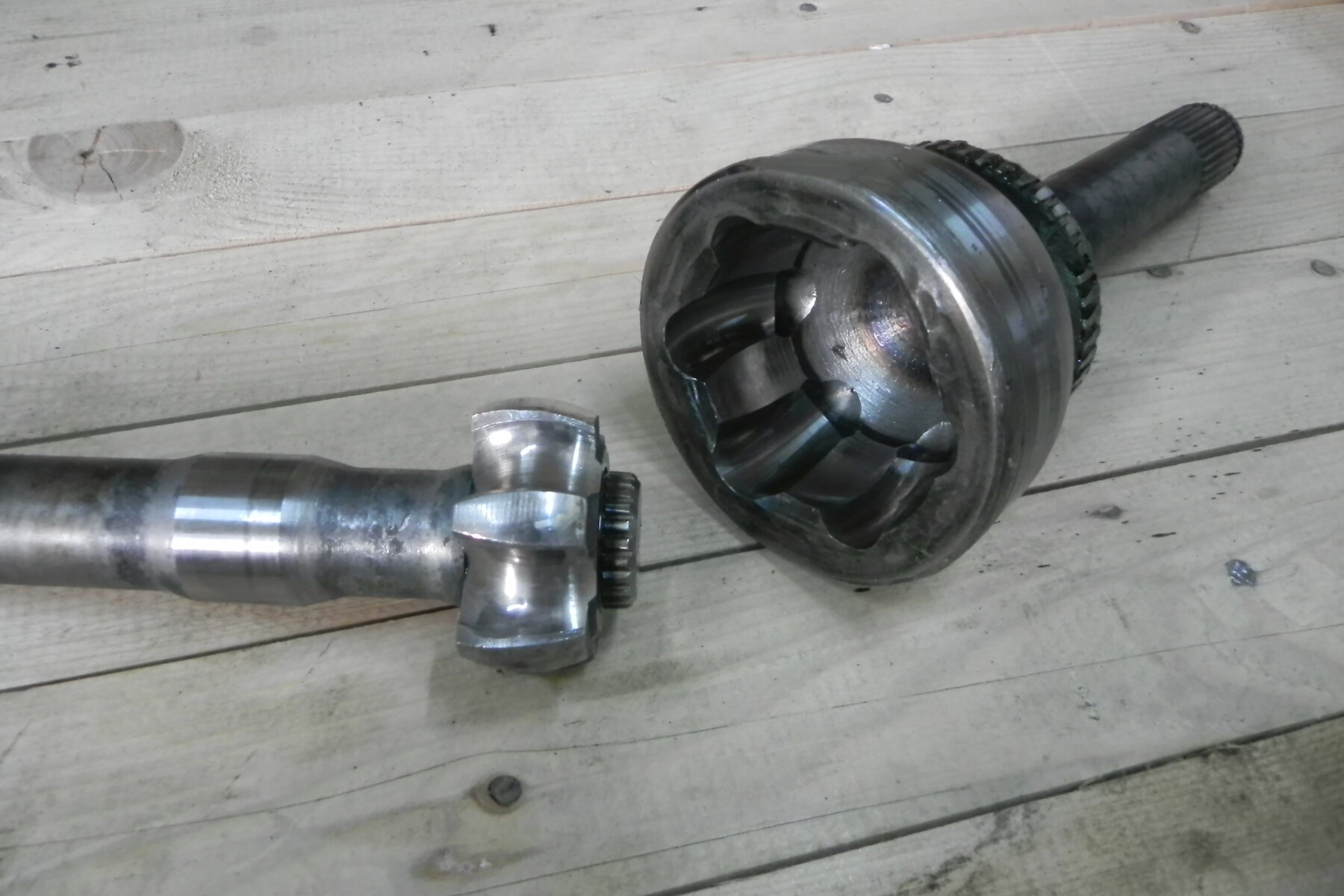

Just to close this out, here's some pics of the shafts that were replaced...

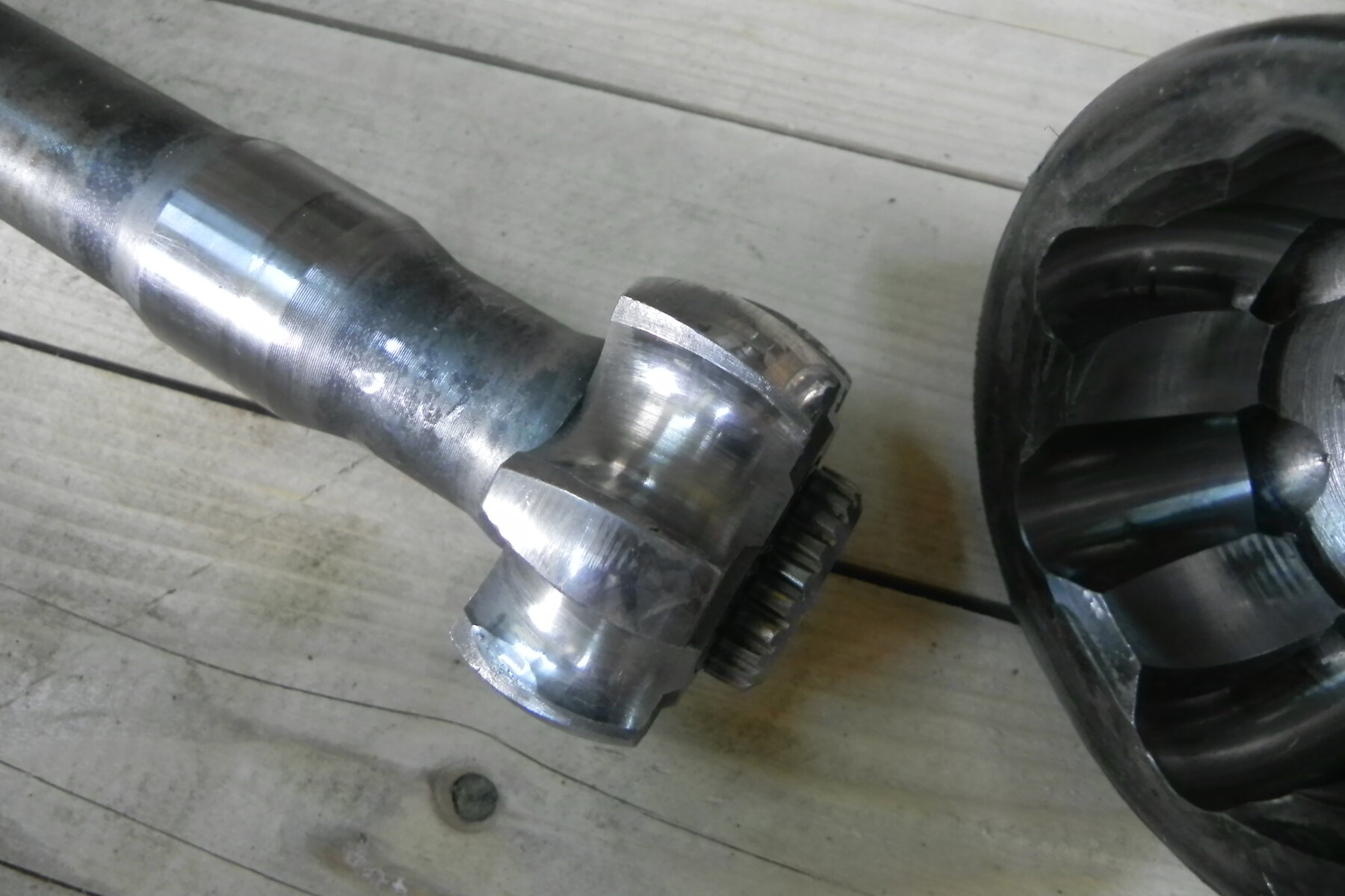

The failed Birfield, I don't have the failed cage or the ball bearings to see what state they were in, but all the damage I can see is the aftermath damage following the cage disintegrating and all the balls falling out. The Birf inner is loose (rotationally) on the shaft, damaged by tumbling about inside the outer race, no doubt. Otherwise, it looks in good condition to me :think:

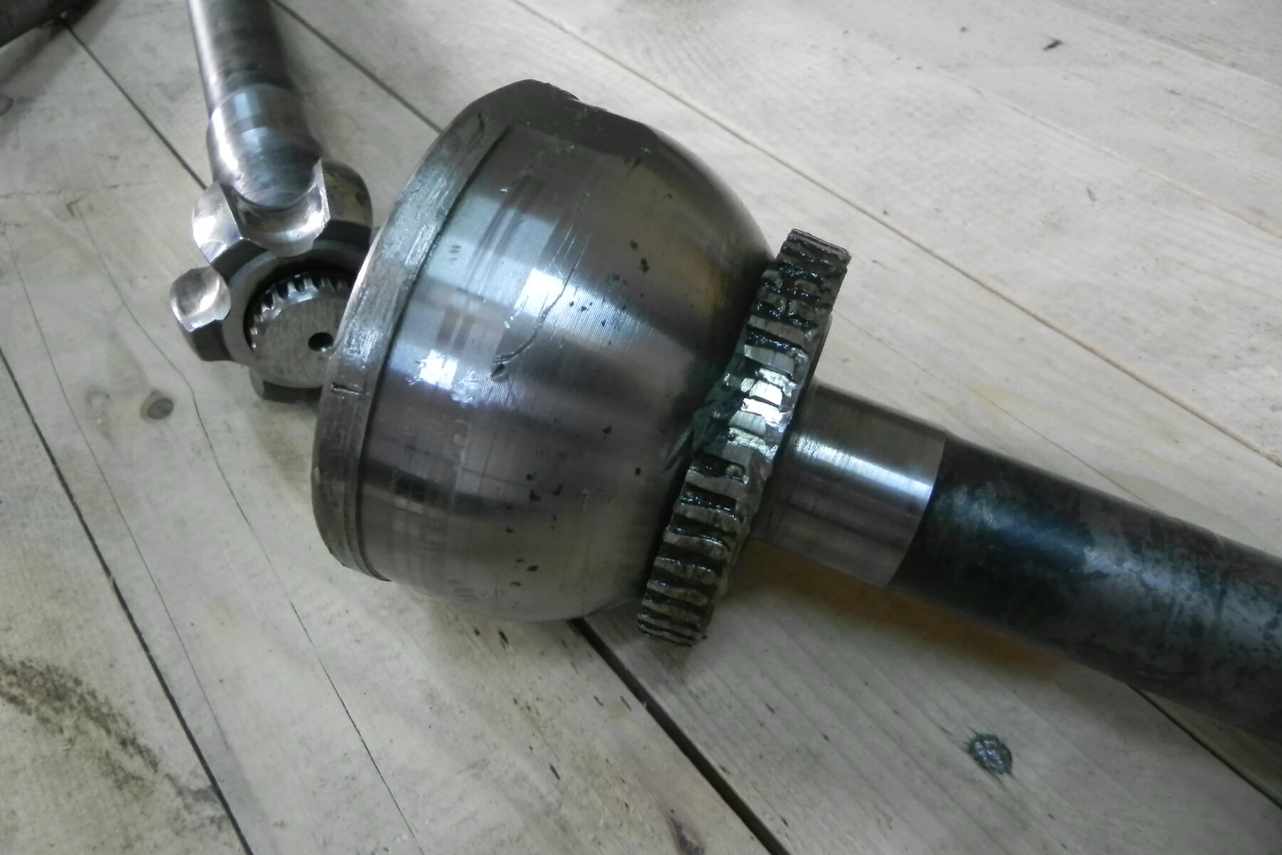

The ABS sprocket is mangled, (no ABS on my truck anyway) probably by ball/cage debris.

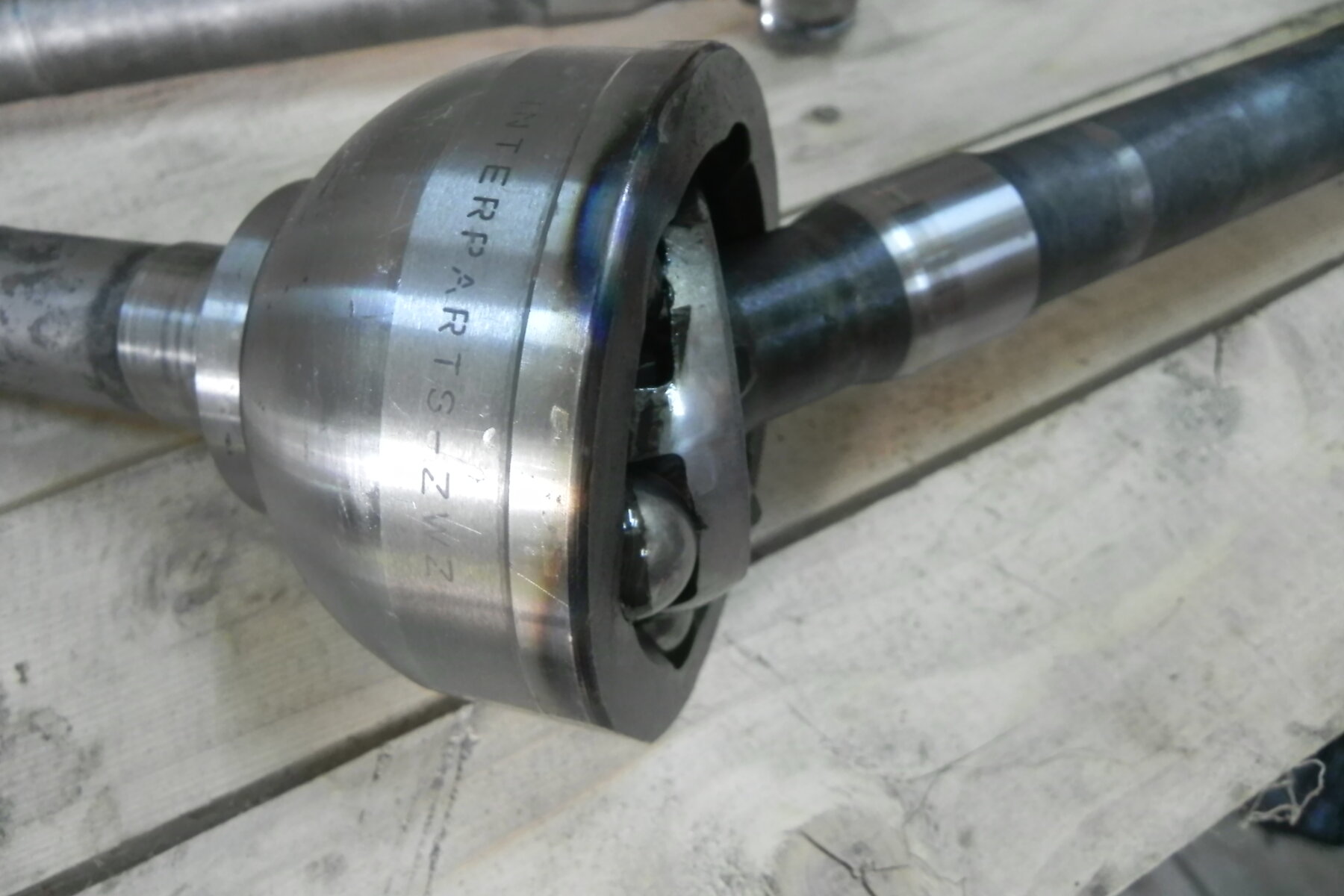

The other side, the long shaft...
Still looks good to me, but I didn't want to take any chances.
