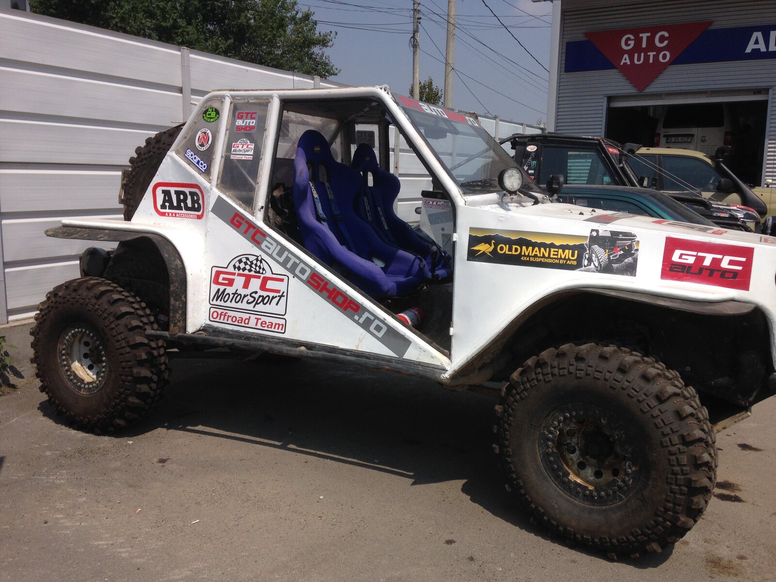

Some photos of your man's comp trucks required when you get a chance old boy :whistle:
I'll try to get some Gav! He's got the 70 and a couple of 80s, but the 80s are difficult to recognize...

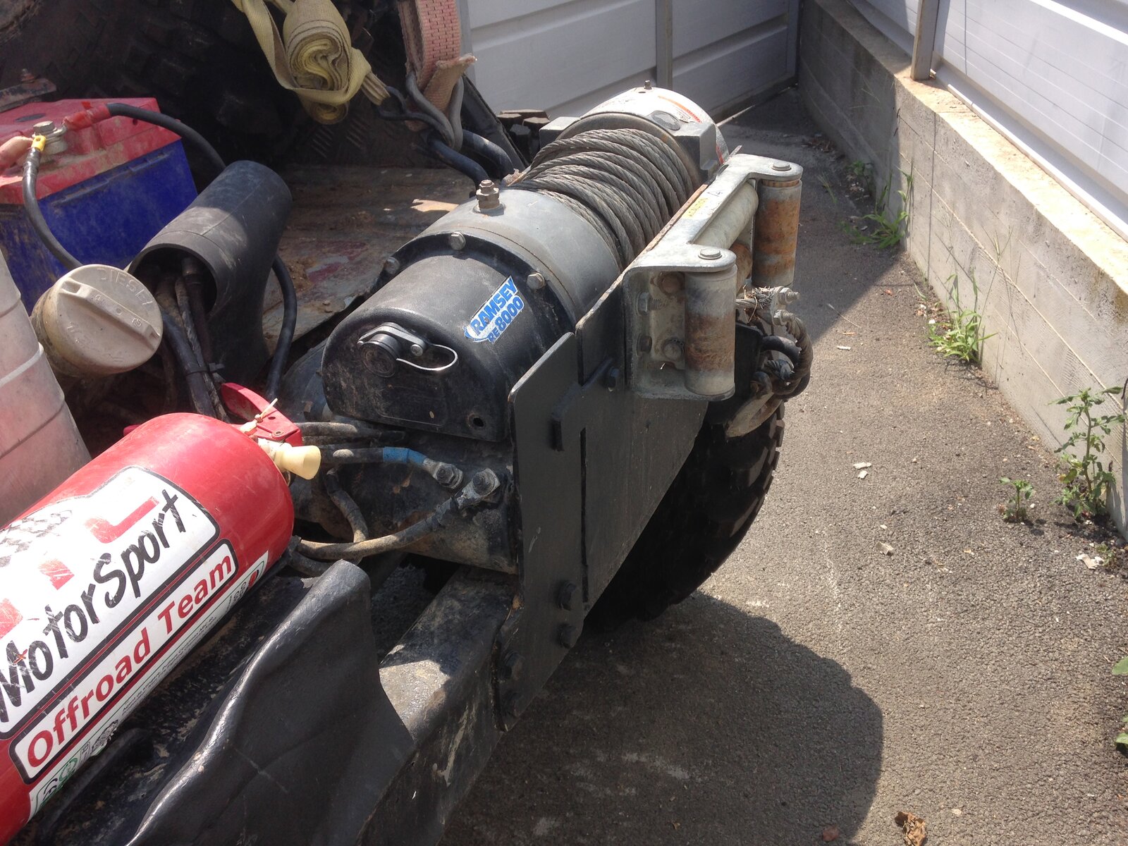

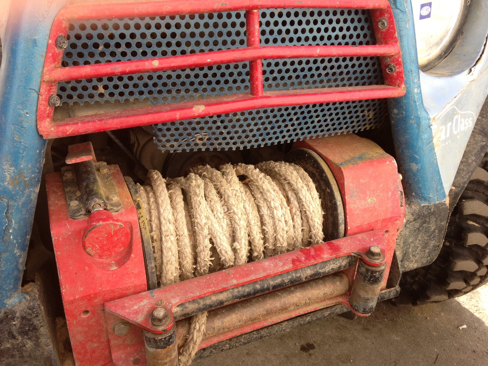

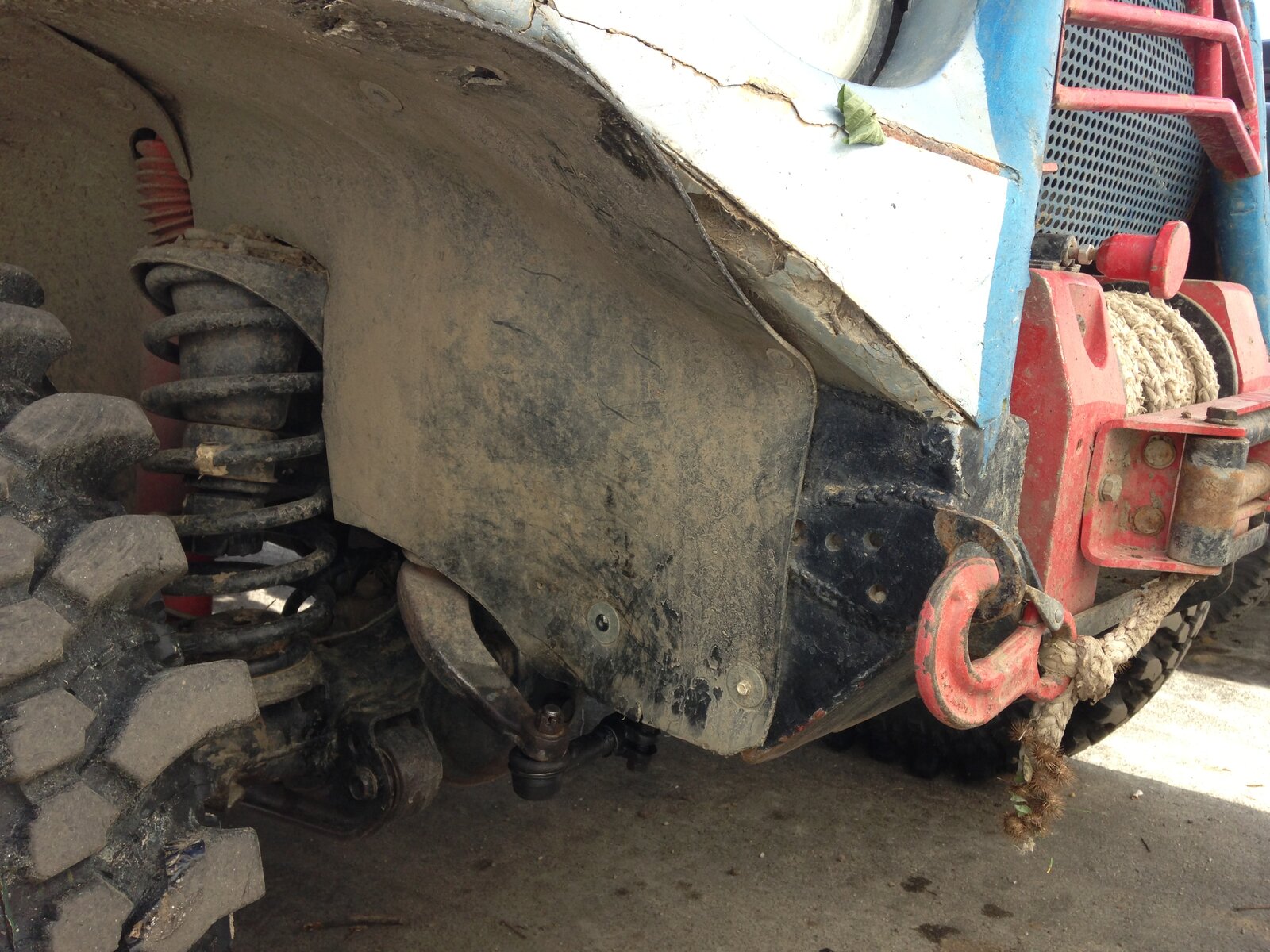

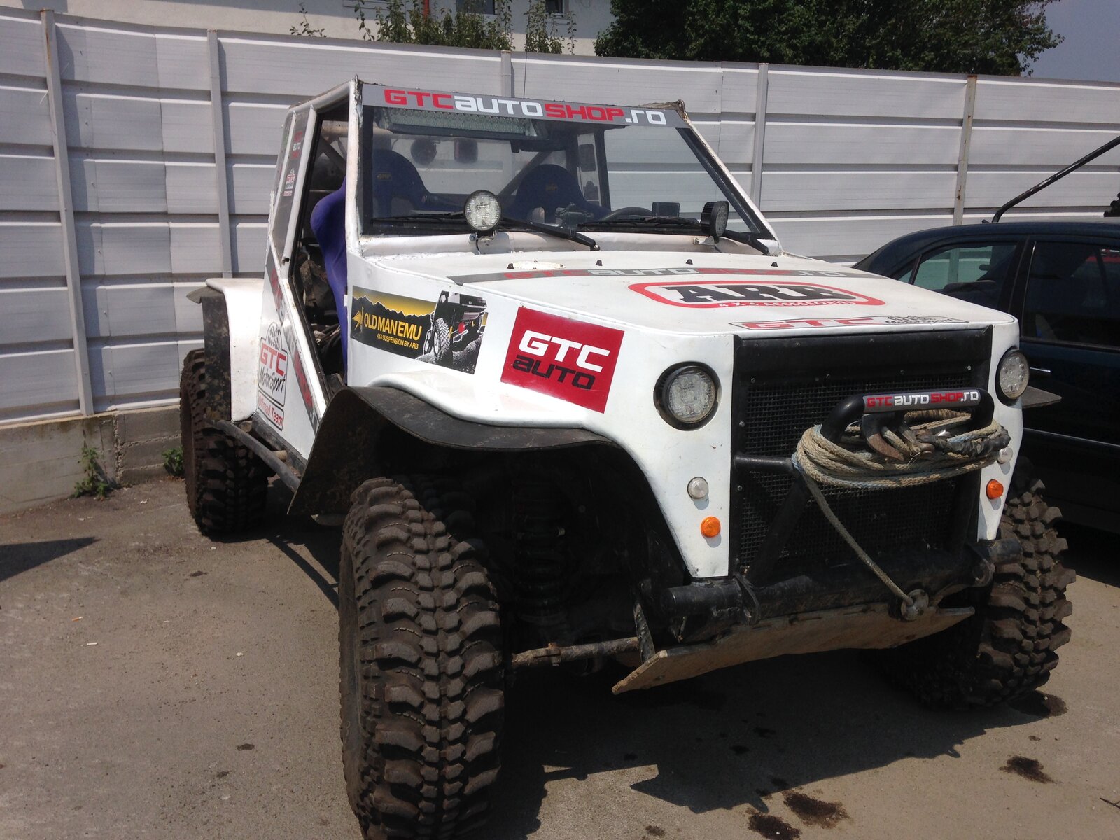

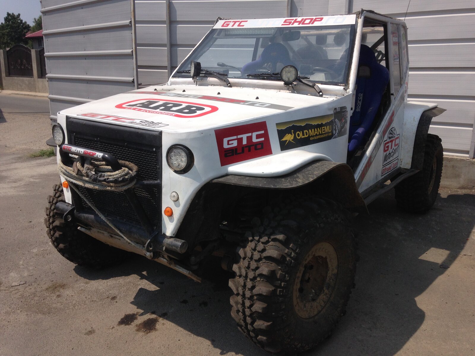

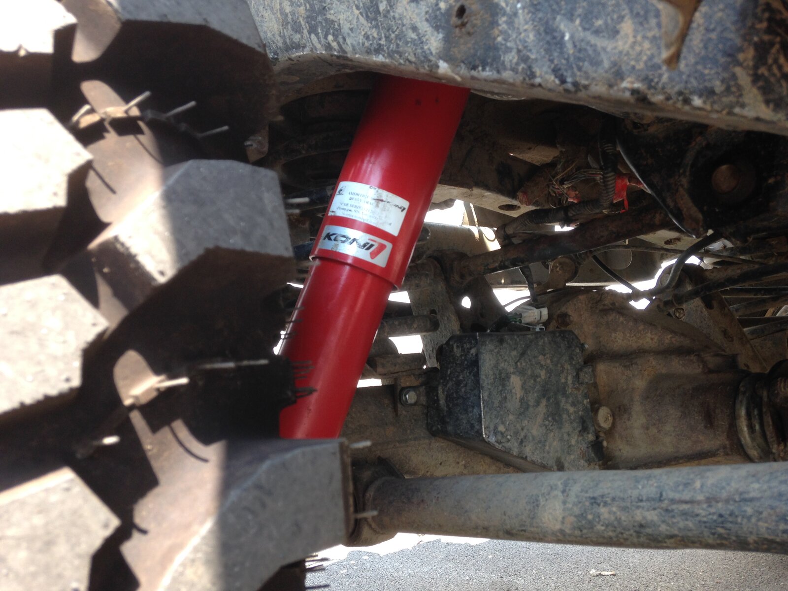

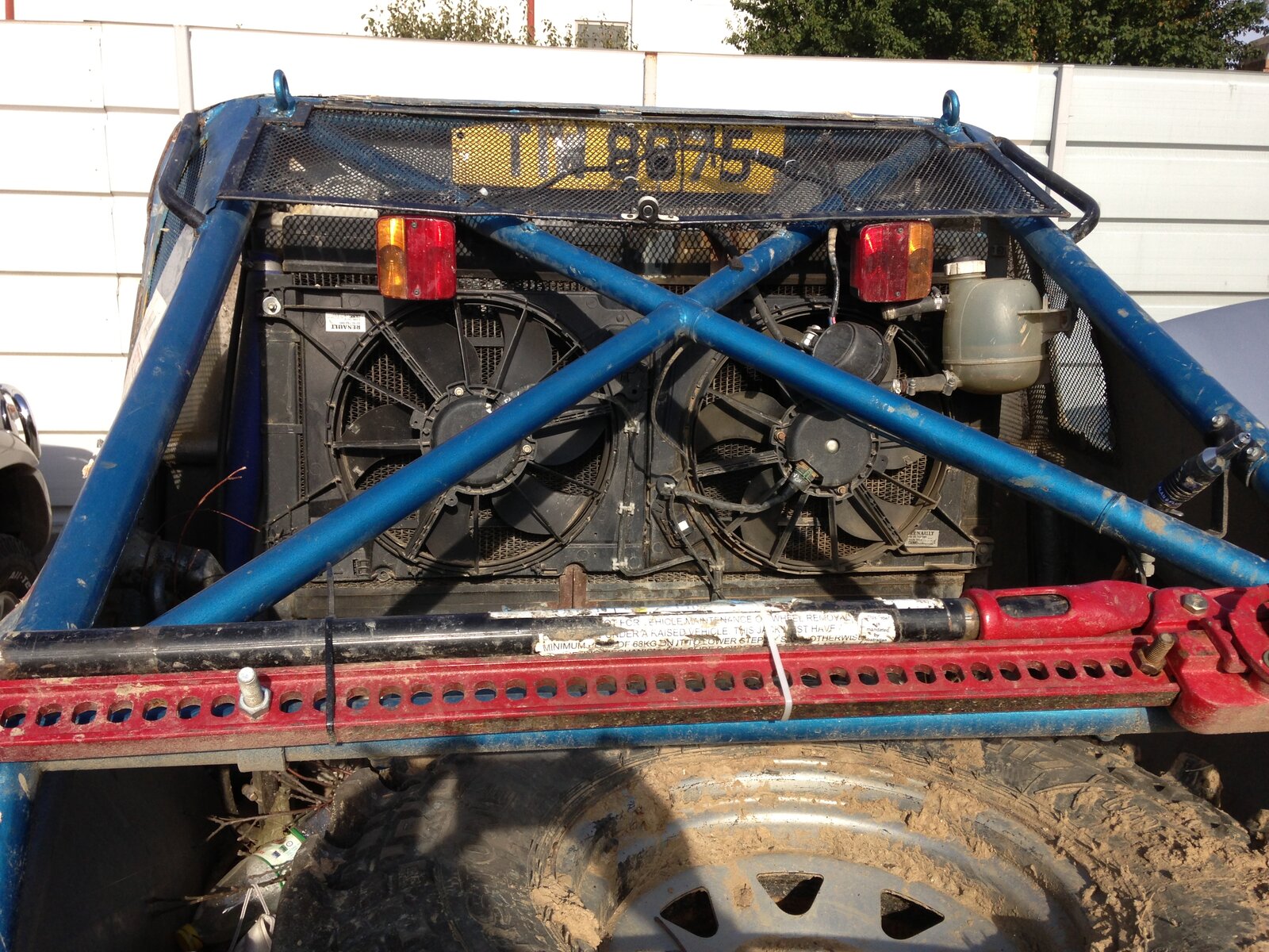

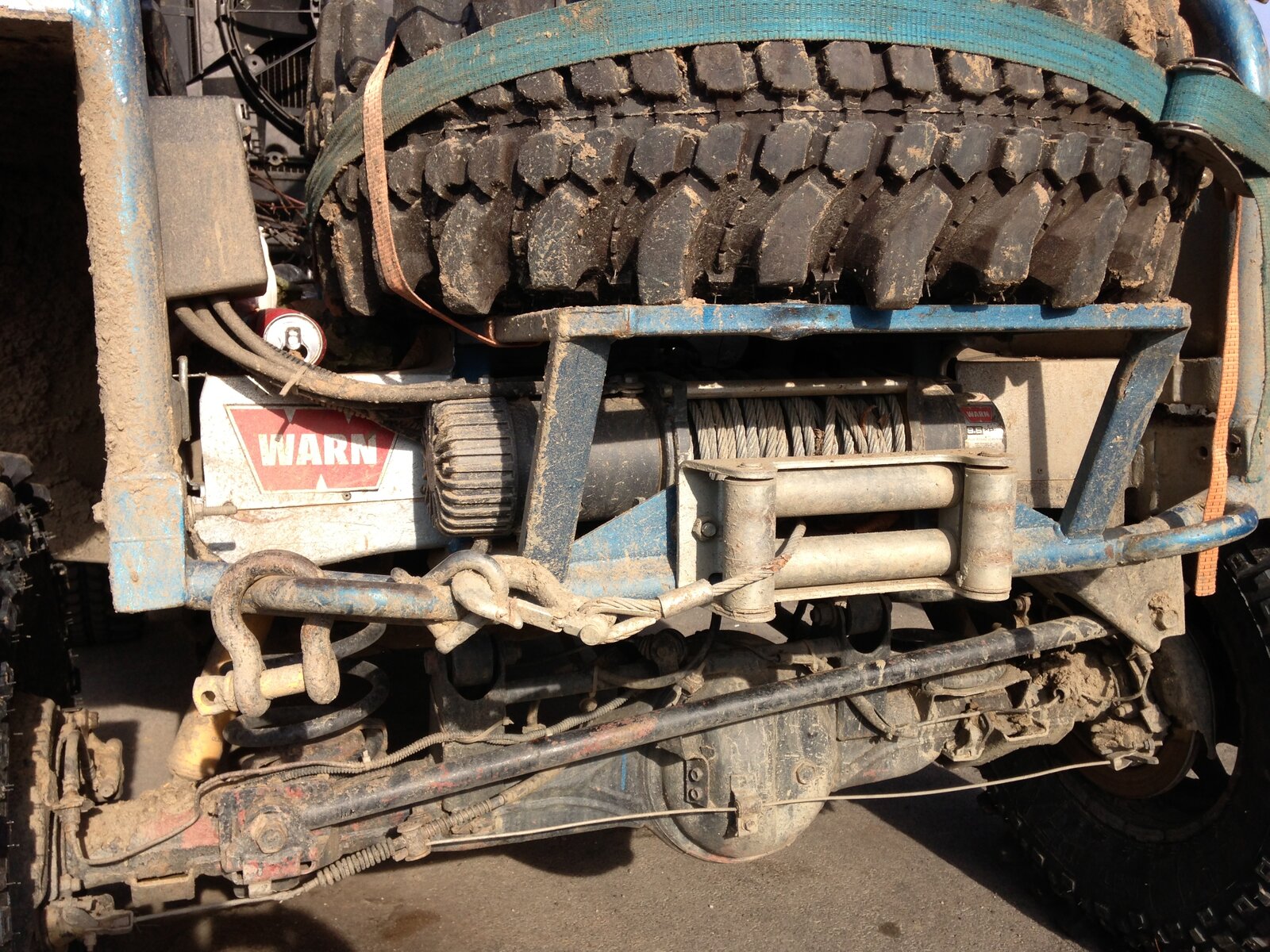

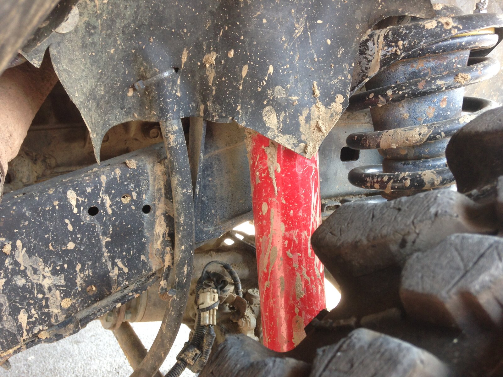

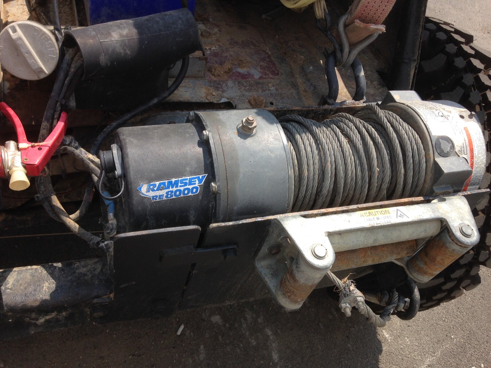

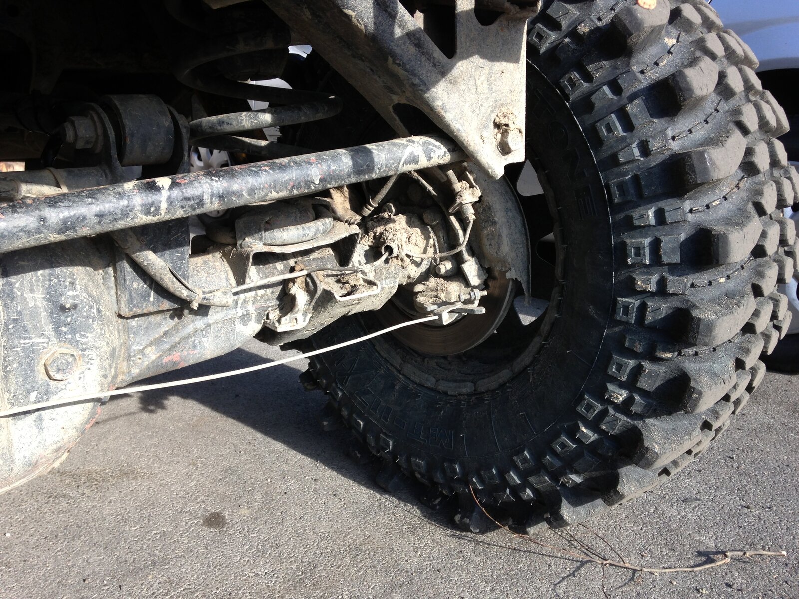

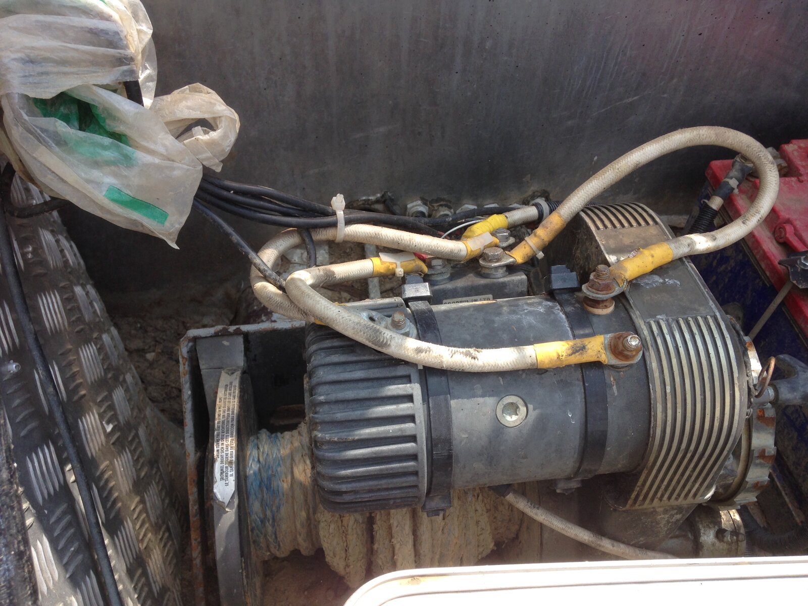

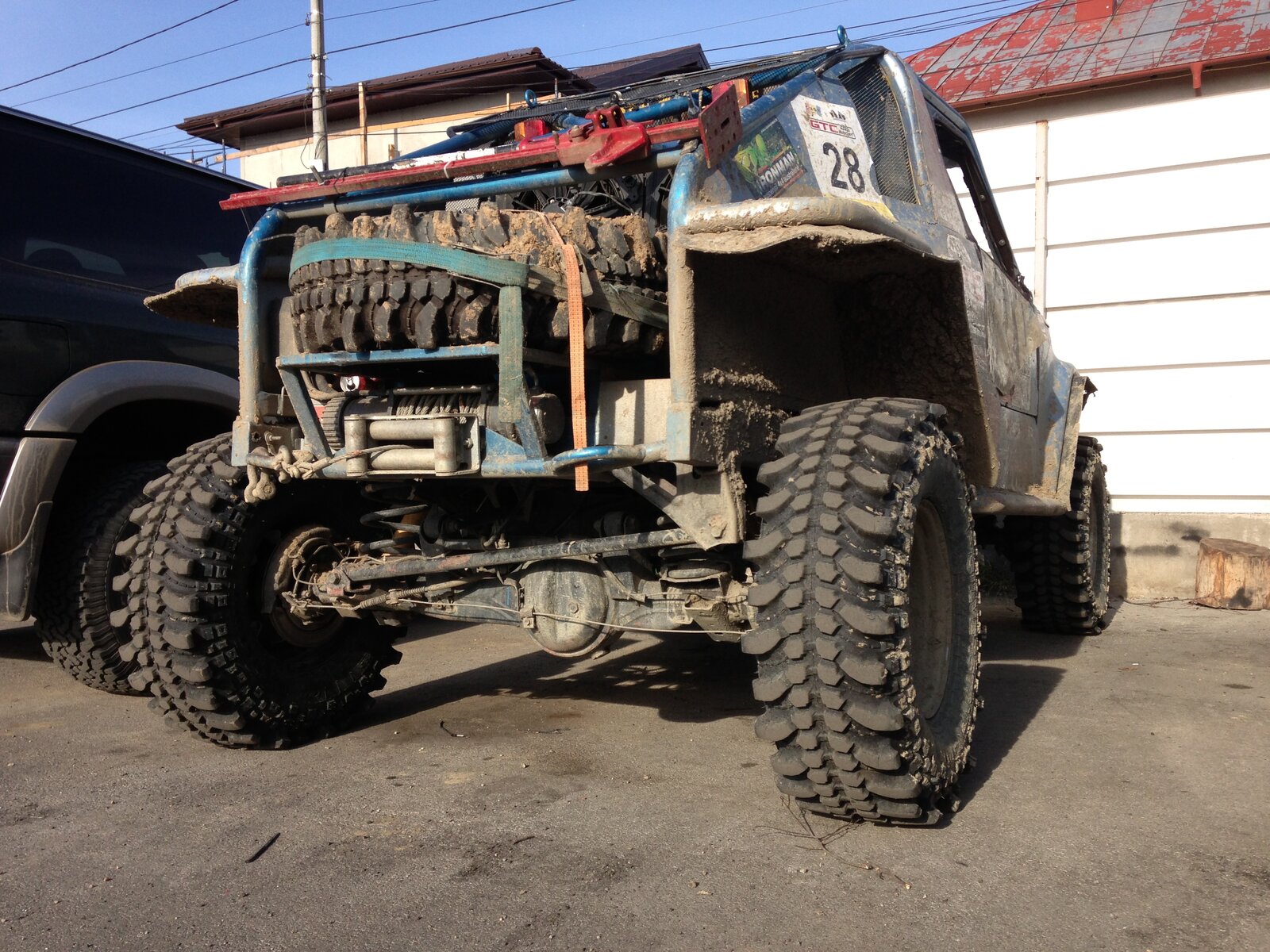

Just for Gav, Razvan's other (and better) 80 comp truck...

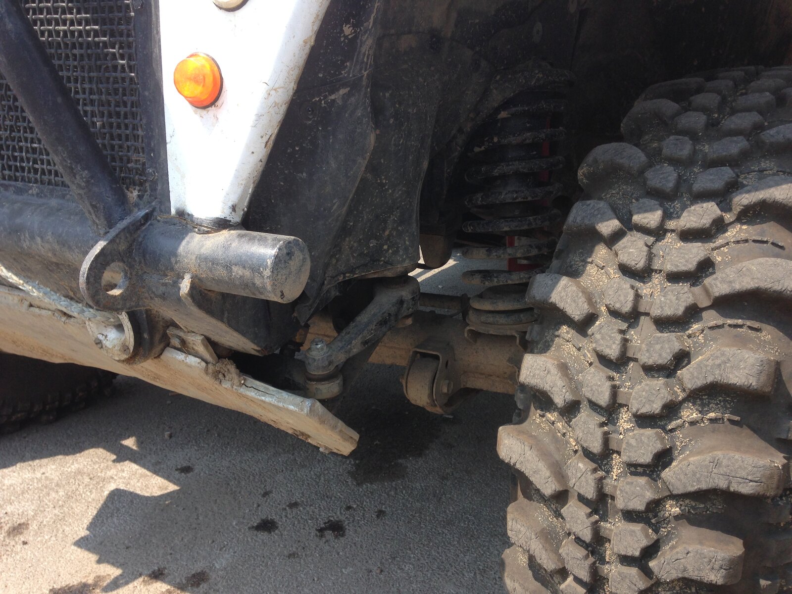

The front winch is completely hidden, couldn't see it let alone take a photo...
Big meaty shocks on the front and rear...
One of the (two) rear winches...

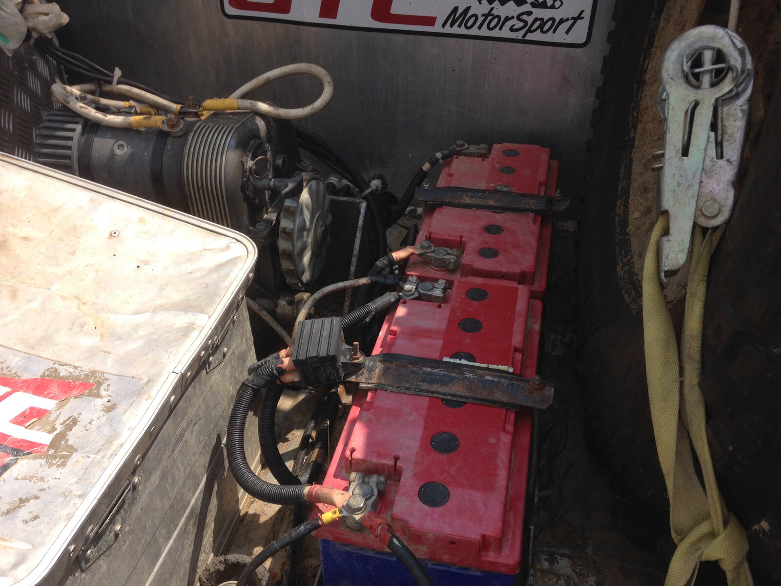

The other rear winch is tucked away in the tray with a couple of extra batteries for good measure...
There's no fairlead on this one, he says its for serious winching, like in a major crash, vertical pulling and such like :wtf:

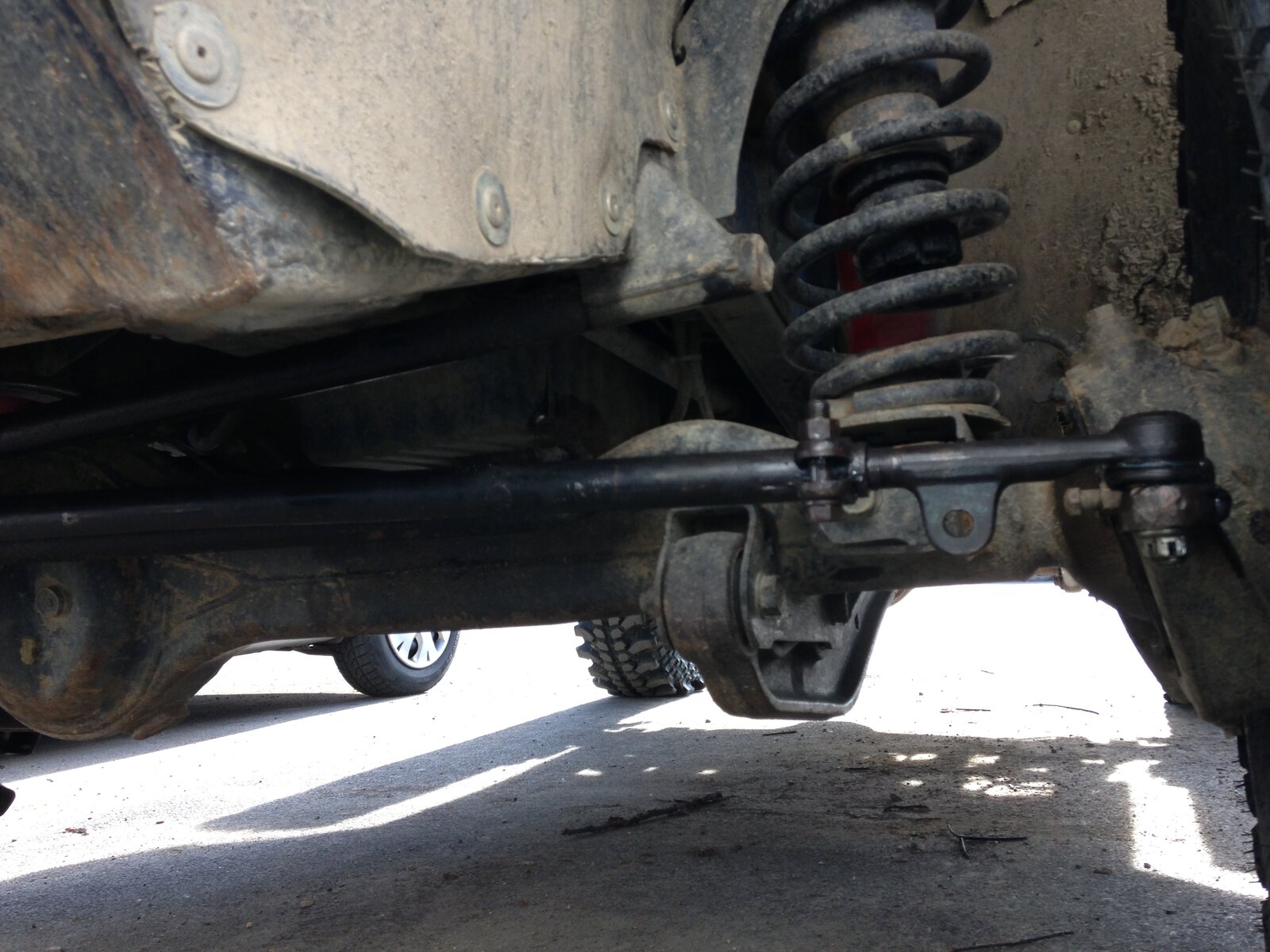

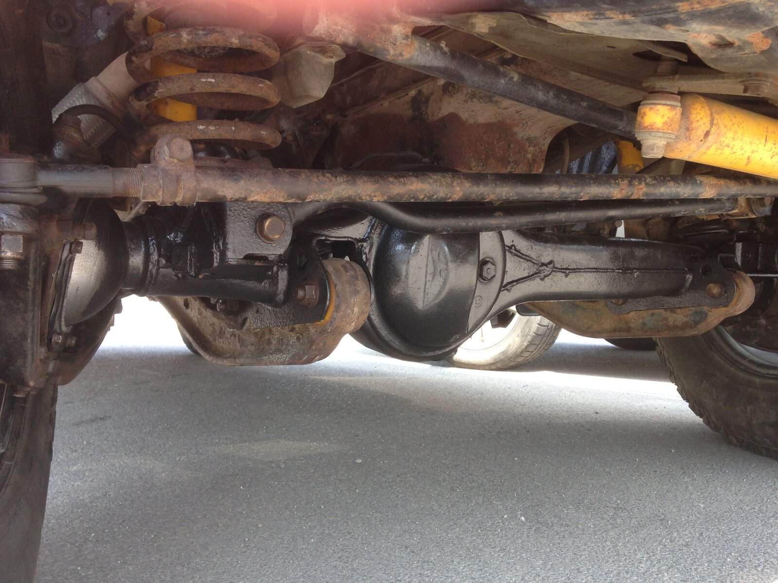

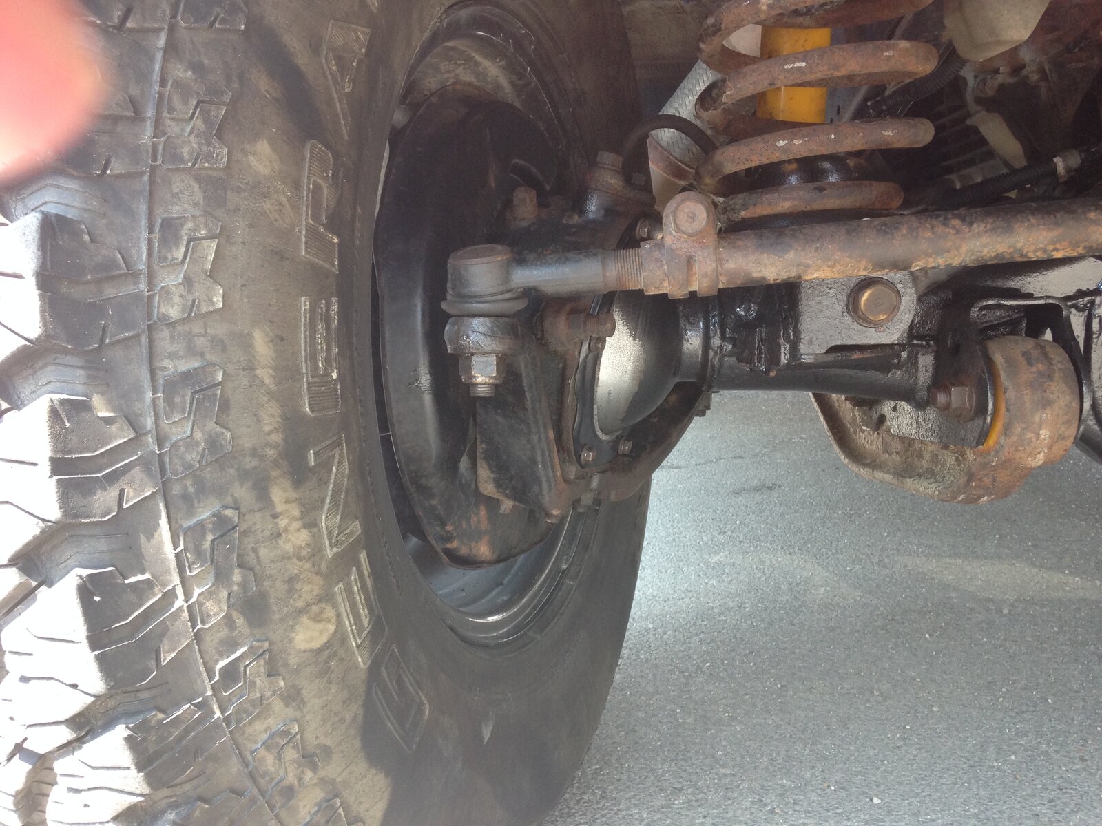

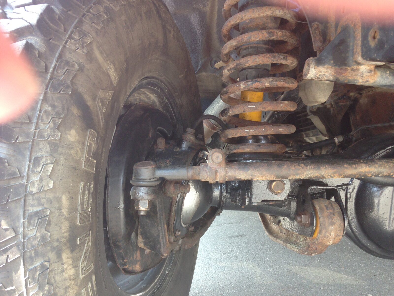

So much for other folks' 80s, I've got a bit of an update, well closure it seems to my little escapade.
Collected the truck today.
Managed to secure the replacement axle casing, it was a RHD so the panhard mounting was cut off and welded onto the right hand side (to match the vehicle LHD) with some reinforcement for luck. Then the casing was grit blasted and painted in 2 pack black, and fitted to the truck.
In went my new chromoloy Nitro Gear driveshafts and birfields, obviously new oil seals.
I was pleased that he reported no diff oil in the CV grease, only some water (which I guess isn't uncommon).
New wipers on the back of the knuckle balls, new top & bottom swivel bearings, new bronze bushings on the birf shafts, new brake rotors and pads.
All done.
And my front wheels look vertical for the first time since I can remember!!! :dance:
Only 3 photos, I'll try to post some verticality shots later...
The truck drives straight. I didn't realize, but it had been pulling slightly to the right. It's been so long like this that I'd got used to it :whistle:
One happy bunny... :dance::dance::dance:
