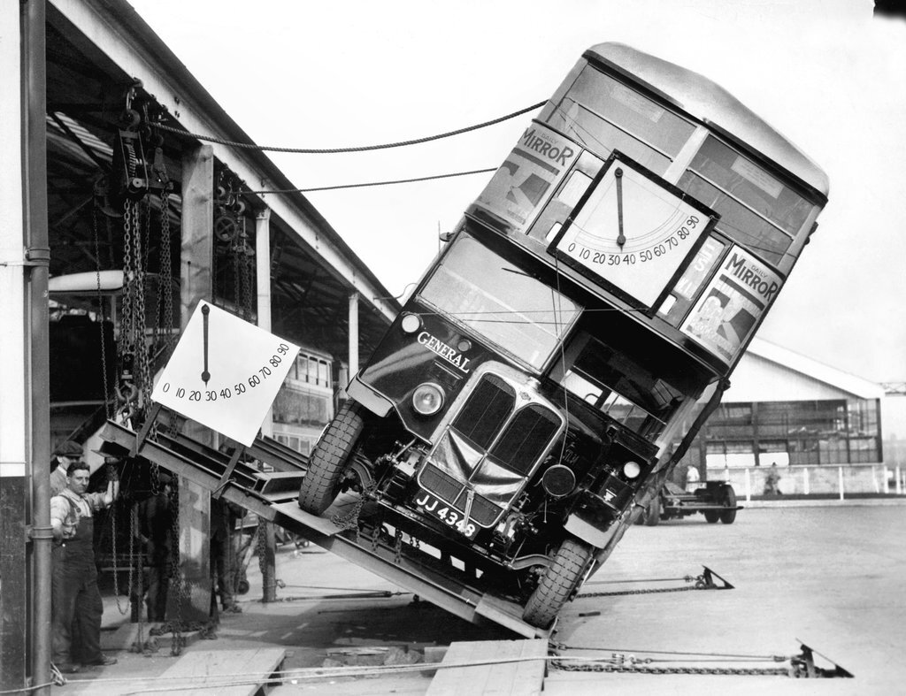

Just watched the vid and luck gets my vote , its a good example of why i don't like trucks that are jacked up too high , in an ideal world width should be increased to correspond with height , a double decker bus can be tipped sideways more than 45 degrees but will fall back on its wheels because it was designed that way and so are most 4x4's but lift without increased width lowers that safety margin .

Notwithstanding the numbers of lean degrees Shayne, I certainly take your point.
