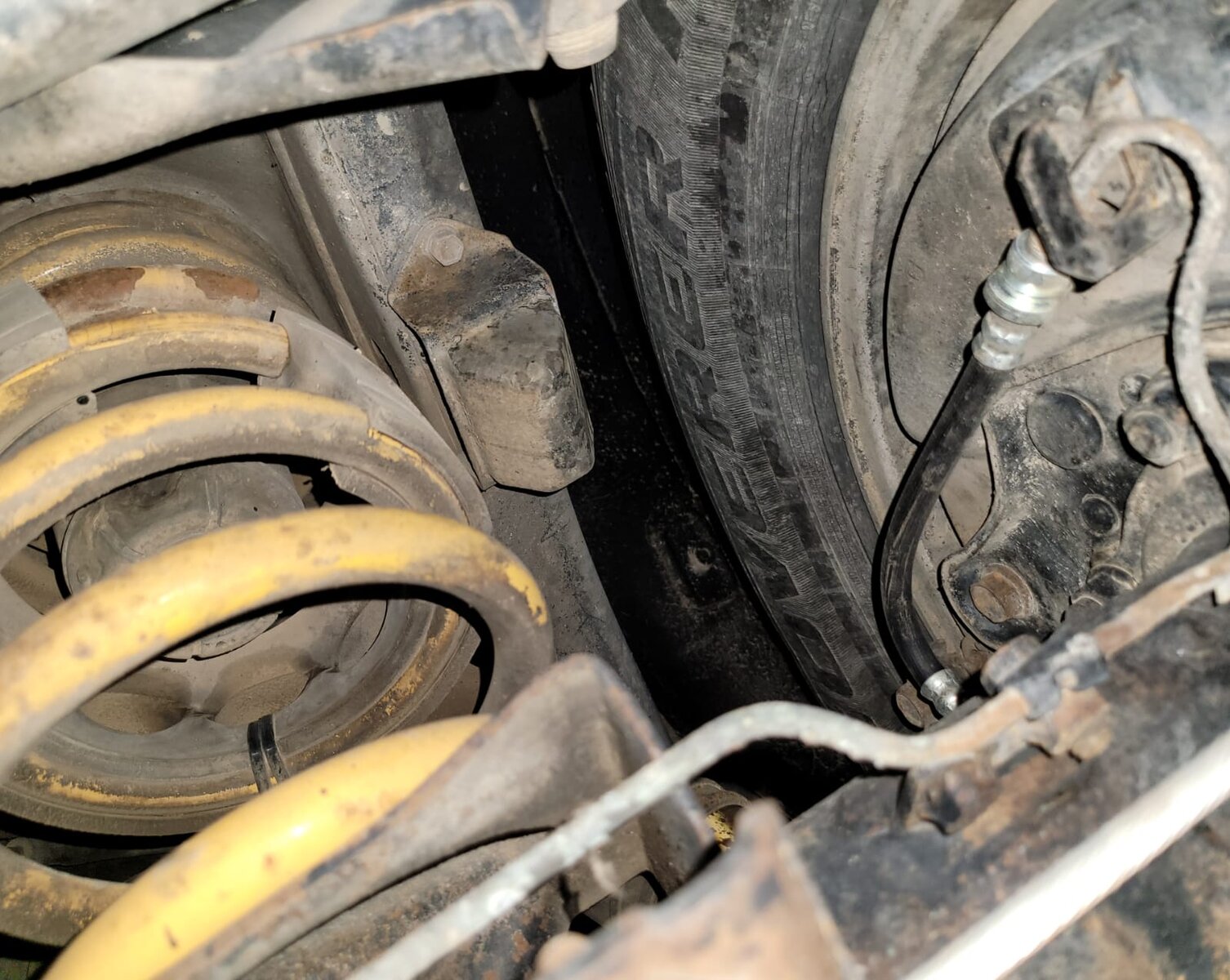

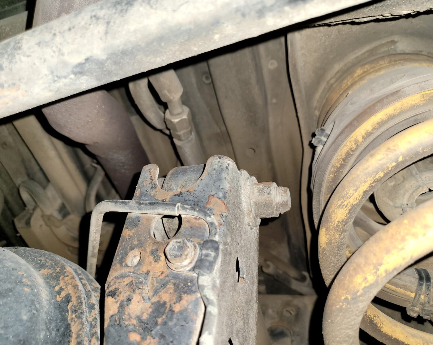

1, Play in the steering. The steering box is adjustable, but needs to be done with care, get it wrong and you find the roundabout your on you will not be able to get out of as the steering can jam in one position., you say it is lifted, can you do a check to let us know by how much? Any vibrations from underneath that vary with speeds?
2, A jerk in the steering, if the lift has not been done in the correct manner and the springs are not rated correctly the front axle could be hitting the bump stops? Also whilst under there check the steering box mounting around the chassis and the same for all other connections including the panhard rod, at that age the chassis could be rusting allowing the components to move and in a worse case scenario tear out completely, a steam cleaner or jet wash and a wire brush are your friends here, with the 80 on the floor, have someone rock the steering hard from side to with the engine idling at the same time you use a torch and look for any flexing of the suspension/steering/panhard connections including to the body and between each other.

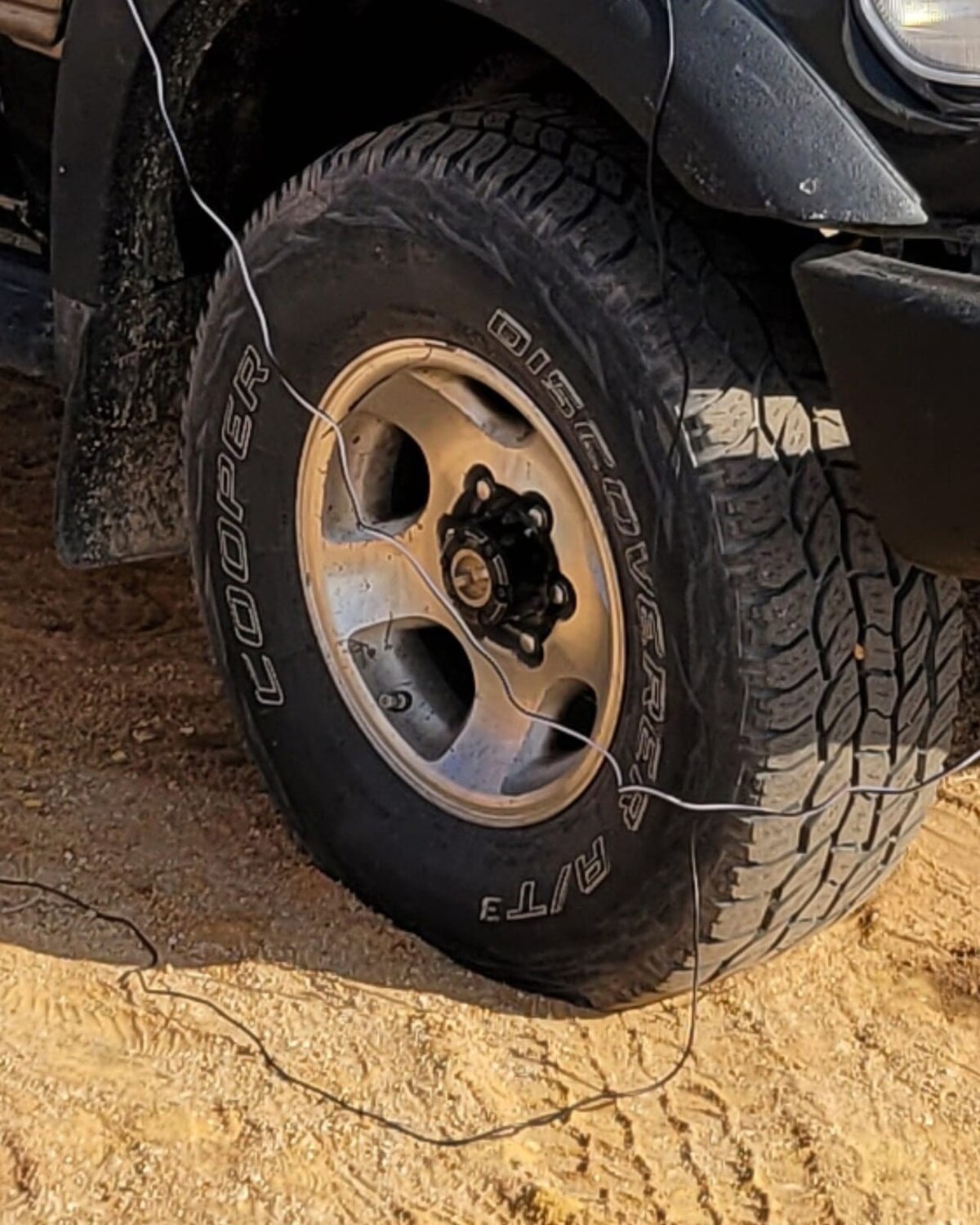

10, You would need to clarify your locker question, the typical 91 model did not have a switchable 'locker' on the front or rear axle, I have heard about them but have never seen one, I am convinced there is an element of confusion here by those not familiar with the system? You will have a centre lock which works within the transfer box, but in general the 80 is full time all wheel drive. or part time, there is little to be gained by the part time system, they were simply cheaper to purchase than the all wheel drive system, fuel savings have been proven to be minimal if any at all, and there is talk of wear on the drive line being reduced, again more speculation for sure. Those that have paid out a lot of money to do the conversion wold never 'fess up' that there was no gain.
