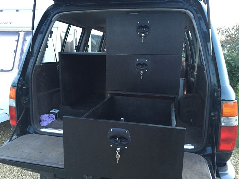

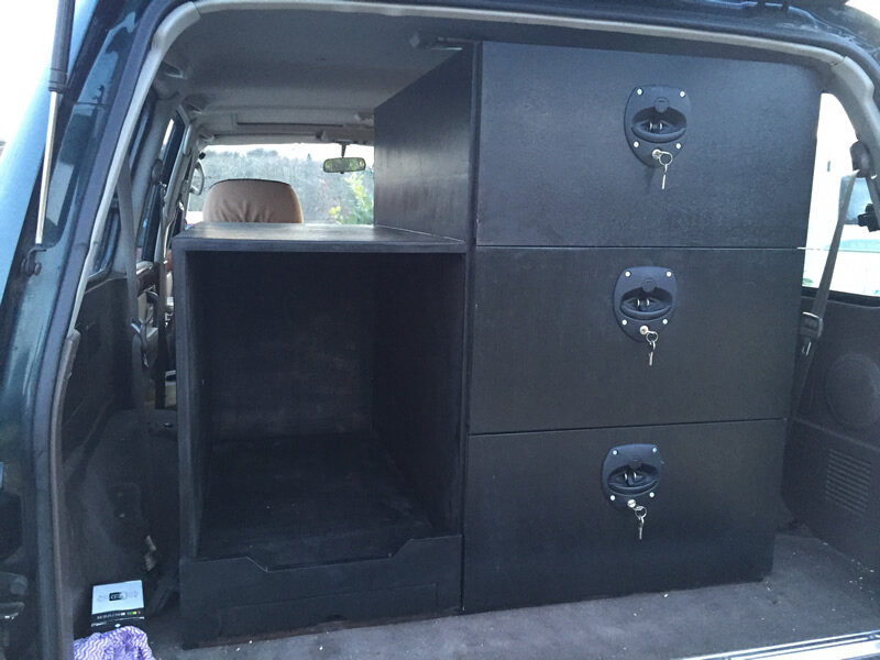

Picked up the completed drawers this evening. Plenty of space now to put stuff :icon-biggrin:. Hope these are up the right way this time. Next up, first fix for water tank and battery.
OK if in Oz! lol doh doh and double doh!
Actually they look pretty good!
Does everything fall out of when you open them? You seem to have installed them upside down...
there, that's better .........
.... I must pay more attention.

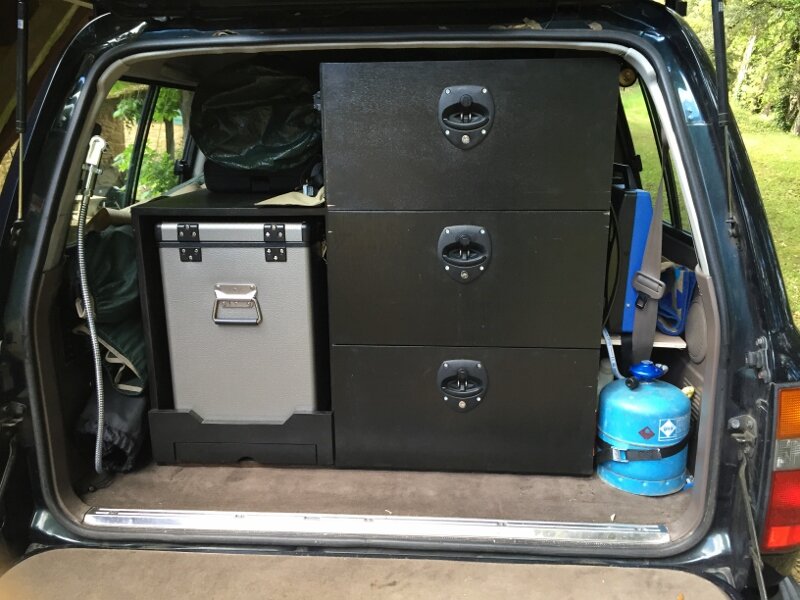

Been a bit busy over the last few weeks with the interior. First, we got a fridge to go in the purpose made hole ............

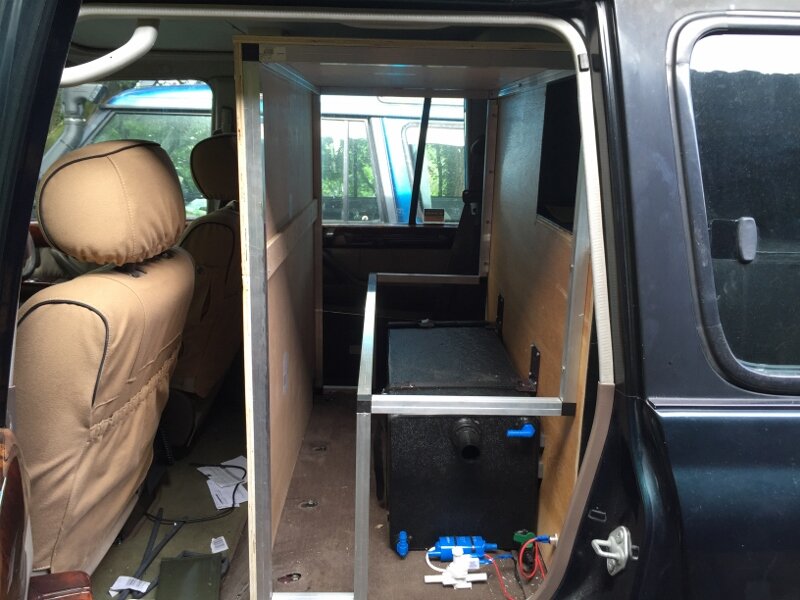

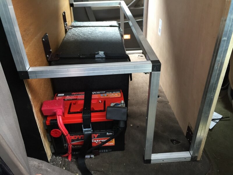

then, having taken the rear seats out, set about making the frame to support the clothes storage area which goes around the 55 litre water tank. I love the aluminium and plastic corners method of construction, makes it very light and pretty sturdy. I didn't need to drill any holes in the floor. All the mountings to the bodywork are via B&Q brackets to seat mounting holes. ....

then fitted the auxilliary battery and split charge system - I used a T-Max as I have one in my Landy and it has always worked well .....

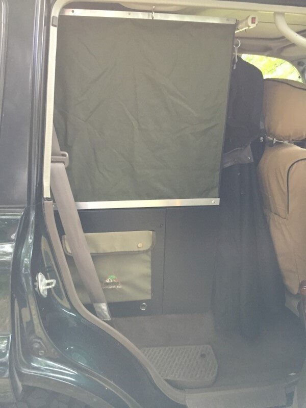

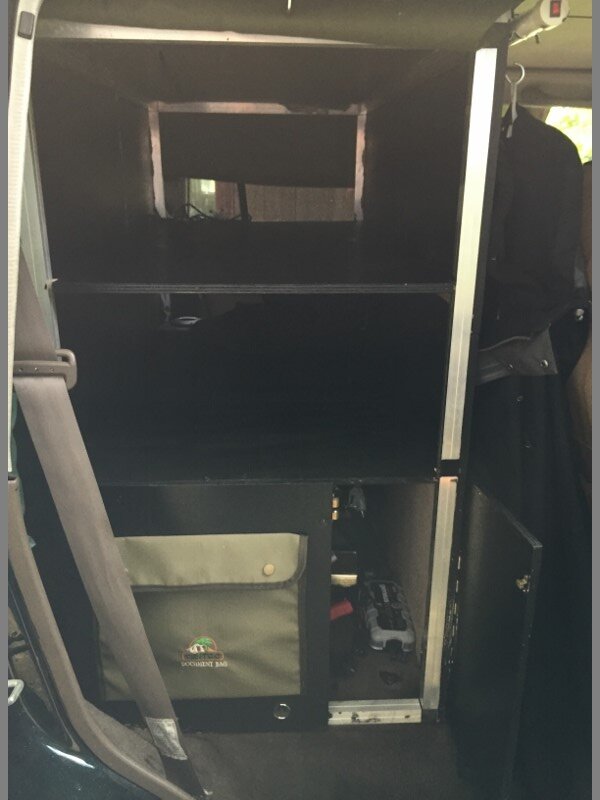

I clad it in 12mm plywood and painted it with black emulsion. The green covers are from an old bivvy with aluminium glued and riveted to the bottom to weight it down and has little velcro squares to hold it shut. .....
there's enough space for 4 wolf boxes now ....

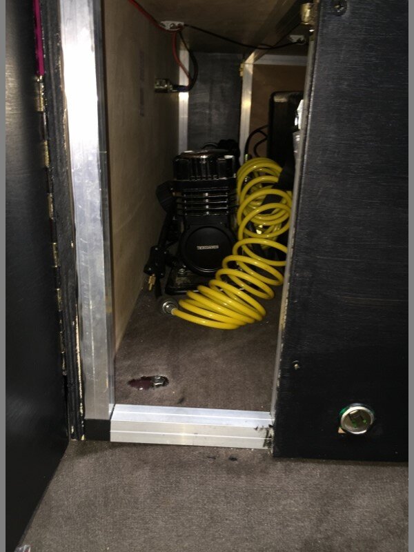

to the right at the bottom is a door which gives access to the air pump and some storage for boots, shoes and bits and pieces ....

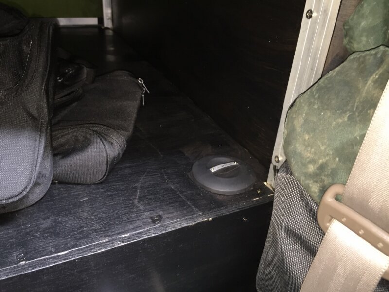

the filler for the water tank is here ...........

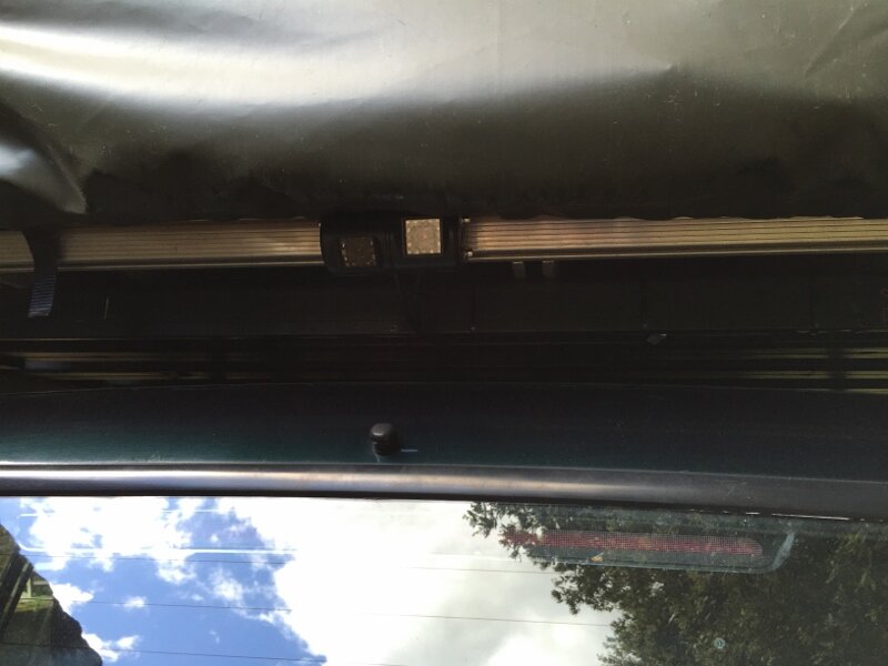

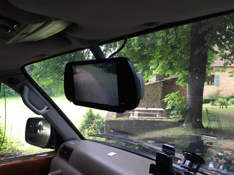

also, fitted one of these as I can't see out the back anymore ....
its got wide angle and normal cameras which I can switch between using this .....

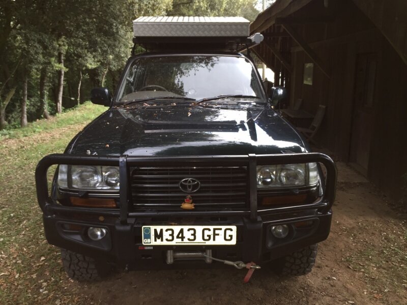

and I finally managed to get the winch fitted. Tip for anyone buying a 12000 Warrior and fitting to a bumper like this from Accessoire 4x4 is that because the motor is bigger, it will not sit central on the winch plate which means the holes have to be moved 12mm and new re-inforcing welded in.
Pretty happy with the result and the shakedown starts this Friday as we are off to Portugal for a fortnight driving North to South off road with a couple of friends in Landys. Can't wait :icon-biggrin:
gotta say, that looks the bollocks! real nice bit of work there, how the hell do you get into that top drawer though!!
