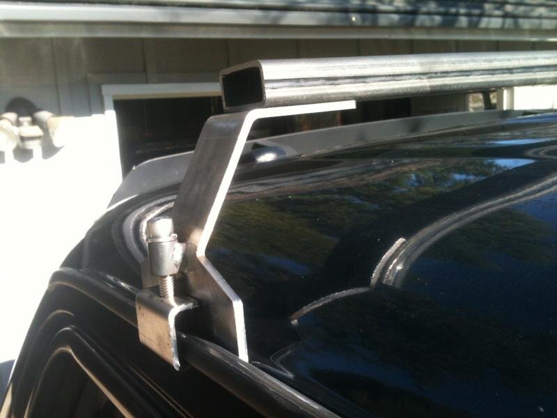

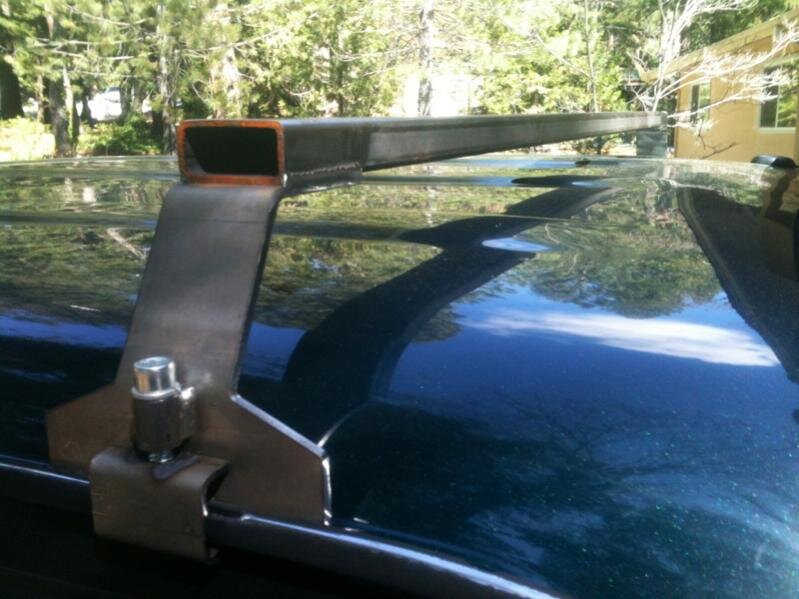

I like these if anyone wants to offer to make up few sets
Hmmm :think:
Nice and simple. I may know a man that can. Ill buzz him tomorrow.
I know the foot is 100mm long and the box that has been cut has a nut tacked to it for the bolt to thread into. Like you I think its simple and gives options as to how or what you mint to them.
A chap at the end of my road has a nice shop and will have a chat with him but just thought it worth asking.
I like that; simple, sturdy and practical.
That does look nice.
My only addition might be some slight height adjustment to allow for the gutter longitudinal arch profile (two piece on the diagonal, slots in each and a pair of nuts and bolts - stainless of course). If not possible in stainless, there is quite a reasonable powder coating company between Witney and Oxford just of the A40.

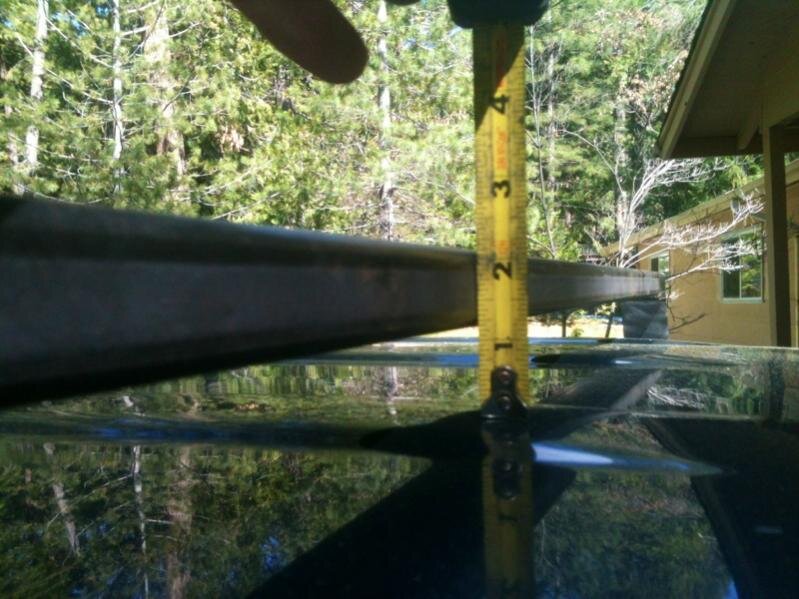

they are vefy nice maybe a tad high??
i like the way the patriot feet are in pairs with a bar of metal to spread the load along the roof rails.
stu
Have you had a look at the old Thule gutter mount feet? They were a semi similar design, but instead of a bolt on the top there was a sleeve that the bar slid through. I'm bereft of knowledge on steel, but is there a way that a similar box could be included so that the cross bar is located within that, therefore reducing shear load on a bolt that holds the bar in place.
Also is it worth putting a small supporting brace underneath from the outer most point to the upright so that the load is spread onto the bracket better?
