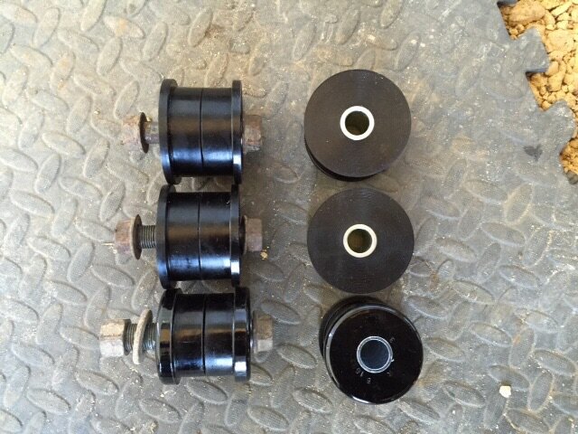

Replaced the bushes on my 95 Lower rear link arms with whiteline bushes last summer. Very easy to install and seem ok at the moment but only have 5000 miles on them

The Whiteline bushes I used do not require a press to fit, where as the Toyota ones (if available) would need a press. The grease supplied is not for use between the bush and the eye and the instructions are explicit on stating this. The grease is for the steel sleeve inside the bush that the bolt goes through and the mounting face to avoid squeaking. The bushes are designed to have the pivot point/rotation around the inner steel sleeve not the outside edge of the urethane.

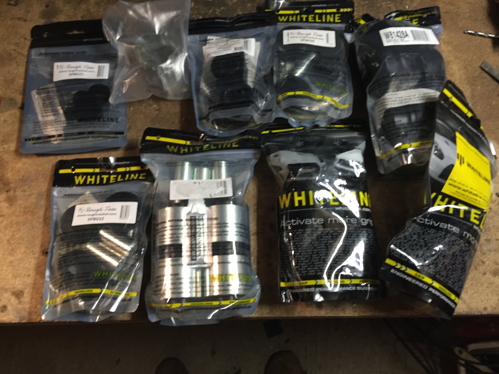

Yes, they arrived the other day.......
The upper and lower drag link bushes have been pressed in without problem and I refitted them with the new anti roll bar bushes without any problems.
The only thing I had to do was trim off about 1mm of rubber from the ARB drop link bush, to make them the same as width as the steel sleeve because they wouldn't fit the drop link fork. On a related note, if you are replacing the drop links as I did with Roughtrax ones, be prepared to grind a slot in the end of them for a screwdriver because they don't have a hex Allen key slot in the end like Toyota ones do. If you don't you can't do them up as they just turn.
I haven't fitted the front ones yet or driven it as I've got other jobs to do.
I fitted the front leading arm bushes yesterday ...
No dramas, all very easy, the rear ones needed a tiny bit of persuasion using the vice, nothing major.
I took it for a drive today. Compared with how it was, the car feels much better, more taught albeit a little bit stiffer, but I can live with that.
Thumbs up from me. Now to see how they are in rugged use.
