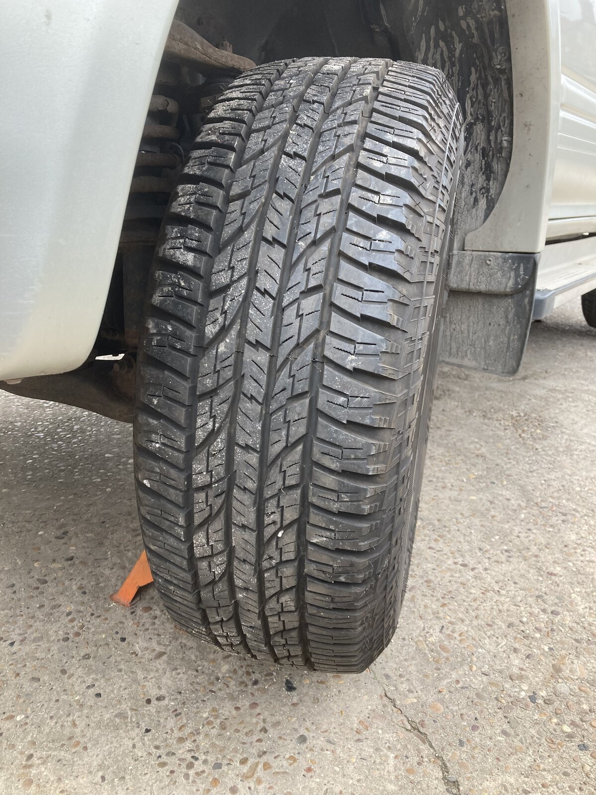

For a good while I've been running these 275/70/16's on the Collie and they've been fine .
However they were feeling a bit "old" so I had these fitted to the same wheels, Yokohama Geolanders I'd been running on that scabby 80 I had a couple of years back.
I'd bought a couple of new truck steer tyres ( £420 each, ouch) so I asked them if they'd swap these over and balance them for a favour which they did. Fitted back on last night, an immediate transformation, smooth and quiet. They are my favoured tyre at the moment and I'll fit them to the 120 if ever the present GG AT2's ever wear out.

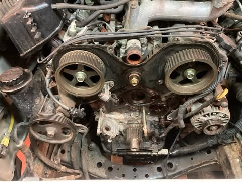

This has been off the road for a year now. Primarily as the hesitation on pickup was an annoying (now fixed) trait and also I needed to rebuild the air con system as some of it was missing due to an accident it had had sometime during a previous life. Also although it had had a cambelt changed 30K ago I wasn't sure the tensioner had been changed at the same time.
I needed to remove the radiator to facilitate replacing the air con condenser so it all came out.
One issue I had found in the past was the fan carrier had been damaged in the accident and had been repaired rather than replaced and the bearings were rough but not terminal so that
was was a necessity to be replaced.
New genuine one from Amayama, about 1/3 of the price from Toyota ( £910 + Vat)
While I was at the front of the engine I thought I'd do a cambelt swap since I'd heard it was an involved job ( it was). Having obtained all the idlers pullies tensioner water pump belt etc I stripped the front of the engine down ready for reassembly.
This involved removing the front pulley and the aircon pump and it's carrier to enable the tensioner to be fitted.
The aircon pump and it's carrier are a right Ba****d job, with access between the chassis and the inner wing, very little room.
All in all the parts replaced were;-

Reassembly just a reversal of stripdown
