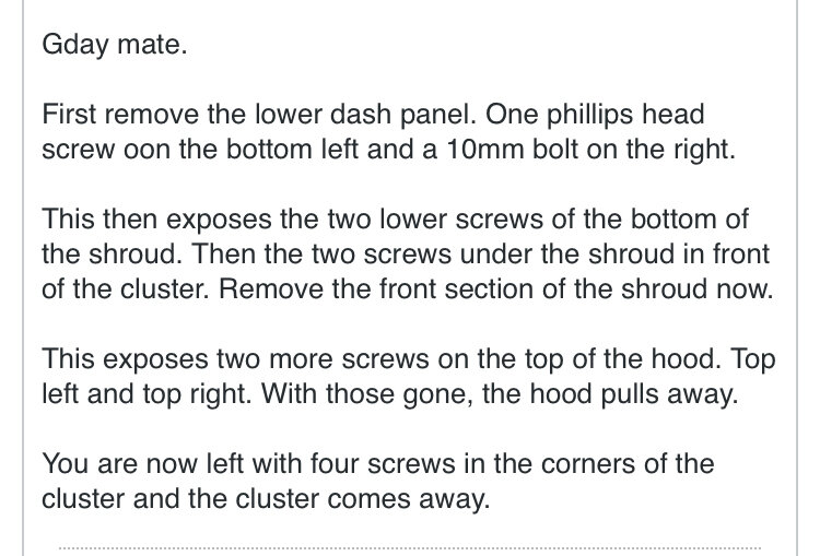

My P bulb is intermittent on the cluster now. it will light up at first start of engine, then will go off until the next start?
Found the below from another forum, steps to remove cluster, see attachment. Sounds straight forward.
