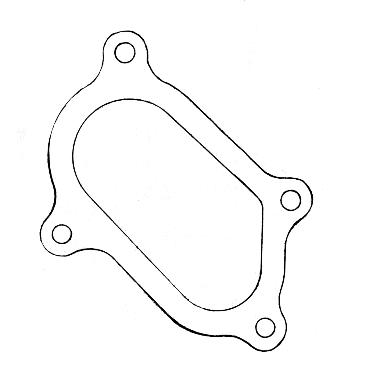

Ebay used to be the place because i think Supra's or the MR2 used the same turbo but a quick look says none available now .
The gasket is a template so im sure i could make one if i messed about all day with a grinder and a drill , pro steel cutters will do it for fun in lunch break .
Cheers Shayne, I'll stick with the original plan of having it cut.
