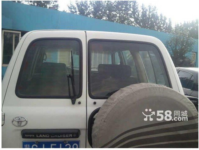

I thought all 80 series had the "up and over" rear door?
Is it a "special" or some thing?

Nope - most common in Aussie and General (UN) trim - those are barn or ambulance door configuration.
All RSA 80 GX had the barn doors as do many African spec 80's and 100's. Aussie spec GXL have the tailgate doors.

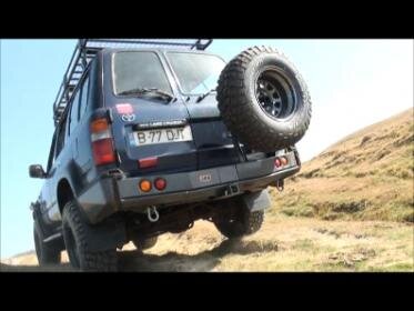

Sorry Ken - all SA GX have tailgates - the Aussie imports and ex-General spec got the barn doors. There are a few running round SA but the vast majority are tailgates (both mine were, even though one was a GXL).
If you look at LCCSA trip reports and build threads - or the 2012 Saamtrek pics - you'll see mostly upper and lower tailgates variants.

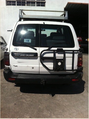

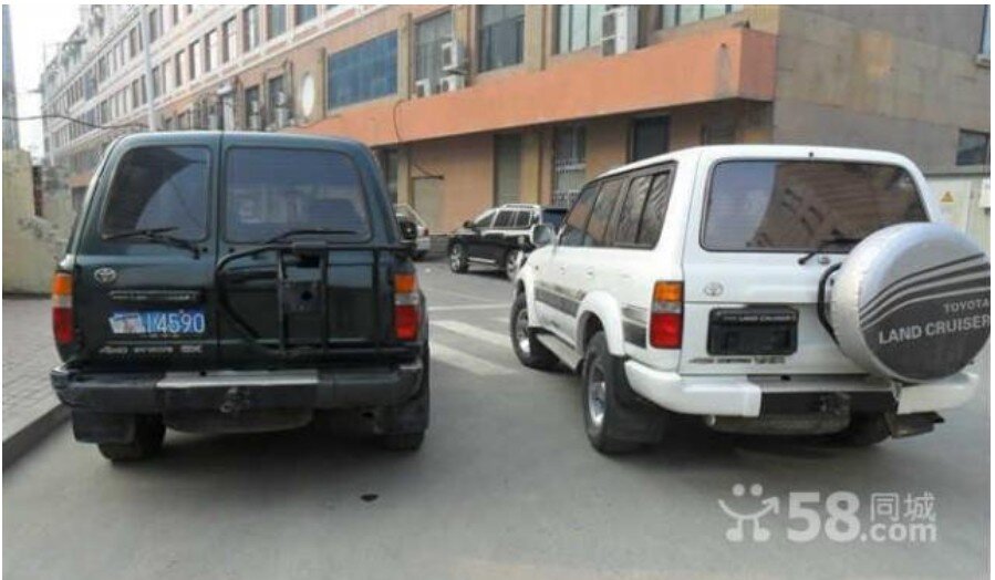

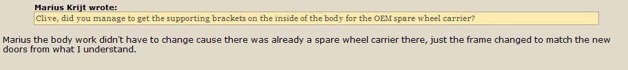

I saw a build on the South African land cruiser club site where a 100 series barn doors were swooped over by Mr Cruiser (???) in Zimbabwe. From the pictures it looked pretty easy.....
(sorry but can't find the link...)
If it can easily be done with a 100 series, surely it can be done to a 80 series?
Well it was only my opinion, if someone's done it and it is straightforward, then so be it. I'd like to see the link if you can find it, just as a matter of interest.
Mmm,
From these
To this.
