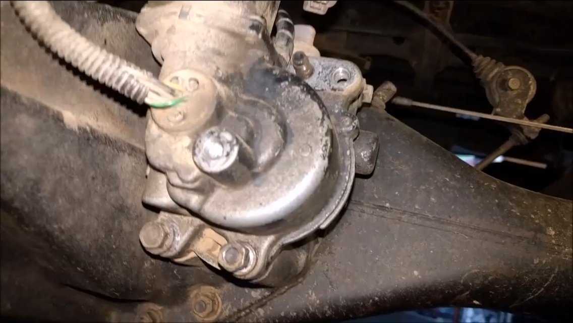

I believe that the rear axle either has a lockable diff or an LSD. If it has a diff lock, there will be aluminium bodied actuator on the casing near where the prop shaft joins. If no difflock actuator is fitted, then it has an LSD (unless the actuator has been removed and a blanking plate fitted but that should be obvious). As you already said, LSD needs special oil.
