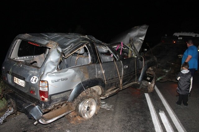

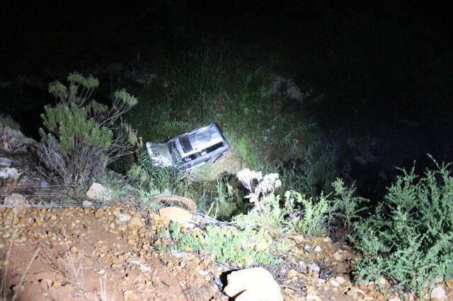

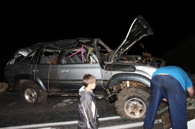

A few weeks ago I was cruising along to visit a friend out in the countryside ie no lights and a B type road. Long story short, I took my silver cruiser down a rather steep cliff, rolled 3 times, through a river and came to a halt on the far side of the bank :shock::shock::shock::shock::shock: This = a bad bad accident I am simply lucky to be alive after let alone being able to unbuckle my seat belt, put on my shoes, collect my belongings, do multiple inspections of the vehicle, still ponder why I couldn't get her started and drive out of the gorge I ended up in :( To confirm, Lorien (wife) and new puppy were not in the car, just me, we're all fine (altho I got quite a blast for writing off the silver truck which is Lorien's!)
That's making light of the subject though and it must be said in big bold letters that the Landcruiser and in particular, the 80, must be one of if not the strongest vehicles ever produced. See pictures below and it'll make sense quickly. How did I get in to the mess though!? I was sober as a judge, just had an afternoon nap and was doing a mild 40mph down a slight decline. Light drizzle and some light braking caused the rear to slip out and before I knew it, I was tumbling down the side. No yellow line / space and pitch pitch darkness + who knows what else contributed to it all happening. I'm very happy to be here and experienced all the "things people see during a big crash"!
So, on to the pictures and questions.. Poor, dearly departed Nala, queen of the road. Safely delivered us from London all the way to Cape Town. She is THE BEST TRUCK EVER BUILT and we are very sad to see her go. Big thanks to her for saving my life..

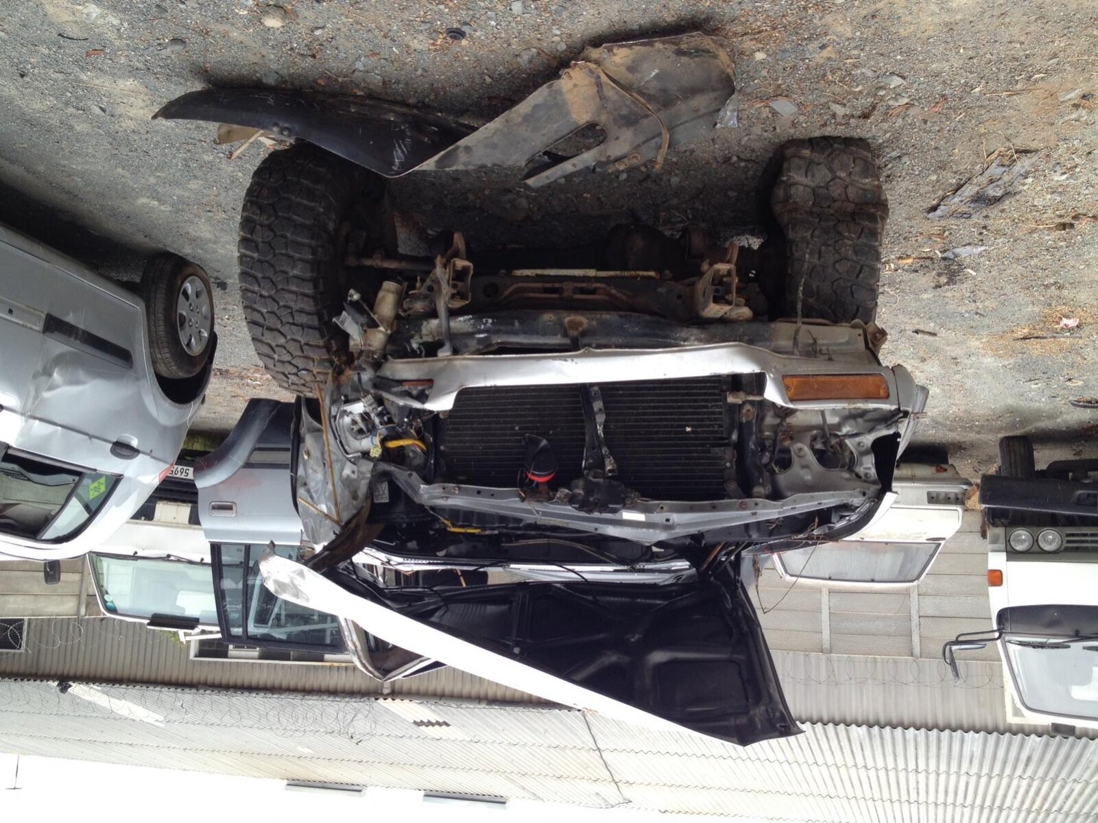

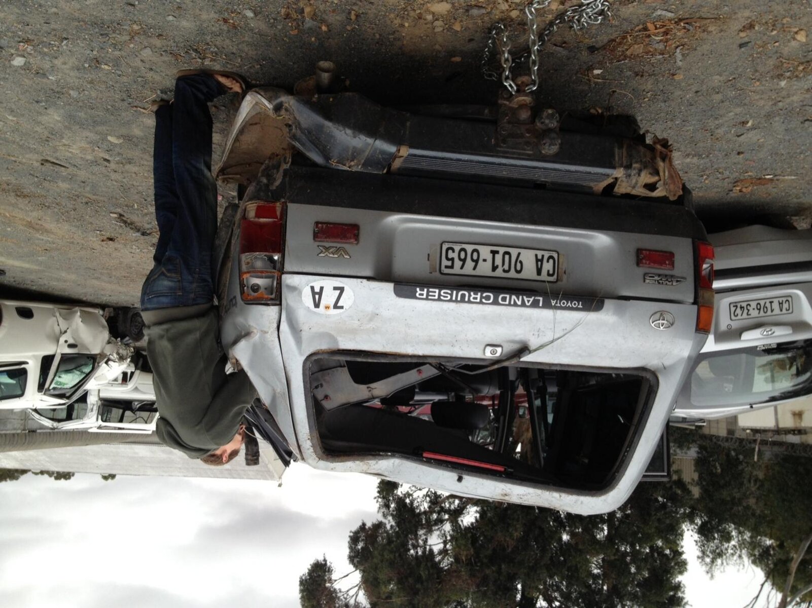

I have been systematically cutting her up (more heartache!) and saving all the good bits. The body was bashed on the roof but she was a lot worse off from the actual recovery by the tow trucks as they're not too picky about how they get the cars out it seems. I took the body to the scrapyard yesterday so 350kg's is gone. I'm left with a badly bent chassis, the axles and engine/gearbox/autobox.

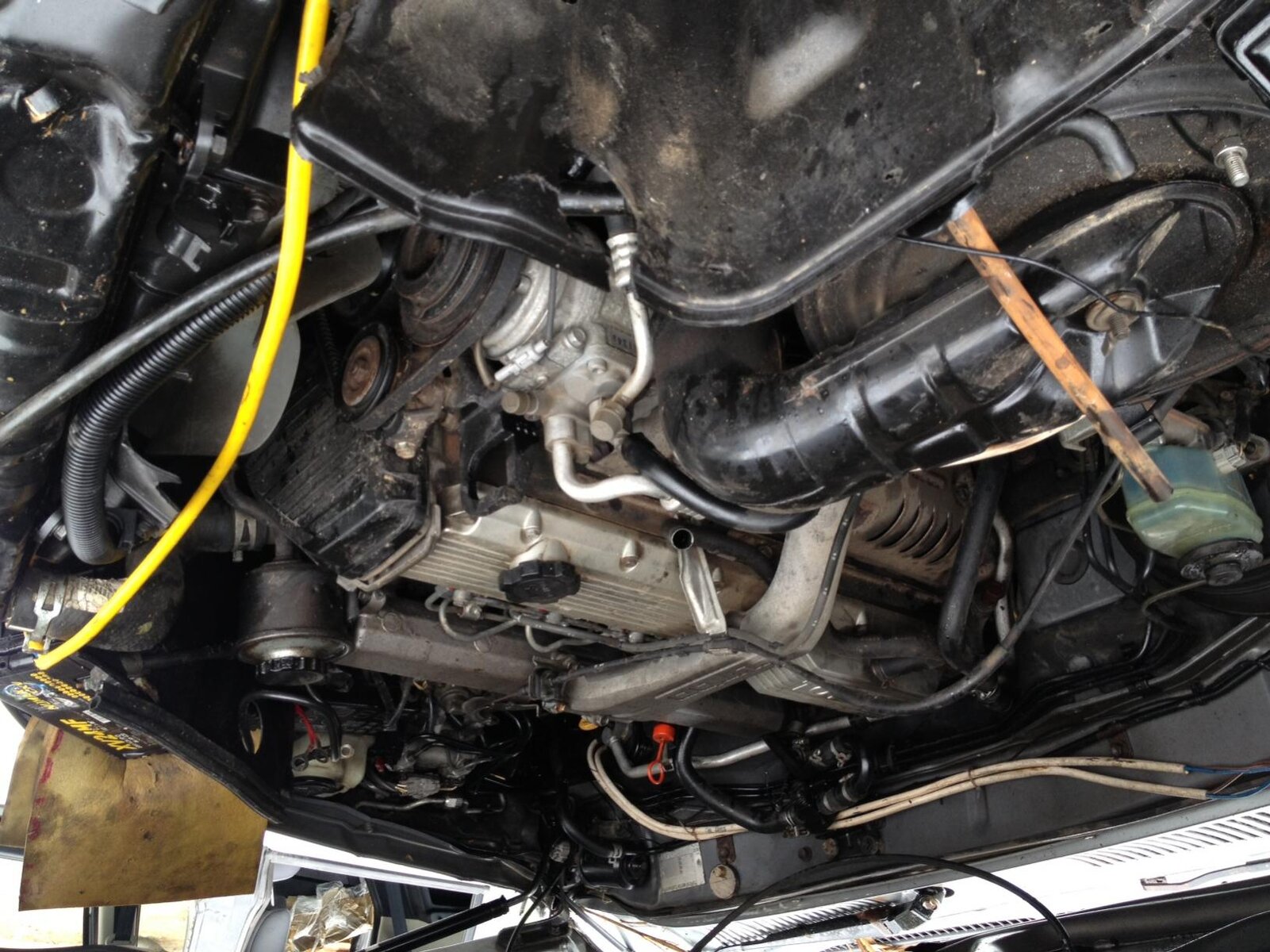

My questions is : How does one start the engine to test that it is in good working order?
I am pretty sure it is given that the engine bay was near perfect - I recovered the aircon grille and radiator!
I have clearly identified both + and - battery points but I am told that I need to find the fuel pump something and then?
Ideally I'd like an idiot's guide to starting her up to test for 30seconds?
I assume something like :
- Disconnect both prop shafts
- The fuel tank is already disconnected but there is diesel in the pipes and the diesel filter so I think enough to start
- Connect both batteries / or will something happen when the second is connected?
- I think though I'd need some kind of ignition function?
---- How do I stop the engine after it starts (important!)
Open to ideas and I really appreciate your help. (Karl, Paul - I believe you know all about this?)
** One major bummer is that the part that attaches the top radiator hose to the radiator broke but it looks like it bolts on to the engine. (better than having the top or bottom end broken) Any thoughts on this? See pics..

Thats a really bad smash. all you should need to do is put a pos feed to the starter and fuel pump then take a screw driver to short the starter out and brum. to turn off take the feed off the fuel pump. it works on cummings b series engine so should be the same in a 12 v engine. what a shame after that kind of trip. We might be coming down to SA in a couple of years to live but i thinking of shipping down.

Shouldn't be difficult to get the engine running with the body off, just needs fuel, power to the starter, the switched ignition on the starter solenoid, and the injector pumps stop solenoid. Removing the power from the stop solenoid will stop the engine. If the truck spent any length of time upside down I'd be tempted to check for oil in the combustion chamber before starting.

As for the engine, as above its straight forward to start up a big diesel. The stop solenoid is very important, or at least a very limited fuel supply, which it seems you have. This eliminates the risk of a runaway if it overfuels.. I have had this happen with a tractor rebuild.. failed governor on a vacuum feed pump. had to bail out, luckily it ran out of diesel after 2 minutes.
I would imagine the engine should be fine as it seems to have landed upright so oil past the pistons shouldn't be an issue. If it shows signs of resistance then abort until the head comes off.
