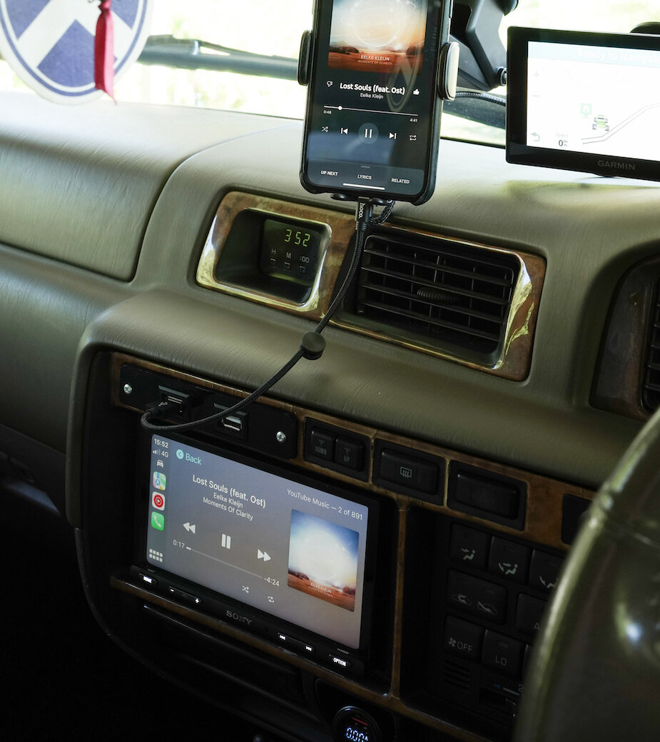

I went Sony, very happy with it. Made a wee custom USB panel for the Carplay
