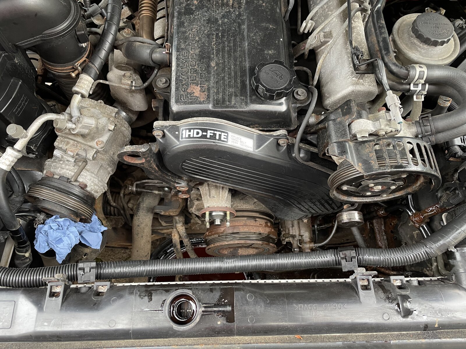

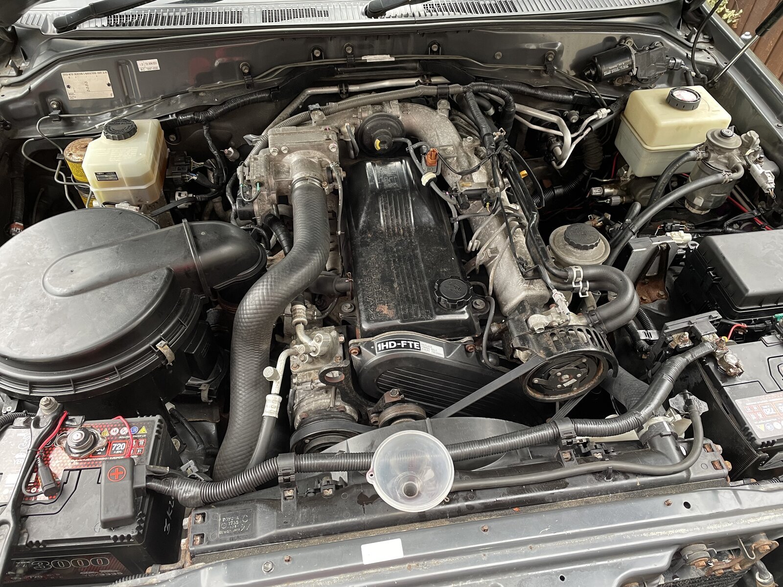

Hello, got a few big bits coming up that i am going to do.
Well big for myself will be first timing belt i have done on my own.
100 series Amazon 2005 1HD-FTE engine.
I have just been getting all the bits together ready.
so far ive got
Full service kit
Timing belt kit
Waterpump
Thermostat
New rad hoses and clips
Red coolant
Trying to source a new rad
new belts alternator and aircon
bits for diff oil change front and rear
Is there anything else anyone would recommend taking a look at while the above is been carried out?

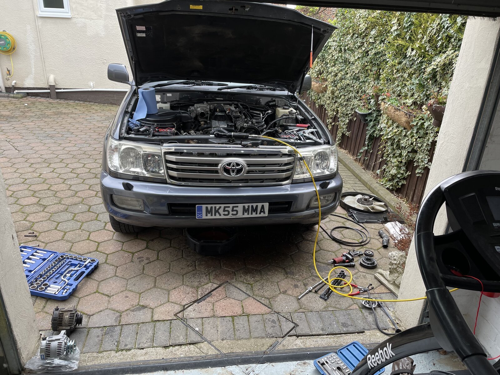

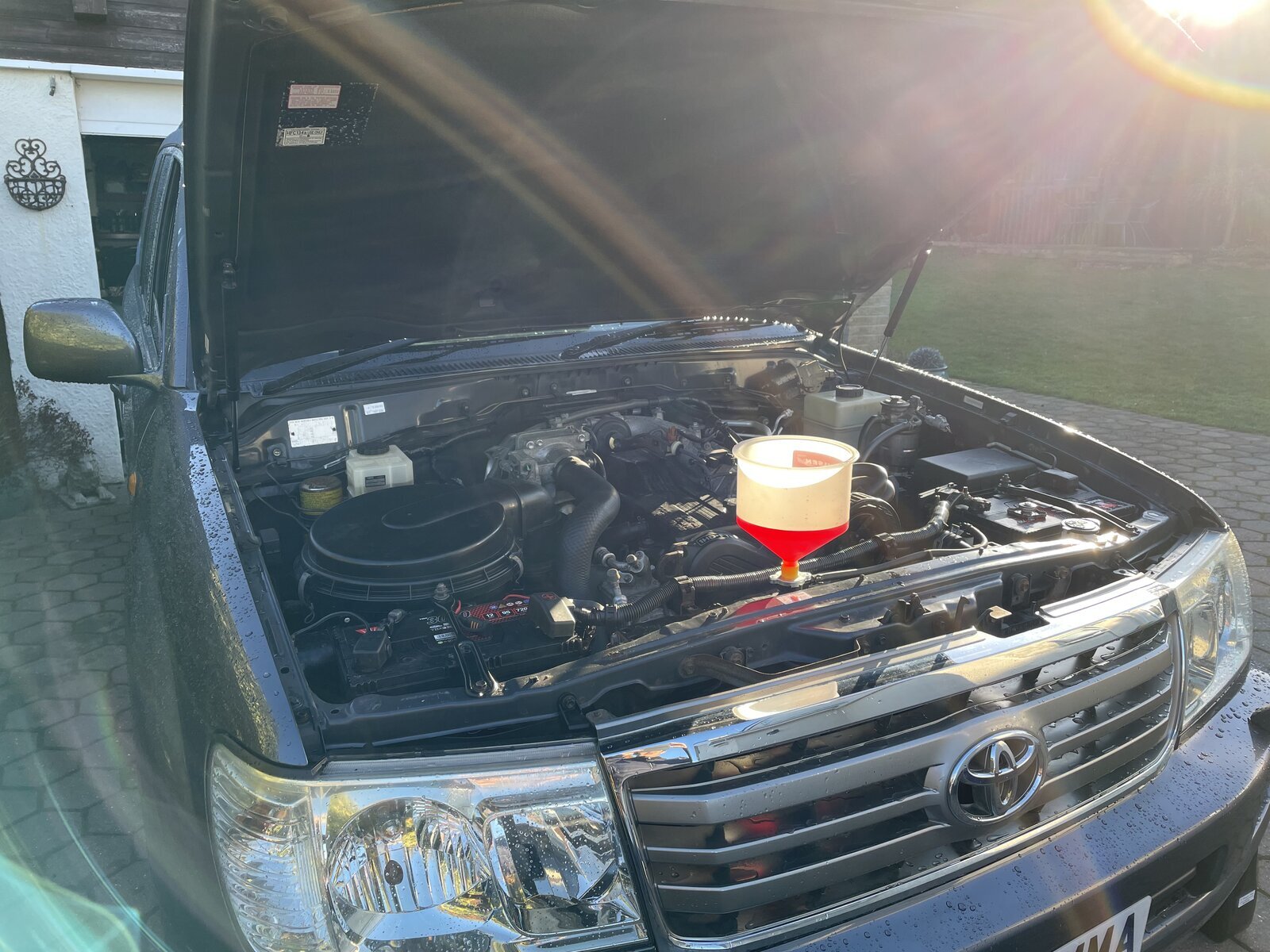

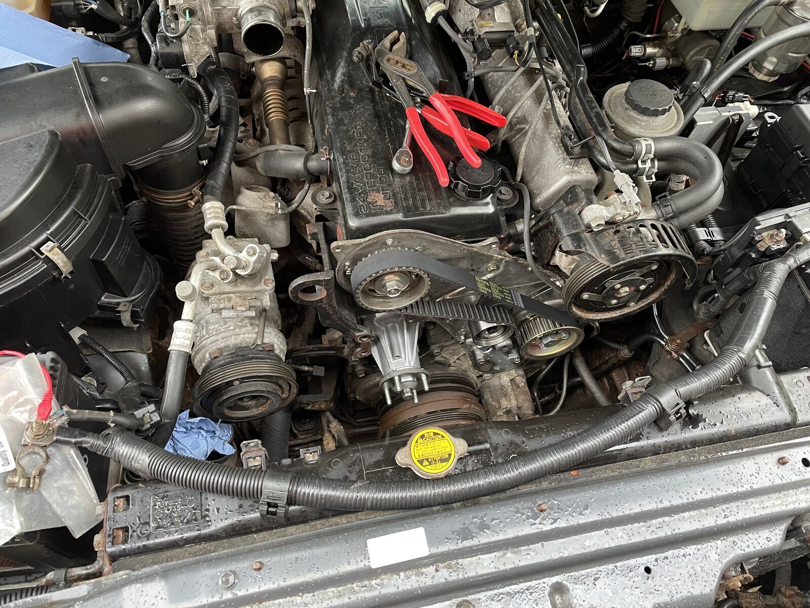

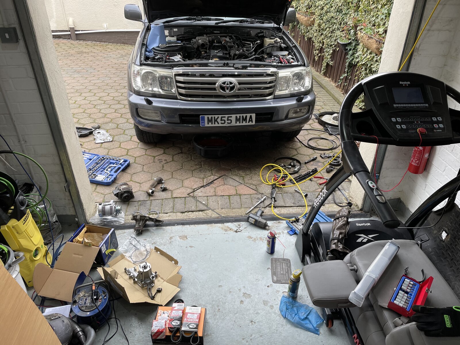

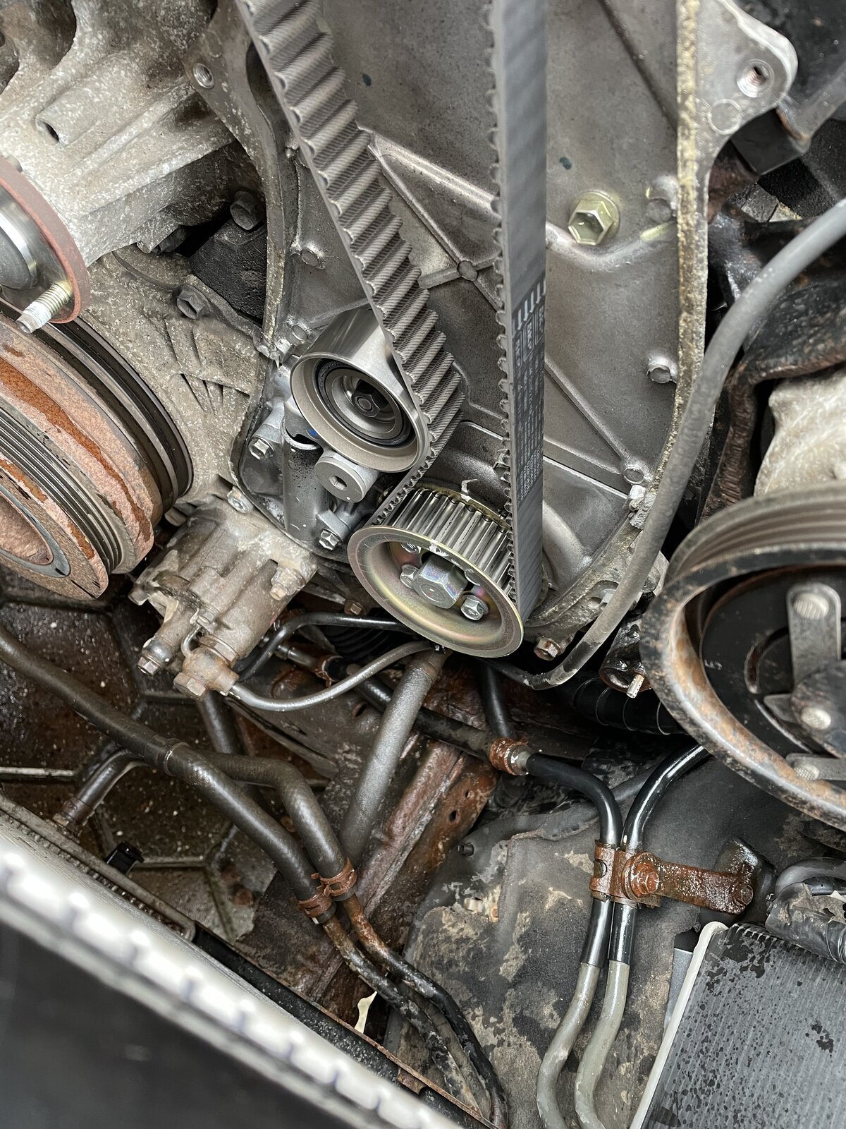

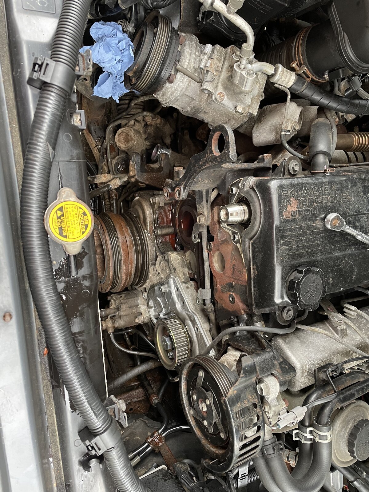

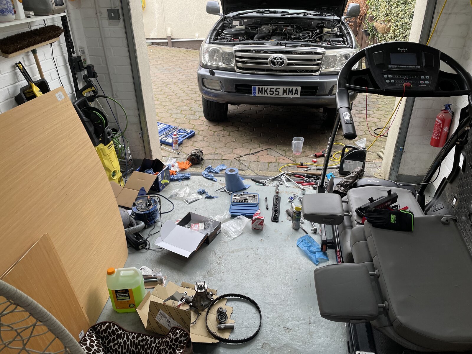

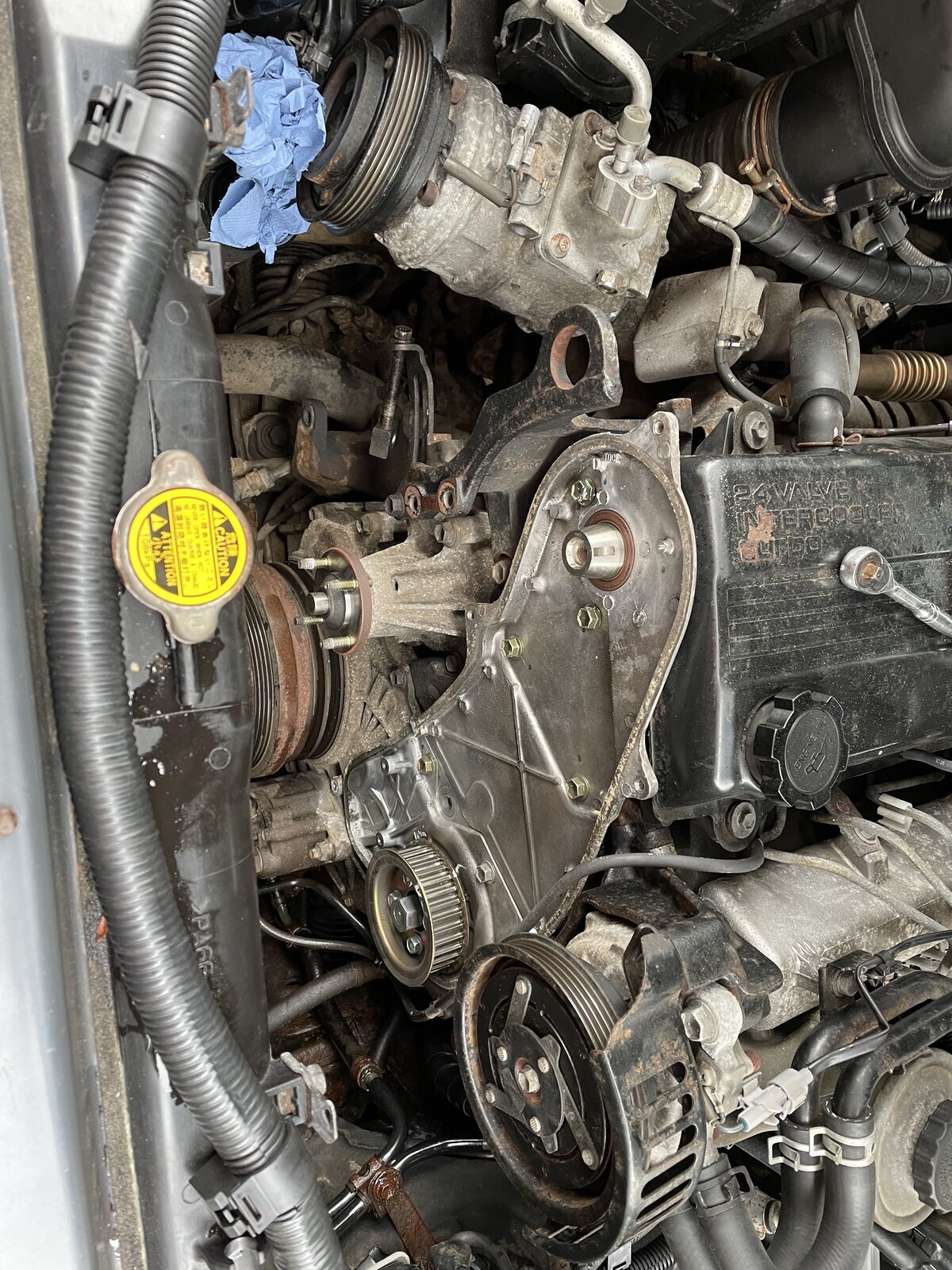

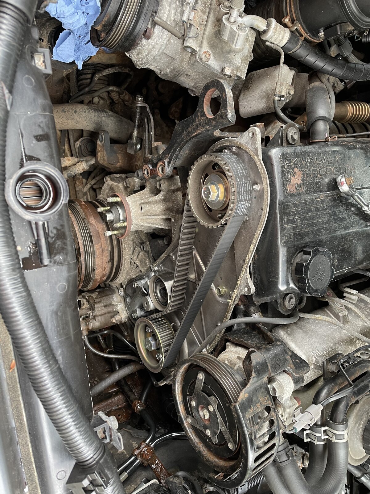

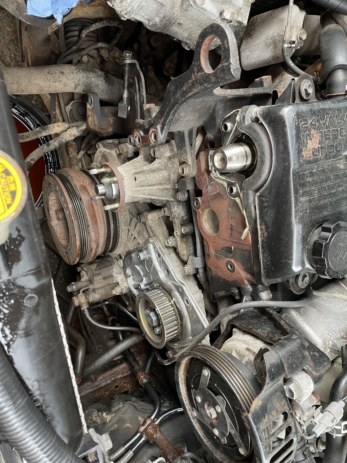

So I’ve had a pretty busy week.
What an amazing car the 100 series is to work on.
This is my first proper 4x4 and it’s brilliant how I can raise the suspension to high while working underneath.
So far I’ve done the big service oil and filters etc.
Only think I’ve missed is cabin filter I need to check about this if it has one and get one ordered.
Done the big jobs it just so happened the alternator failed so sort of sped up me doing it.
Cam belt, tensioner and idler pulley
Water pump cam seal and thermostat
New alternator and radiator hoses.
All new belts.
I was on a deadline from dropping kids of at school at 9 to having it back on the road by 3 and I just managed it.
I had tools everywhere I’m sure the mechanics will be disgusted at me lol.
First belt I’ve done on my own so was pretty happy turning the key and all was good.
Got the rear diff oil done and new plugs and washers, the fill plug was solid had to end up drilling and using an easy out with loads of heat, I have a feeling this had not been done for a long time, breather was rusted solid as well so popped a new breather on.
Transfer case was pretty good oil changed and new plugs and washers.
Got all the covers off from underneath they were solid had 2 snapped bolts, managed to get one out with heat and other had to drill and tap, I’ve re tapped all the holes and got some new bolts and washers.
Going to spend a bit of time cleaning up and painting the front bash guard.
Front diff oil done and new plugs and washers. These looked like they were going to cause trouble but once cleaned up they broke free with a bit of persuasion.
Pretty happy so far and feel a lot better knowing there all done.
I’ve just got the gearbox oil change to tackle but might have to wait till more funds available.
As mentioned above about valve clearances, I would like to have this on my to do list but might try get some assistance with this.
Roughtrax is brilliant makes it so easy for maintenance bits.
Got a few other little niggles to sort, one of the spotlights was in a bad way and back was missing so I’ve ordered a new pair.
Got the headlight washers to look at and get working and figure out how to fit the retaining clips, there just wobbling about at the min.
Getting there with a flashing seat belt light works every few try’s now.
I’m struggling with the rear screens and DVD player in the boot area, I may have to post a separate thread to try get some help with this.
Hoping to get the alloys done in April and fit some geolander GO15’s
Currently getting prices for a few bits of paintwork doing, think I’m going to go for a new upper tailgate and window seal so I know it’s good.

Forgot to say my main worry was that the belt had not been done, but on removing the cover I could see it has and fairly recent I would say, it looked in really good condition.
I had the new parts so have fitted them.
